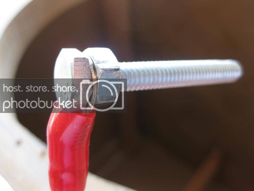

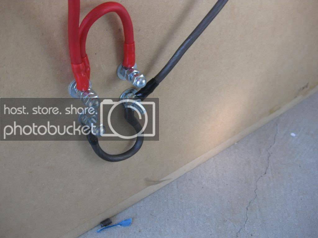

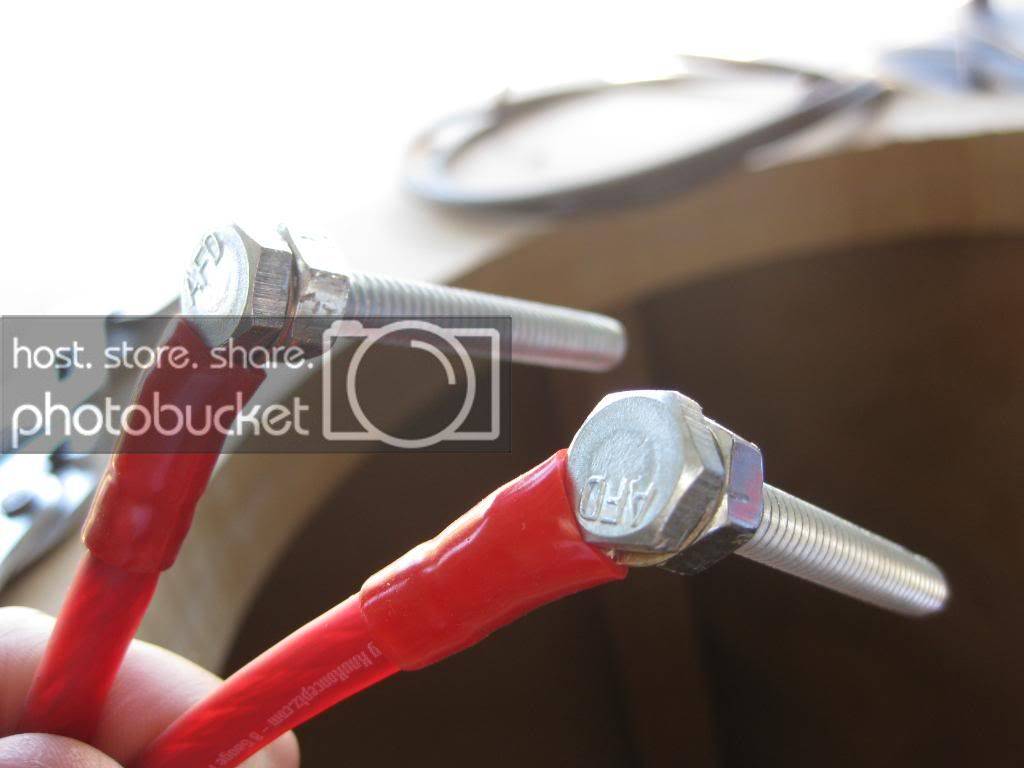

Just hit up home depot and take a ring terminal with you. Make sure you get the ones with the nut already attached on the other end or life will be a *****. then just cut it down with a grinder and put those little caps, or nuts on to fasten it down. Idk what they're made of. Not copper though. They're like 1$ per terminal IIRC.
some pics for you.. these were rushed but you get the idea.

LOL. you mean a bolt? bolts have these said "nuts" on the end. if they dont its called all thread. lol. They have different kinds at home depot mainly stainless and aluminum of which aluminum is more conductive. i think they also have some zinc bolts but not sure of the conductivity of zinc. most guys run aluminum. i do. Its close to copper. lots of people run aluminum buss bars.. it works.. just get washers and make sure all your ring terminals are in between washers...
