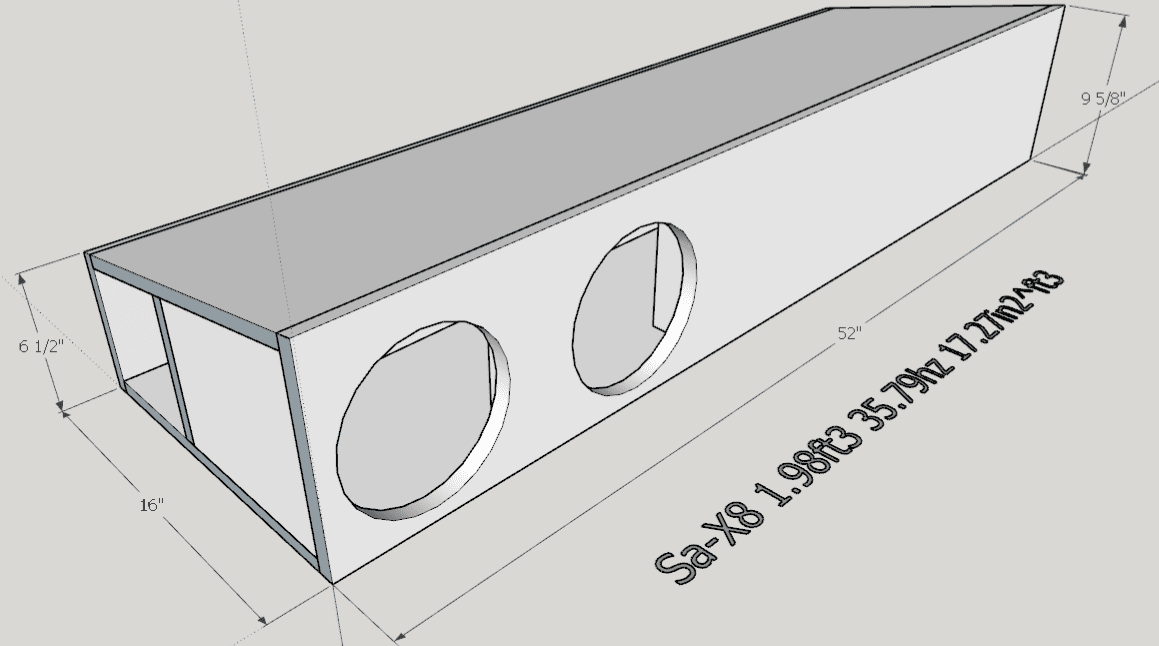

Ah... I see... well every build is different I guess. Most use a seatlift to fit a much better enclosure than a prefab under there... Like this...
