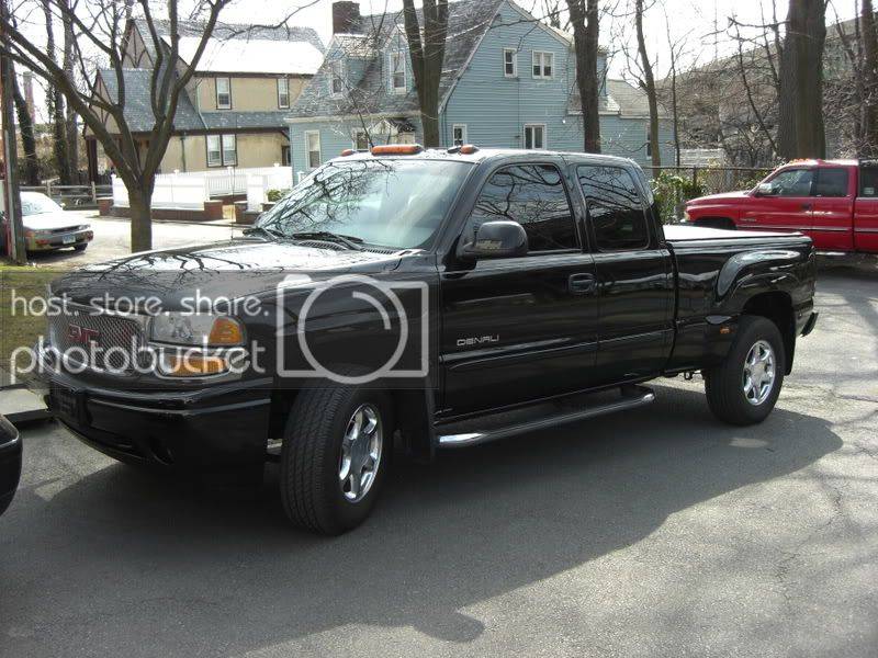

Should wang. Your builds are top notch.
Still not a fan of the lights on roof though. //content.invisioncic.com/y282845/emoticons/crap.gif.7f4dd41e3e9b23fbd170a1ee6f65cecc.gif
As always thanks for the nice words about my builds. I don't like the lights much either. I'm having them tinted soon.

The cab lights are certainly out of place on that truck, could maybe pick up a set of Recon smoked lights instead, or just clear ones. But tinted will certainly be a good start, and if ya get get rid of the amber should be golden.
not the pic.. do you seriously have snow already in ct?
i dont kno if by "not the pic" you meant you werent referring to that pic but i think that glo is from tha sun
i thought the same thing but didnt see any snow anywhere else:D
even though i dont live there i still kno its a little early for snow
haha
Thanks man. Yeah still gonna put the ginormous screen in the back. I have my taillights tinted already going to have them do cab lights, 3rd brake light, headlights, parking lights and fender marker lights.
i dont kno if by "not the pic" you meant you werent referring to that pic but i think that glo is from tha suni thought the same thing but didnt see any snow anywhere else:D
haha
Picture was taken in March when I bought the truck... Its been getting chilly at night here but nowhere near cold enough to snow yet thank god
