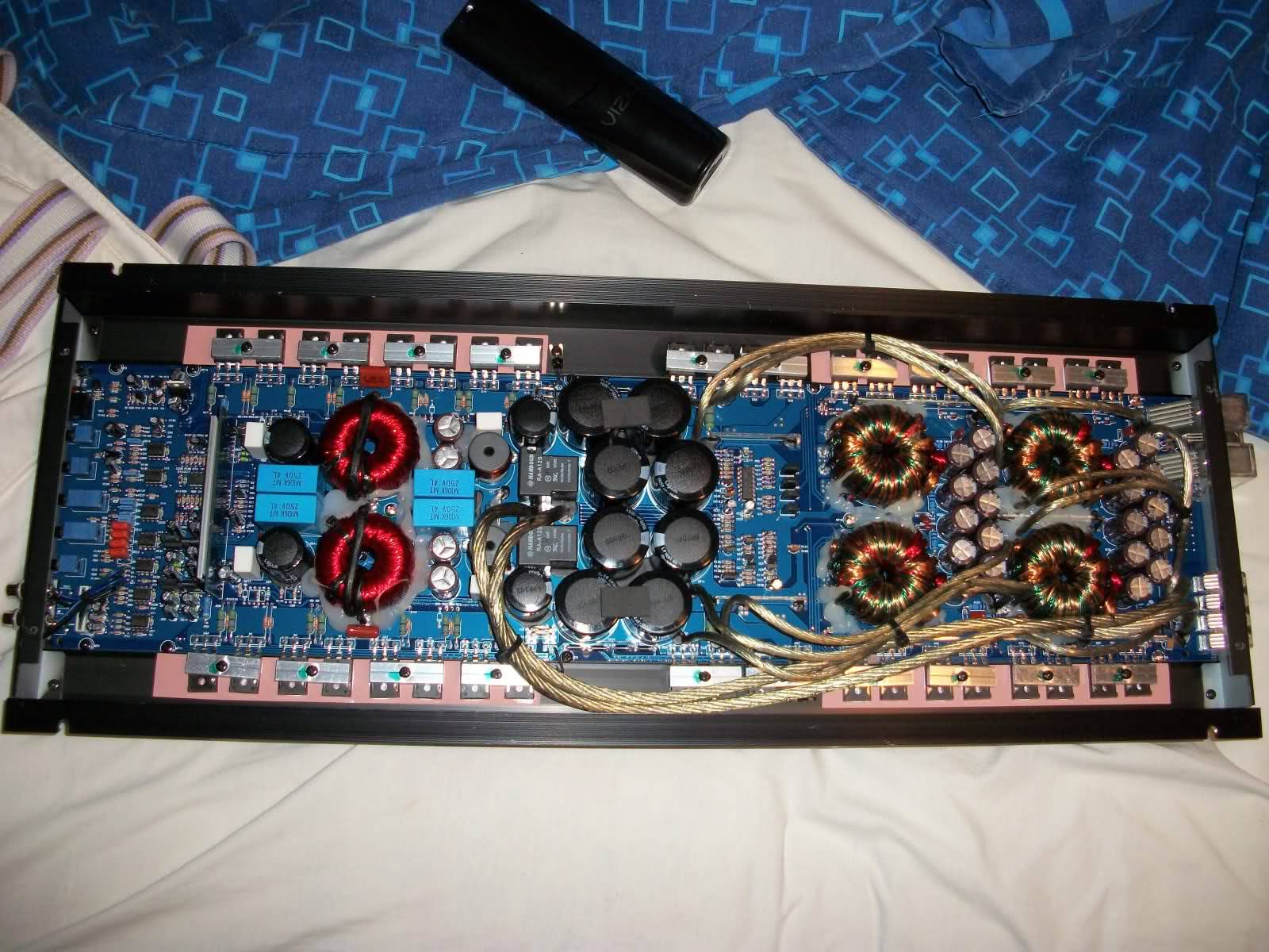

For a quick comparison, here are the guts of his amp 5.5KW
And here are the guts from an under rated 1.5KW
he can probably get 2k out of it
