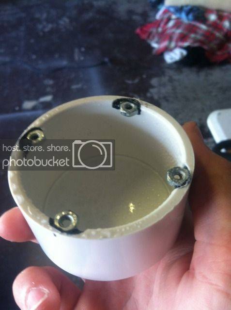

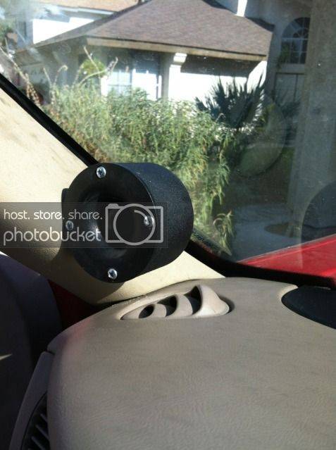

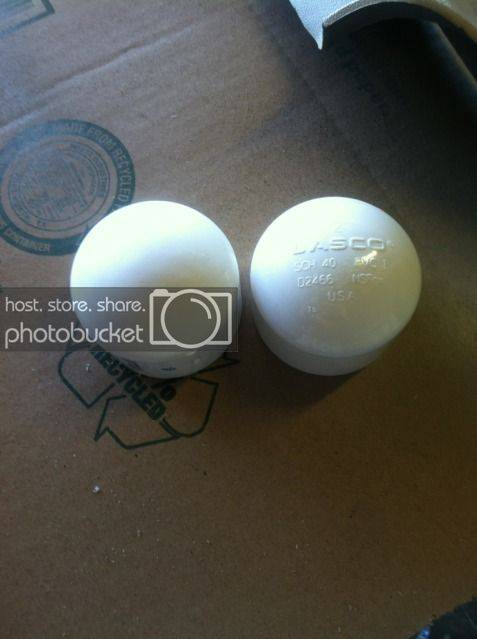

Build Plans: I plan on Glassing the pods into my HORRID plastic door pannels. Ford really screwed up on the panel design IMO. Tweeters will be in the A-pillars in PVC Pods. Credit to the $2 tweeter pod thread! Back seat of the truck will be gone. Complete covered by subwoofer enclosure and amp rack. Enclosure Currently designed @ .62ft^3 PER DRIVER for the four 8's. Im probably missing something here but this should be a fun little install.

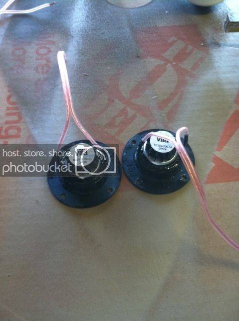

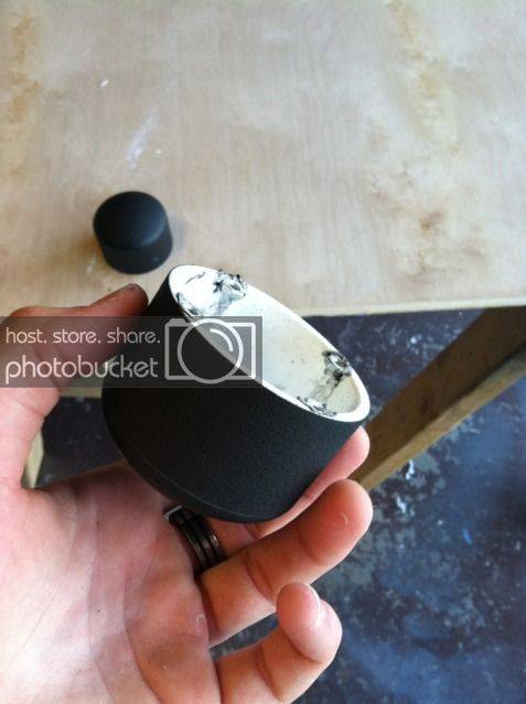

Onto the tweeter pods which i did about a year ago :p

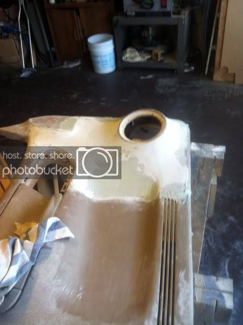

rough cuts. I need some structure to reduce warp and i can get all areas for glassing from the back with these holes cut
symetrical somewhat baha!

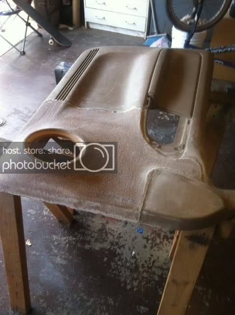

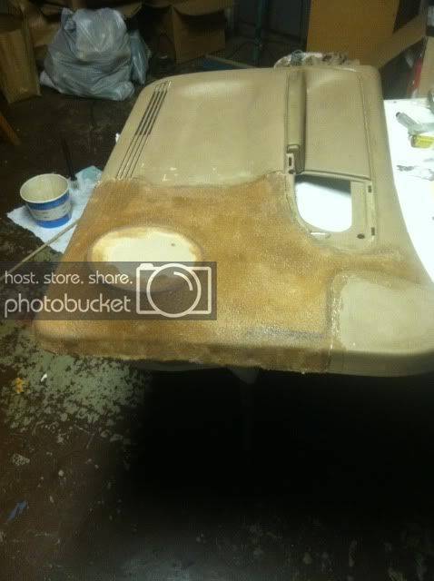

doors done for glassing now the finish work. yay :/
After work today I decided to build the 6.5's They are fresh and brand spanking new
Have i said enough how much i hate finish work? BUT its a must to take your time and be patient and go over with filler as many times as need be to make it perfect!
First off i went through on each panel and sanded the edges down to make it a easier transition with the filler. I also sanded the outside fleece. all with 40 grit then 60 grit.
somewhat still green in some areas

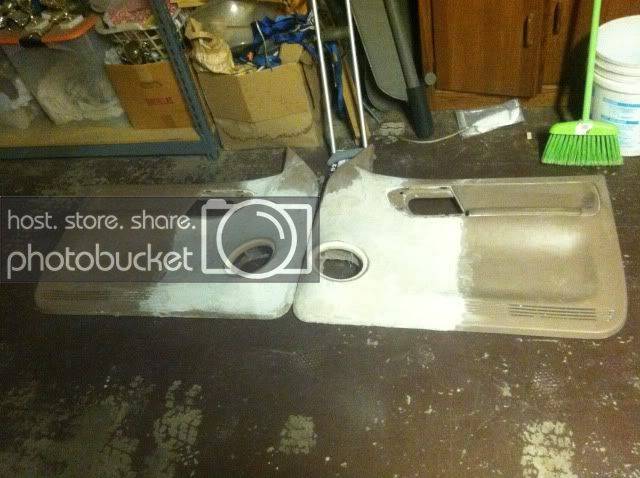

finished drivers side ready for vinyl. All edges nice and smooth. finish sanded with 80grit as i will be vinyl wrapping them and I like to have some rough surface for spray adhesion.
driver and passenger done

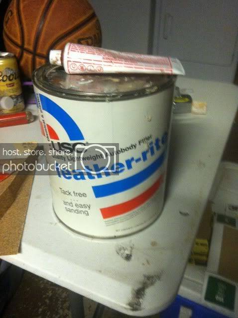

the filler that i use on every project. not to expensive and sands oh so smooth!
The filler tools that i use //content.invisioncic.com/y282845/emoticons/smile.gif.1ebc41e1811405b213edfc4622c41e27.gif they are 1.99 at lowes/home depot. can be cut into any size/shape you want. I find the larger one works best even on the small areas! its cheaper than the bondo tool and if you break/mispalce them its not a $10 replacement //content.invisioncic.com/y282845/emoticons/thumbsup.gif.3287b36ca96645a13a43aff531f37f02.gif

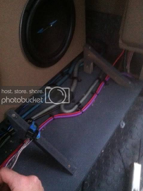

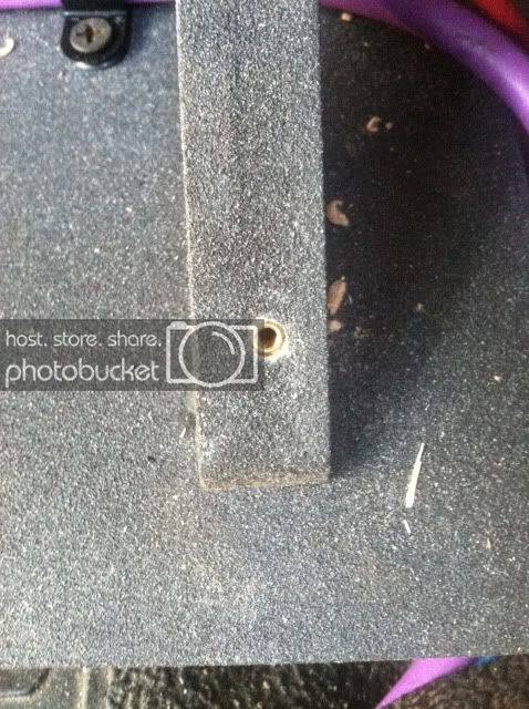

Amp mounting holes. Went with threaded inserts so i can use security Bolts
wiring all tidy
door view
still have a bit of cleaning up to do.
