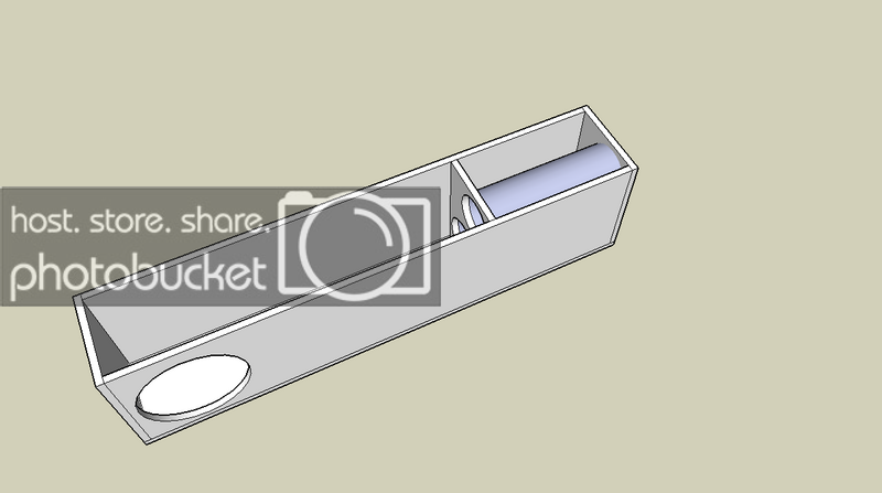

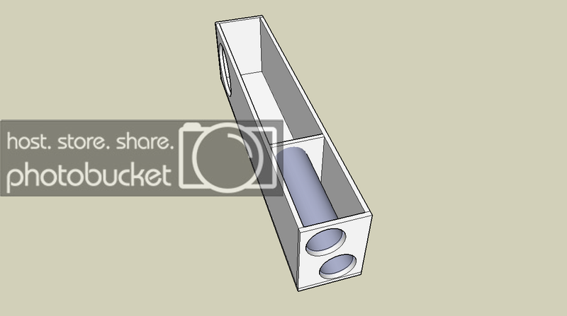

Got the box ironed out last night for the BTL. Thanks to TommyK and Jntar (they had the same idea). New box will be 2.68 @ 34.3Hz. Has external Aeros...but you would never know it //content.invisioncic.com/y282845/emoticons/up2something.gif.dd110ecf3ae4b76050d87598f2f8de7c.gif . And for the SPL guys, thinking im trying to make this look pretty...Im not really, If you saw how behind my seats looked, you would understand that if I took off the wood part covering the aeros, the box wouldnt sit right.
Much Better.
Yeah that should fix the unloading problem...I wish I could take a picture of the old box, that way everyone could see what I did //content.invisioncic.com/y282845/emoticons/crap.gif.7f4dd41e3e9b23fbd170a1ee6f65cecc.gif We played with that BTL for a whole weekend, but we never "Looked into the box" to see that those aeros cut off half of the box.
we looked in the box plenty of times. we looked right at the end TRYING to get both ports to fit. Makes perfect sense now.//content.invisioncic.com/y282845/emoticons/crap.gif.7f4dd41e3e9b23fbd170a1ee6f65cecc.gif
