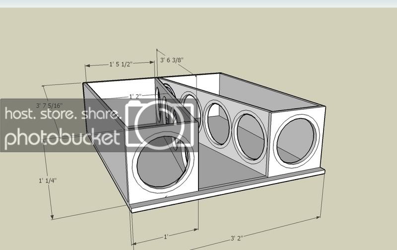

first time with sketchup- results
looks better. try doubling the wall thickness with the last 2, itll increase the clearance by 1.5"
you may have basket/magnet clearance issues in the rear with the angle, also how are you installing the subs, screw em down first then mount the board into the box? all in all looks good just minor stuff to refine. sketchup works pretty nice dunit?
edit: at least the bottom will be easy to make, just cut a full sheet in half
that looks good.Or you could take out the 2 front ones and widen the tunnel a bit.You would lose those 2 speakers but 8 should be **** loud.Just a suggestion.
well originally i was going to do 16 10"s, and that number is all the way down to 10 or possibly 8, so i think i'm going to scrap this project and pick up some beefier 10's like cvx's or somethin and do 4 of em, and when i get more money down the line double it to 8 ported hopefully.
Is this actually a design, or did you just draw this up?
//content.invisioncic.com/y282845/emoticons/confused.gif.e820e0216602db4765798ac39d28caa9.gif it is all to scale, it would fit in the bed of my truck. all of the cutouts and OD's are the exact size of the subs i'd be using, so idk what youre asking. it is a design and i did draw it up?
What he's asking is did you design it to any particular specifications for airspace and these particular subs, or did you just throw it together in Sketchup?
5 speakers, in 4 cubes so .75 cubes per speaker. yes, i did.
same for the other side, thats just what the specs called for
Enclosure Recommendations:
0.5 ft^3 - 0.75 ft^3 sealed
http://www.sundownaudio.com/ppsd10.html
edit: actually i did not check the specs of the second design i made.

Could we get the dimensions to check your work, because I just have this gut feeling that it isn't accurate. //content.invisioncic.com/y282845/emoticons/crap.gif.7f4dd41e3e9b23fbd170a1ee6f65cecc.gif
Precisamente.Could we get the dimensions to check your work, because I just have this gut feeling that it isn't accurate. //content.invisioncic.com/y282845/emoticons/crap.gif.7f4dd41e3e9b23fbd170a1ee6f65cecc.gif
14x41x12
thats the internal dims of both chambers, i didnt account for the little angle because i figured driver displacement would kind of cancel out.
//content.invisioncic.com/y282845/emoticons/rolleyes.gif.c1fef805e9d1464d377451cd5bc18bfb.gif i think i can multiply three numbers together and divide them by 1728

i thought i had read that, thanks for that info. those 10's are gone anyway, but i think i'd rather just run 4-8 quality 10's ported with the space i have.
btw, the second design was 4.25 cubes per chamber, making each speaker see .85 cubes. after driver displacement of around .05 i'd guess (couldnt find any specs) it'd put it in just a tad larger box then recommended.
dims if anybody is interested
