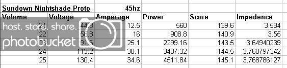

Well guys yesterday was my last day to test before my truck left to go to it's new home. I had big plans of spending most of the day testing; however, that wasn't in the cards. To begin the day my charger had screwed up sometime in the past few days leaving my batteries partially drained. I apologize in advance for the inadequacy of these results, but from my limited testing I learned quite a bit about this driver.
These numbers probably don't mean much to you so let me do some comparision for you. In that same enclosure in the same test vehicle at the same power, note this was on a much colder day, the Nightshade is about .4-.5db louder than the IA DP and at 20hz lower. However the DP really shined when more power was added, as I expect the same thing would happen with the Sundown Nightshade. I hope to get some more testing done on this driver in the coming week if I can locate adequate power to support it.
Edit Also forgot to add one of the most important parts. When I first spoke with Jake about testing this driver he wanted to see a good rms figure and I came to the conclusion that a prolonged period on ~3-4kw would give a good estimate of how much power the coil could soak up and what the cooling would do. I threw 3.5kw on the driver for ~30 seconds @45hz and got a small amount of smell out of the driver ( nothing more than excess glue burn off ) and the dustcap was barely warm to the touch. Also testing the spl before and after that period yielded minimal difference, maybe .1-.2db. For that reason alone I think the driver could take 5-6kw for a burp without worry.

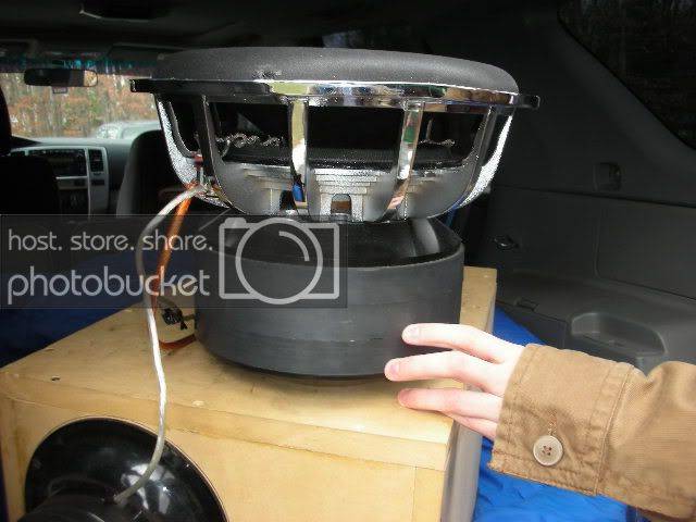

It has the good parts of both woven leads and standard leads
they are tied down so no lead slap issues/wear on the leads +they arent completely woven so they dont get fatigued with the spider....
