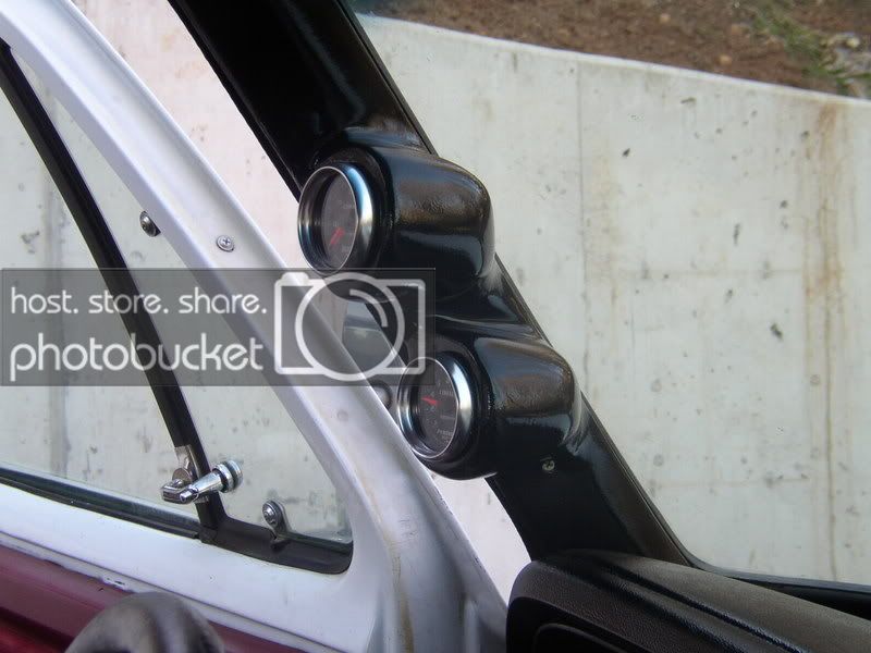

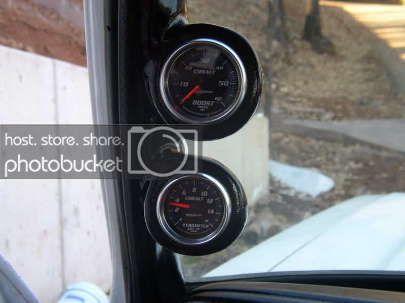

even though its not car audio i thought it was worthy of putting up. these are pods for gauges in my truck...
Not bad my man, not bad at all. This picture worries me a little though. Looks like you have some warpage. Or is the a pillar curved like that ? //content.invisioncic.com/y282845/emoticons/smile.gif.1ebc41e1811405b213edfc4622c41e27.gif
aight cool. Did you wrap the entire pillar in glass? You don't really need to for just making pods like you made //content.invisioncic.com/y282845/emoticons/smile.gif.1ebc41e1811405b213edfc4622c41e27.gif

Anyway, OP, nice work on the pods. Would never guess it was your first time. It really isnt that difficult if you know the techniques and stuff though. Patience is your friend when working with glass/fillers. //content.invisioncic.com/y282845/emoticons/biggrin.gif.d71a5d36fcbab170f2364c9f2e3946cb.gif
Paint looks a little rough but other then that nice job for your first.Now that you know how to do it you'll be creating all kinds of stuff:)
i was wondering if someone was gunna notice that. actually i wanted that, i sprayed some chip gaurd on before, i wanted to get some texture because the pillar is textured. didnt want a rough pillar and smooth pods //content.invisioncic.com/y282845/emoticons/smile.gif.1ebc41e1811405b213edfc4622c41e27.gif
