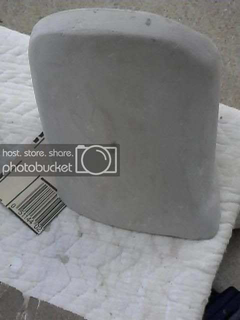

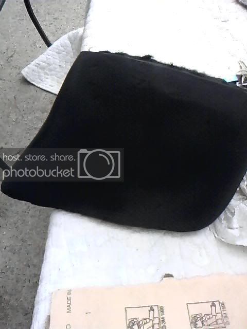

I was tired of all the buzzes and rattles of my doors even after deadening. So I decided to try my hand at a pair of kick pods for my mids. This was my first time using fiberglass so I was a bit skeptical.
Sorry for the crappy pics (cell phone).
Kick panel molding removed and taped out

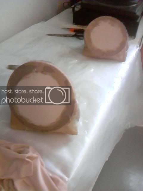

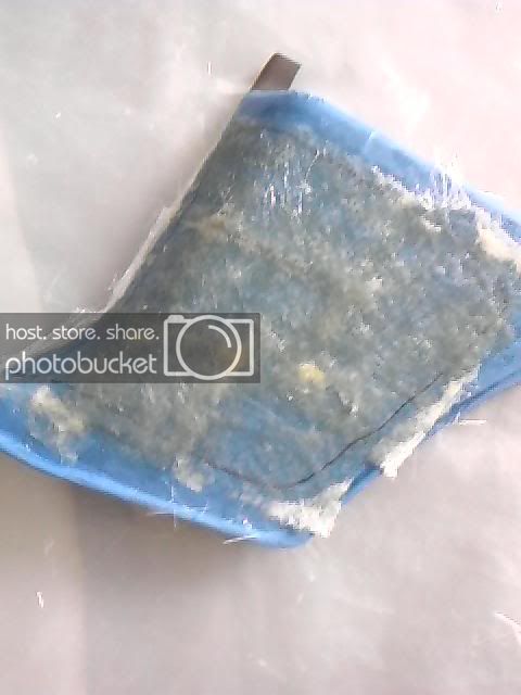

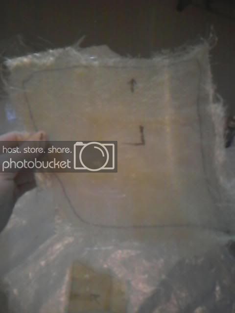

First layer of glass/resin applied

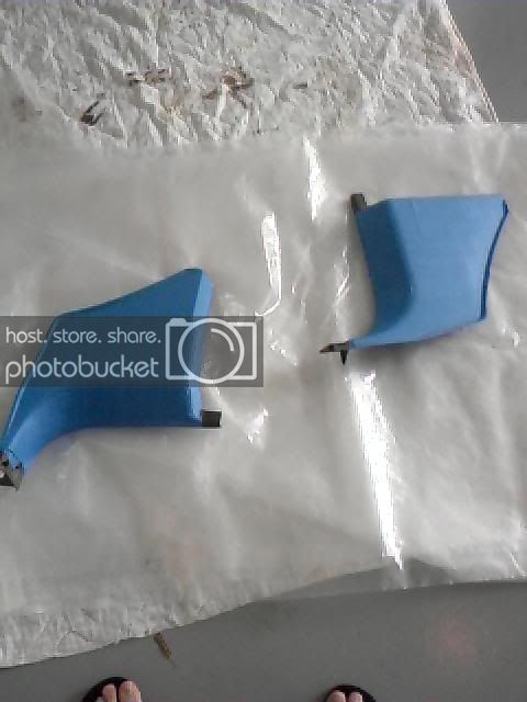

Finished mold

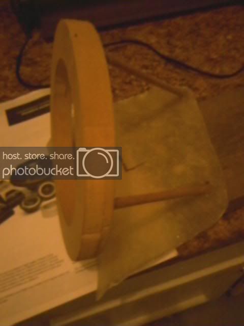

Speaker ring attached
Ring covered and resined. This material was a thin slightly stretchy synthetic that I hoped would work well. Unfortunately the material didnt stretch too well in all directions, which led to some problems later on.

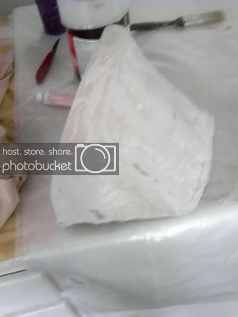

Some Bondo action
More body filler/sanding
Primer time
Mounted
The pods were not completely smooth by any means, but they are good enough for me. The location that they are in doesn't warrant such attention to detail.

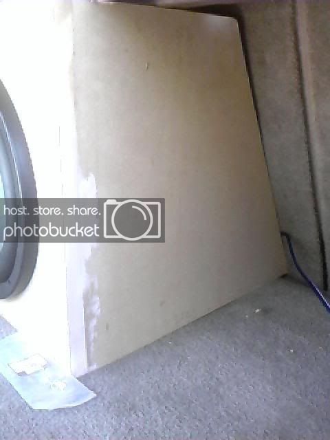

I had some extra time so I decided to build a box for my Eclipse Alum. I was tired of having 8 cubic ft. boxes taking up my whole back hatch, so I decided to downsize.

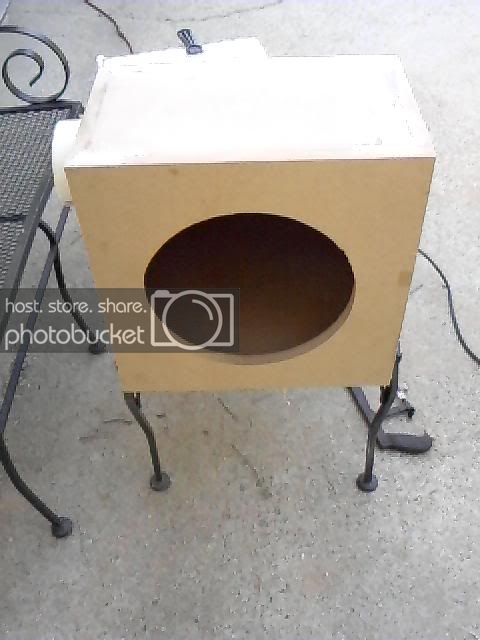

I decided to go with 1.5 cubes @ 28hz. Using an external port.

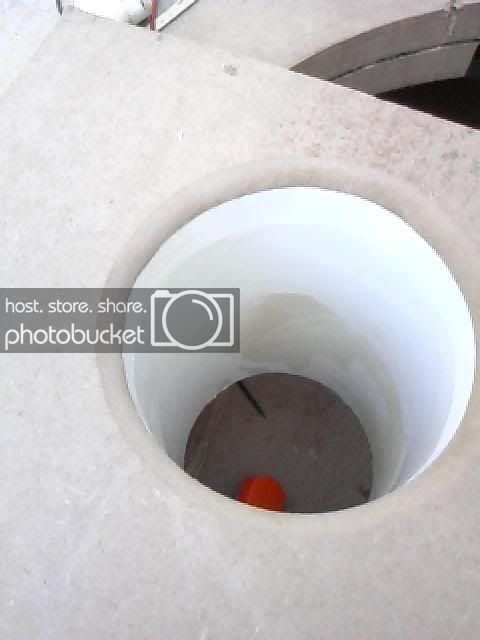

The routered out port flare on the inside of the box.

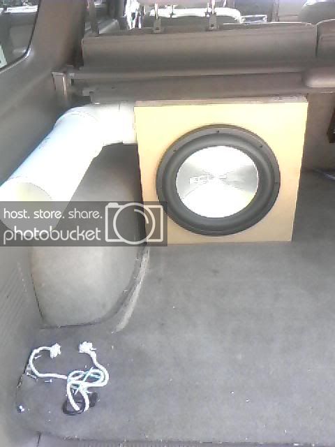

Box done.
Fits snuggly
Port attached.
I will probly paint/cover the box later on, but for now I'm happy just to have my trunk back.
