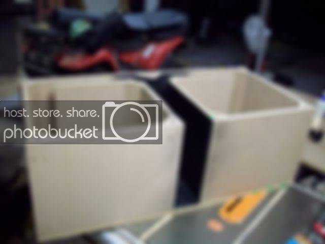

Finished Dual 10" Ported box PICS. Help me pick out subs
I'm referring to boxes with the ports in the middle only...when they're off to one side then it's only a port width away from the back.
hrmmm well hopefully it doesnt cause horrible port noise or anything...been trying to google it but cant find out the reasoning behind this...heres my cat
not a bad job on the actual construction.

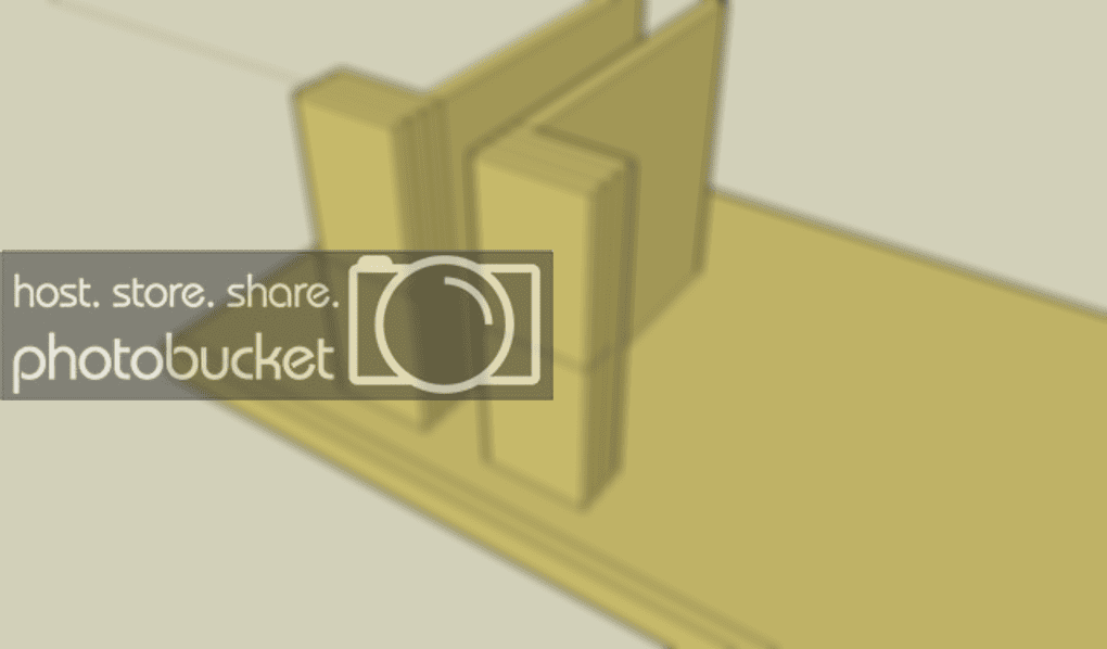

but like the others said. that is not the correct port width for the start of the vent per chamber.
this is what i would do.
the port is 13" high. so on each side take 4 blocks of 3/4" mdf PER SIDE. that are 6.5" tall by the width of the pieces already there then glue and screw. that would make the two port beginings the correct width.
next time it should look like this.

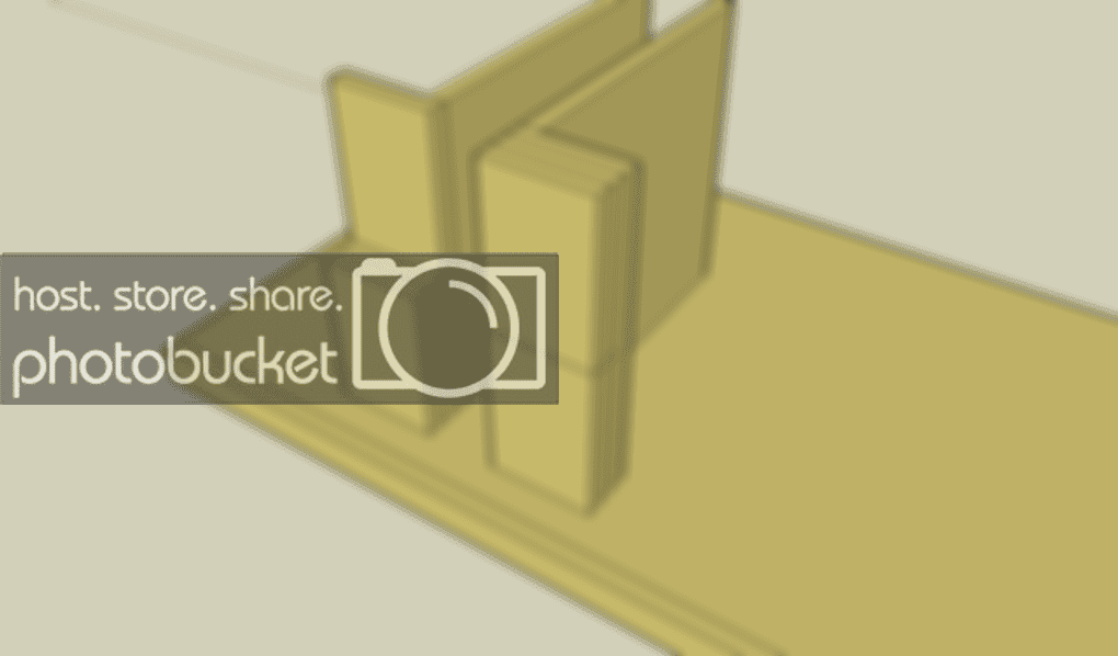

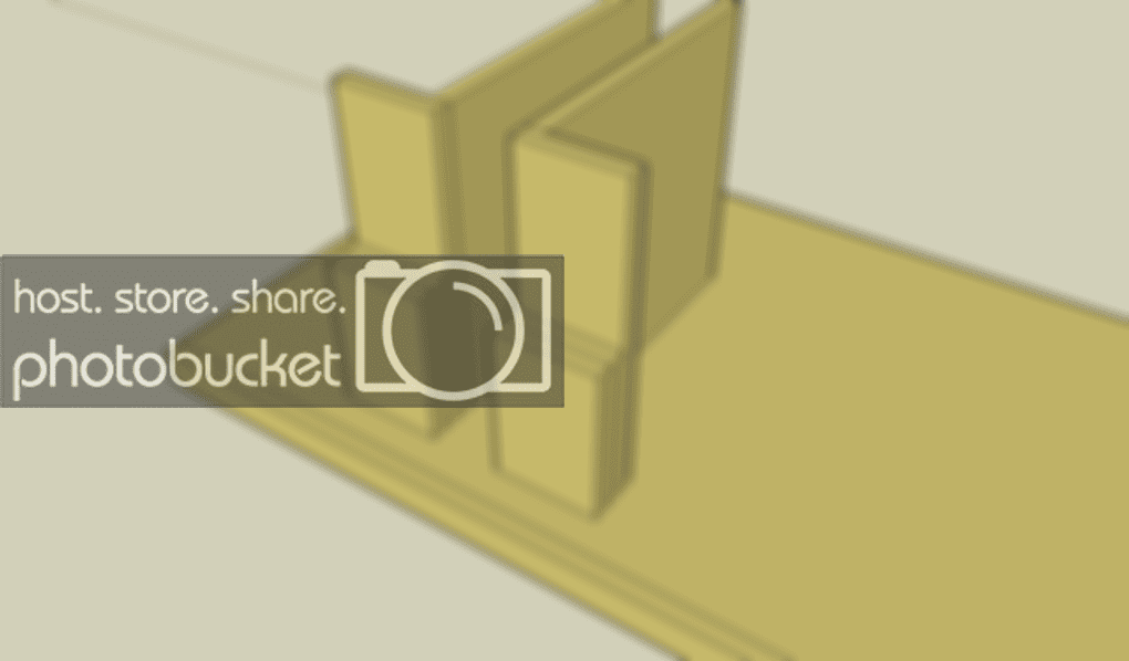

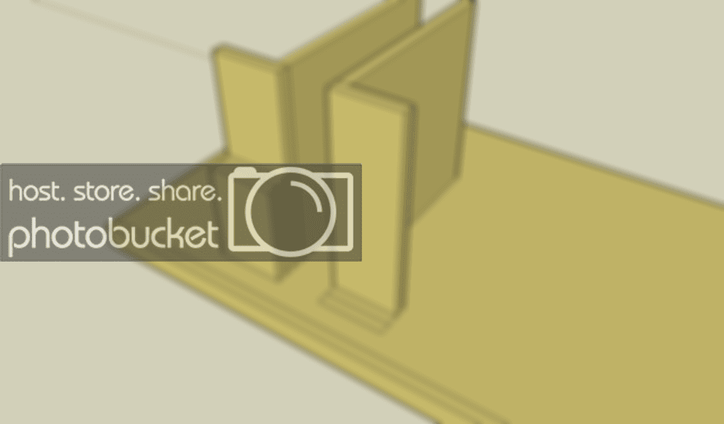

in order of assembly.
and the 45's were cut with a table saw. although some circular caws have the same capability.
