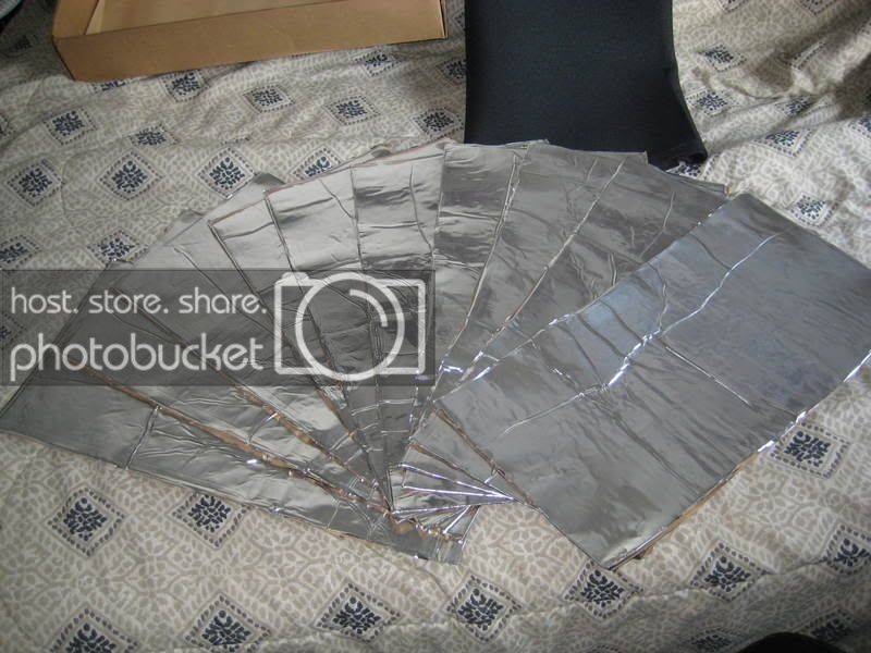

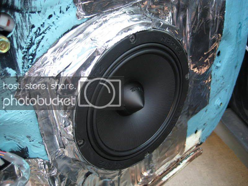

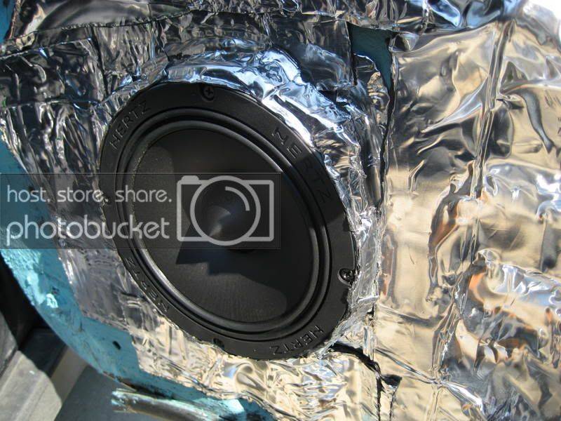

I finally got around to spending some money on some Damplifier and Overkill. '00 accord sdn.

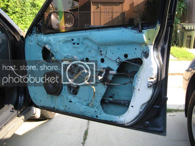

Update: did drivers door yesterday
Driver side

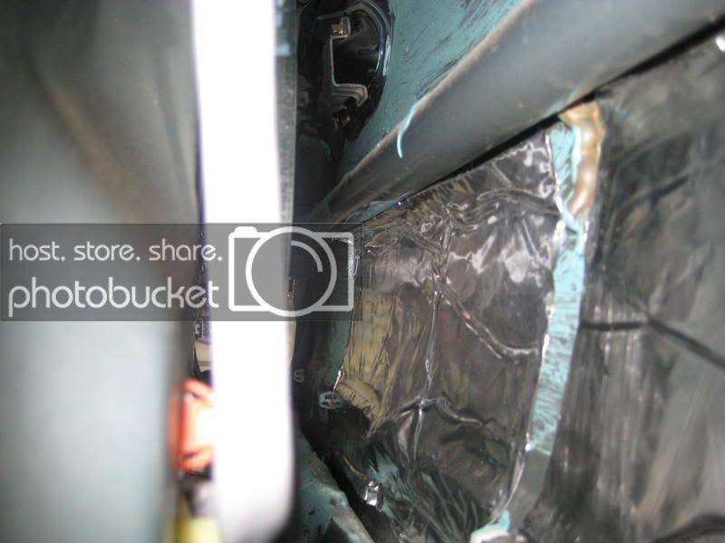

Its hard to get your hand in here

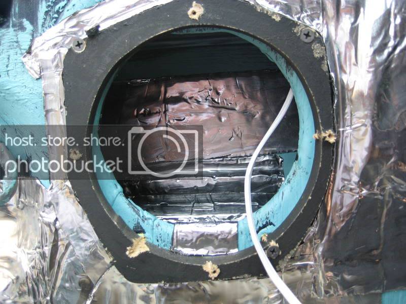

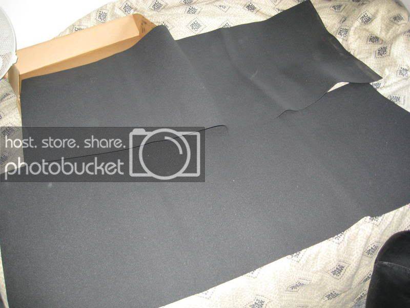

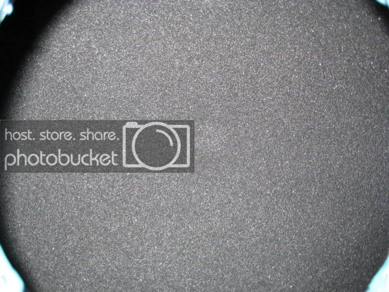

Overkill
Sealed up mid

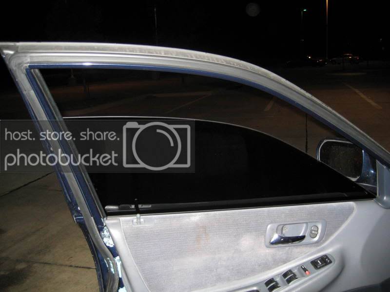

just for giggles to show 5% at night, notice how it reverses at night when more light is on 1 side.

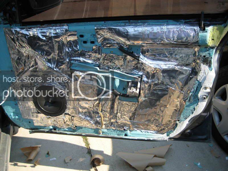

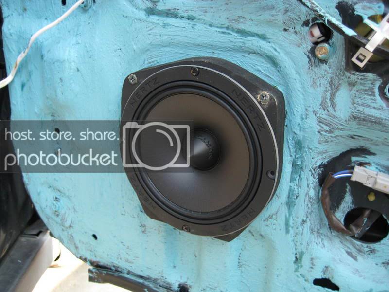

Today did Passenger
Dont even ask about the body filler, its a long ghey story.

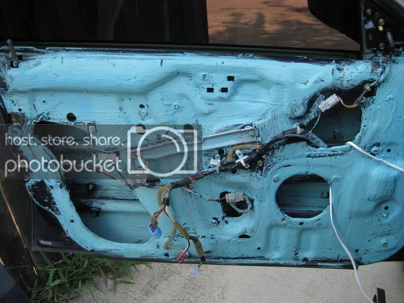

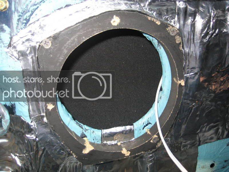

before, wasnt mounted very well lol
Now
Keeo in mind i havent put Overkill between door panel and door yet, ran out of adhesive spray doing the inside panel.

response was strong. deadening makes a big difference

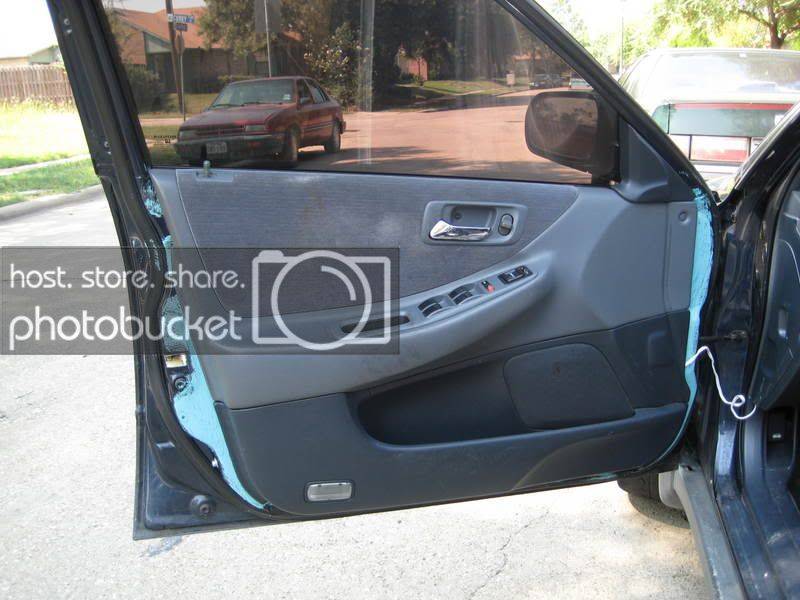

glad to know it made a difference. but are you going to clean it off around the door panel?
thats a long story man, i did that 1 year ago, i was a retard, i didnt realise the doorpanel didnt go that far on the doors. i tried scraping it off last night while doing driver side, but its going to take time.
so overkill is the blue stuff? how is that? you just paint it on?
also the black thing your speakers are mounted on, did that come with the door, or is that just a mdf spacer thing?
overkil is the foam
damplifier is the mat
the blue is eDuh v3
those are MDF baffles I got from Ray he threw em in for me when i bought the Hertz.
so you use the mat on everything, then use the foam ontop of the mat on the inside of the door?
there is foam inside the door between speaker and panel, and i ran out of adhesive so i have to buy some more to use for the door panel and door to do more overkill. the mat was on everything, for the most part atleast.
So that explain why its like that in the trunk too Mir? That stinks. Tried some acetone or some sort, to get it off? You need to fix the screen or put the h-u in there right or something.
yep, trunk too. fun times, NOT. //content.invisioncic.com/y282845/emoticons/frown.gif.a3531fa0534503350665a1e957861287.gif
yeah bout the lcd, I have a new dash that came in this week, im waiting on a friend to hook me up with a dash kit for the car from bestbuy(discount). So i am going to out HU back to "stock" location until i order new lcd.
try some brake cleaner. careful around the paint.
i'll try it, thank you
