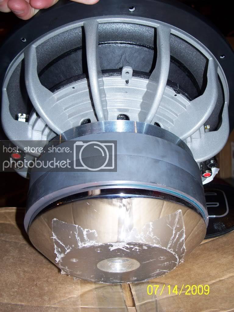

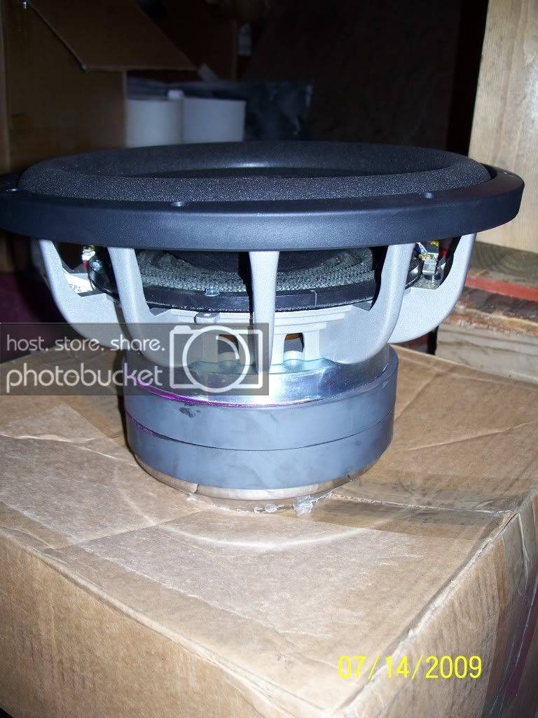

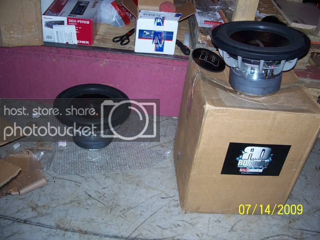

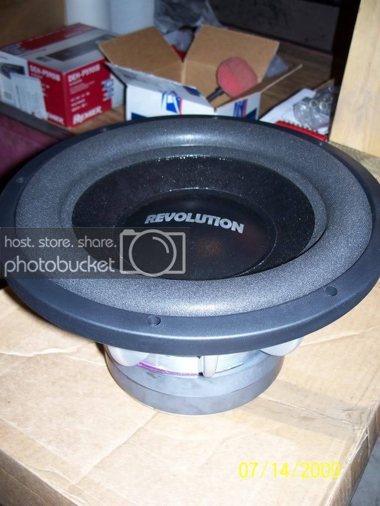

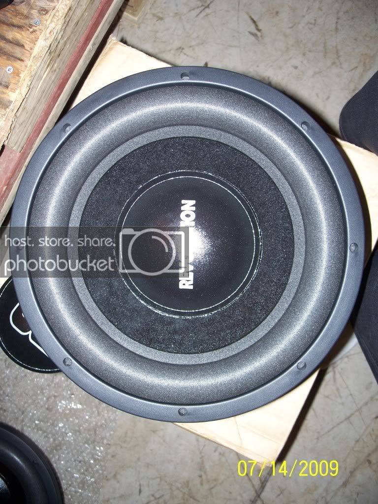

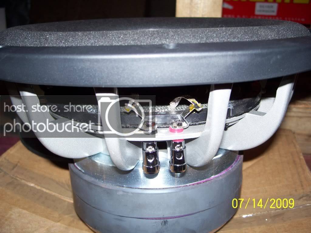

This time im putting 2 12" RD alpha v2's in. There d2's 8 layer flat winds, read 2.8-2.7 (not sure why), hw cones and surrounds, old dust caps i may switch them but idk how to get the old ones off.

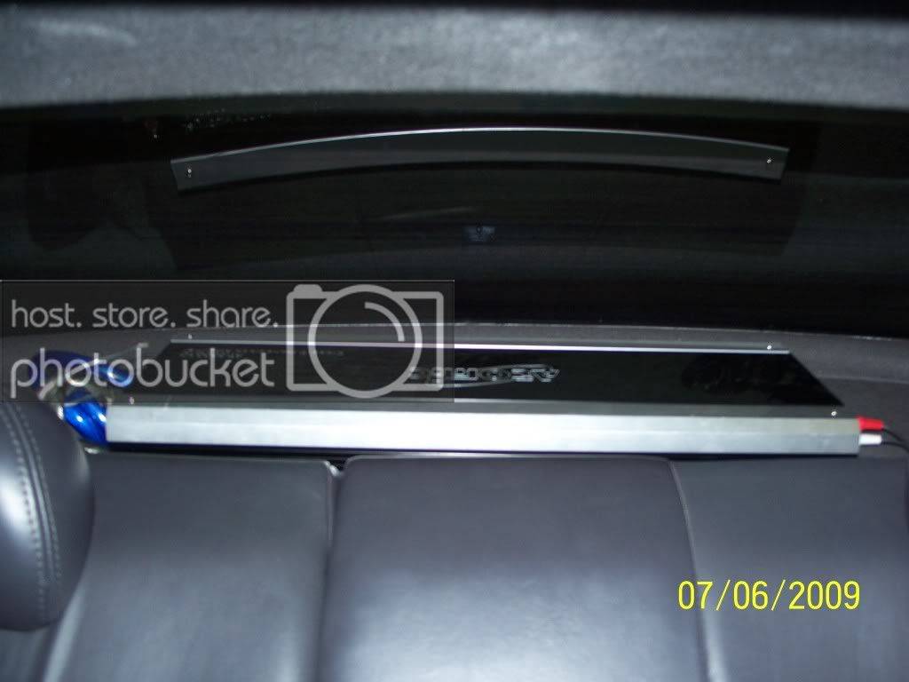

Amp is atomic 3000.1d wired to .5 ohm
amp on rear shelf

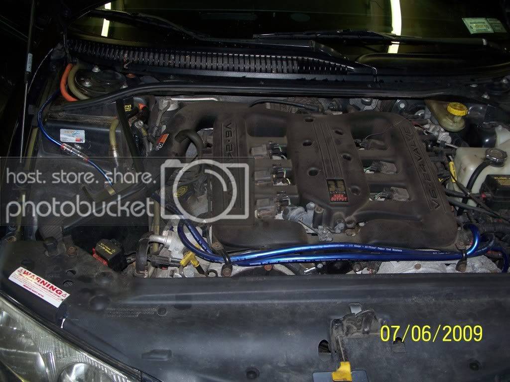

corssovers for mm6 fronts, Digital fuse for alt (+) to batts in trunk, Amp for fronts Soundmagus CP91

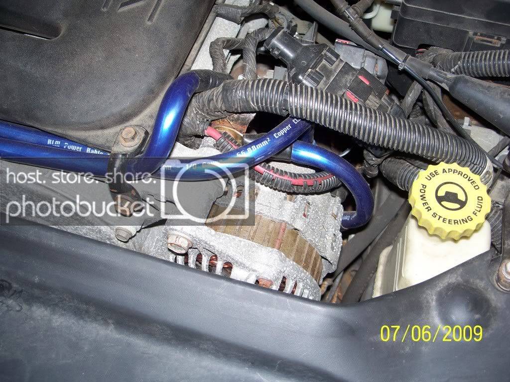

200 amp MRC alt. lifetime warranty

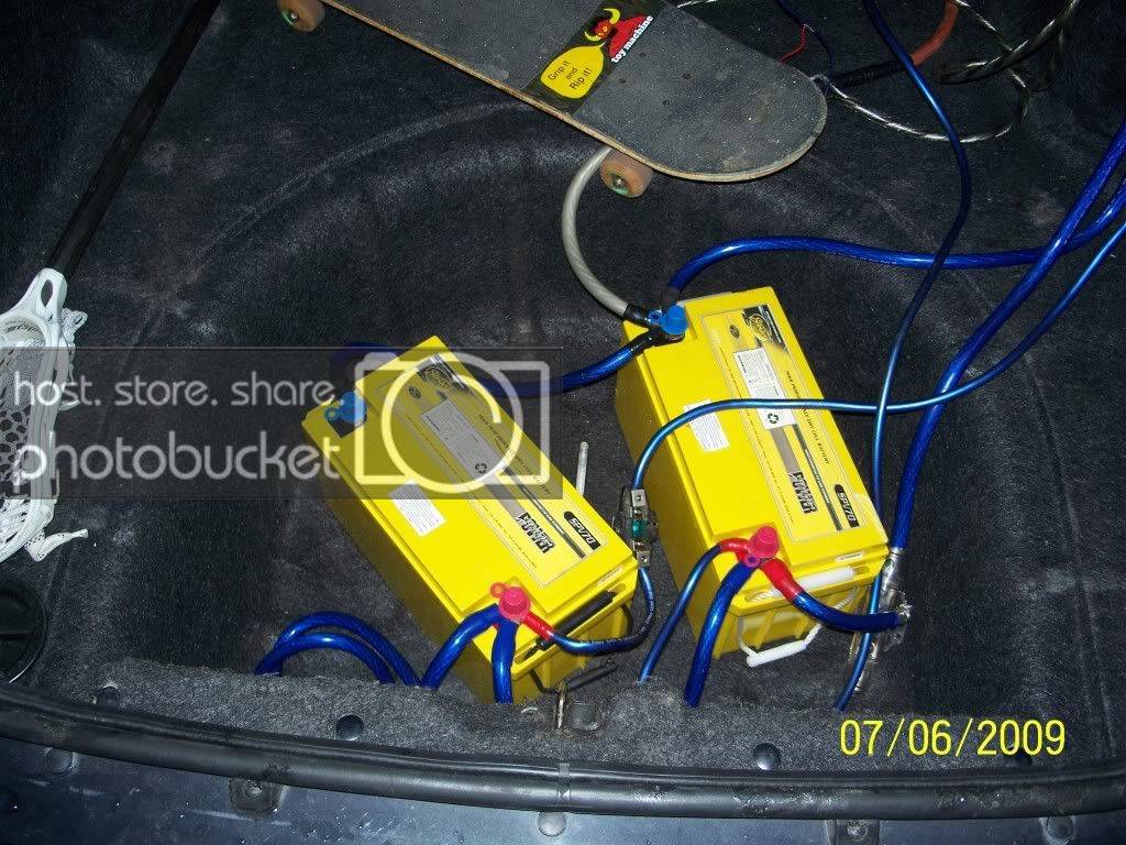

I like how the batts are just sitting in there lol nice build man //content.invisioncic.com/y282845/emoticons/smile.gif.1ebc41e1811405b213edfc4622c41e27.gif
haha yea its been like that for a few weeks ive been waiting to get new subs and i plan to mount the batts to the top of the box in the provided steel trays so they will be out of the tire well and i can put my spare back in.
there so heavy they hardly move anyways tho.

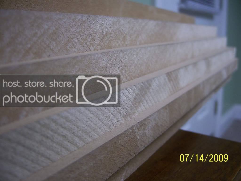

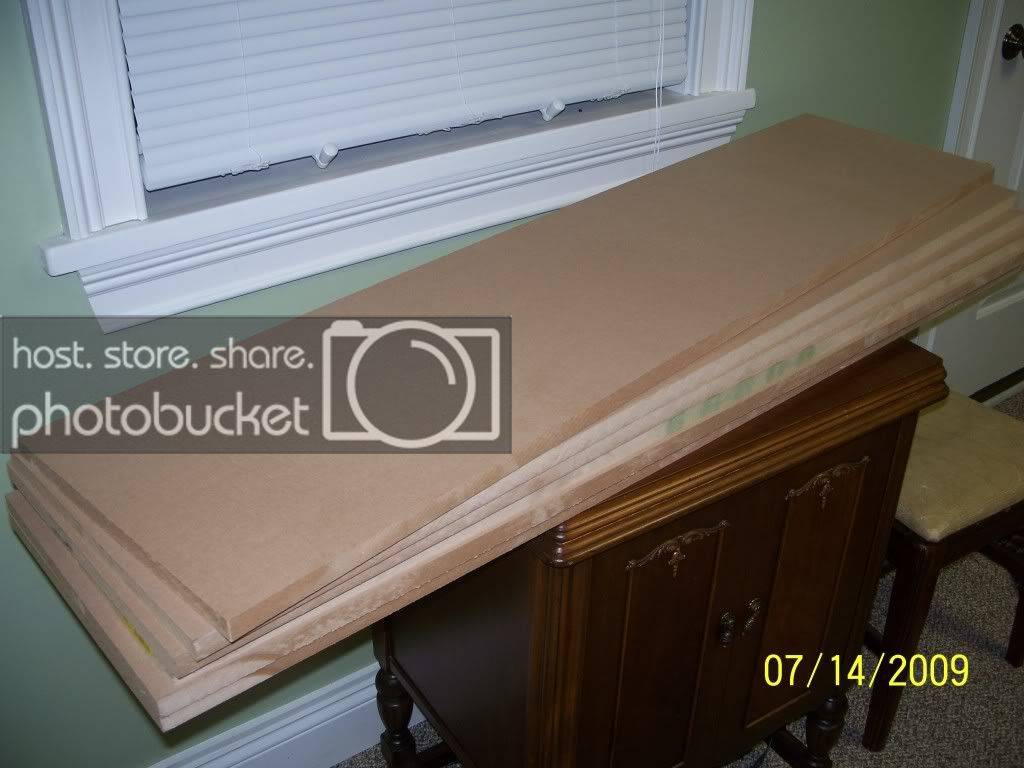

got some of the wood cut yesterday. Free Home Depot cuts FTW. they only gave me 10 free cuts though.
theres more panels than shown but i still need to make more cuts.
BTW i should add that i am making 2 separate enclosures to give me more options. But i am going to attempt to make a removable seal between the box and the opening behind the rear seat as well to maximize performance.

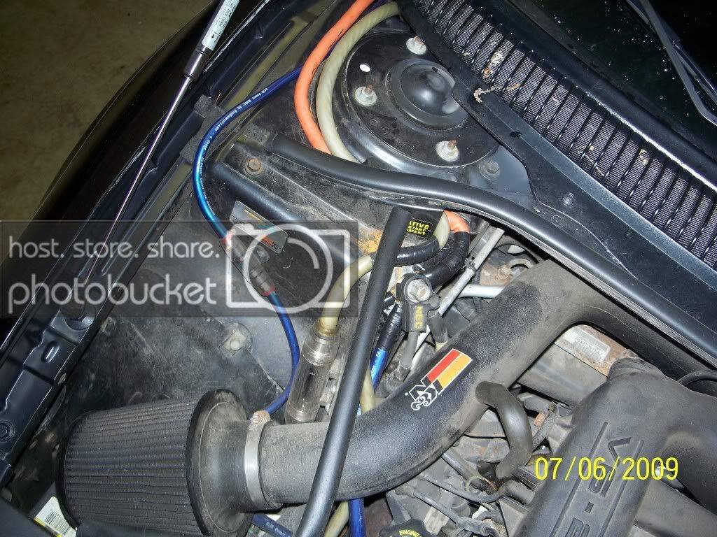

1/0 and a 4g Run to the trunk.
1/0 from alt to front batt.

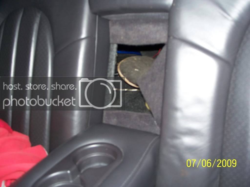

My unfinished armrest port hole. carpet still needs to be cleaned up.

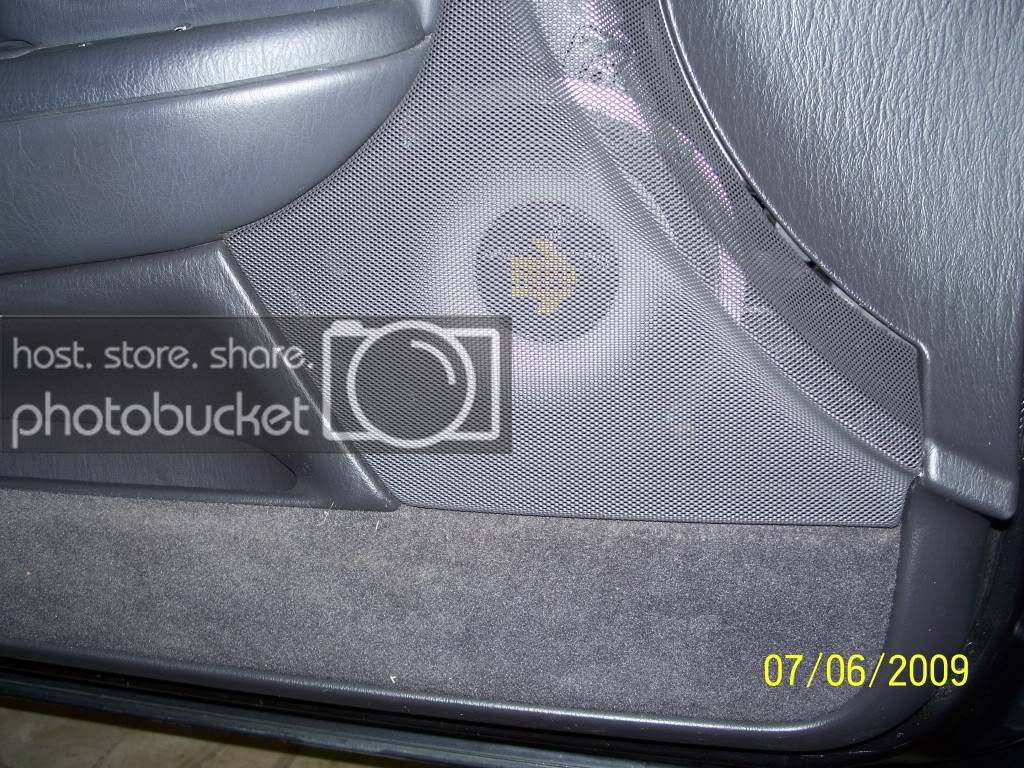

Polk MM6 front mids

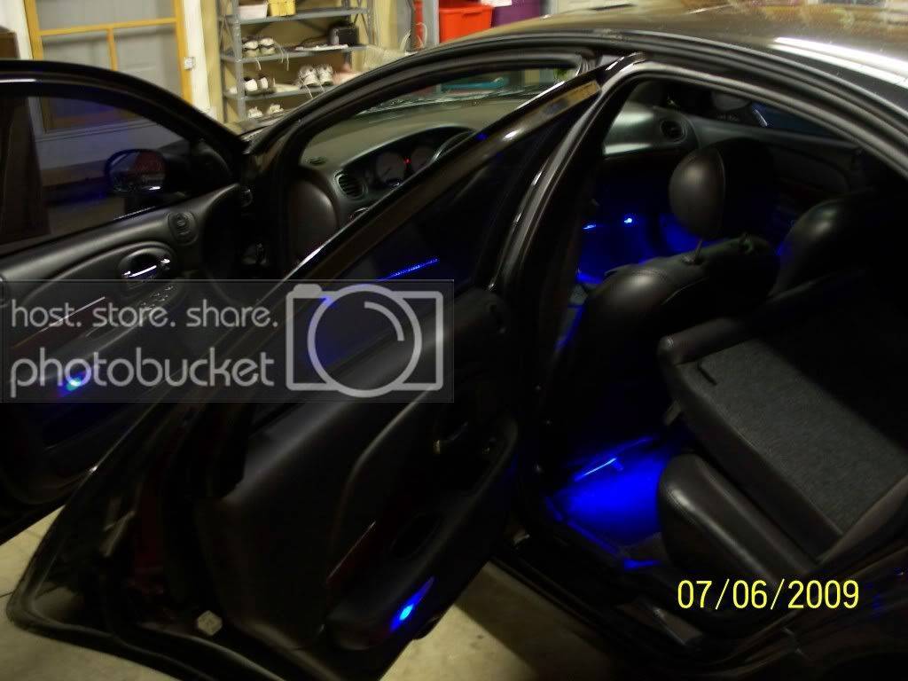

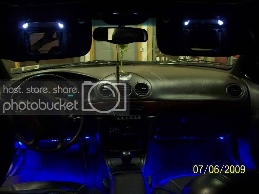

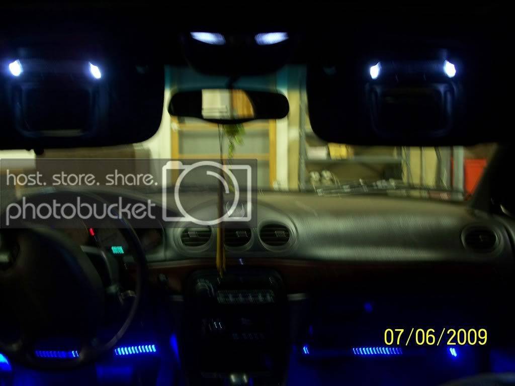

LED's
My car is filthy right now ****!
please mount those batteries better. any sudden braking or a crash is gonna make you wish you did after they come flying through the trunk into the cabin.
they maybe heavy, but nothing can stop centrifugal or g-force
Reading>you i already mentioned about that. Also there is a cover that was over them and the box was over the cover so they wouldnt have been able to hit me at least but they could have cracked and leaked still.
tylork, thanks man. they were a pain to install into the stock locations. They still come loose sometimes and i need to fix them every so often. Relatively easy fix tho. worth it for the look.

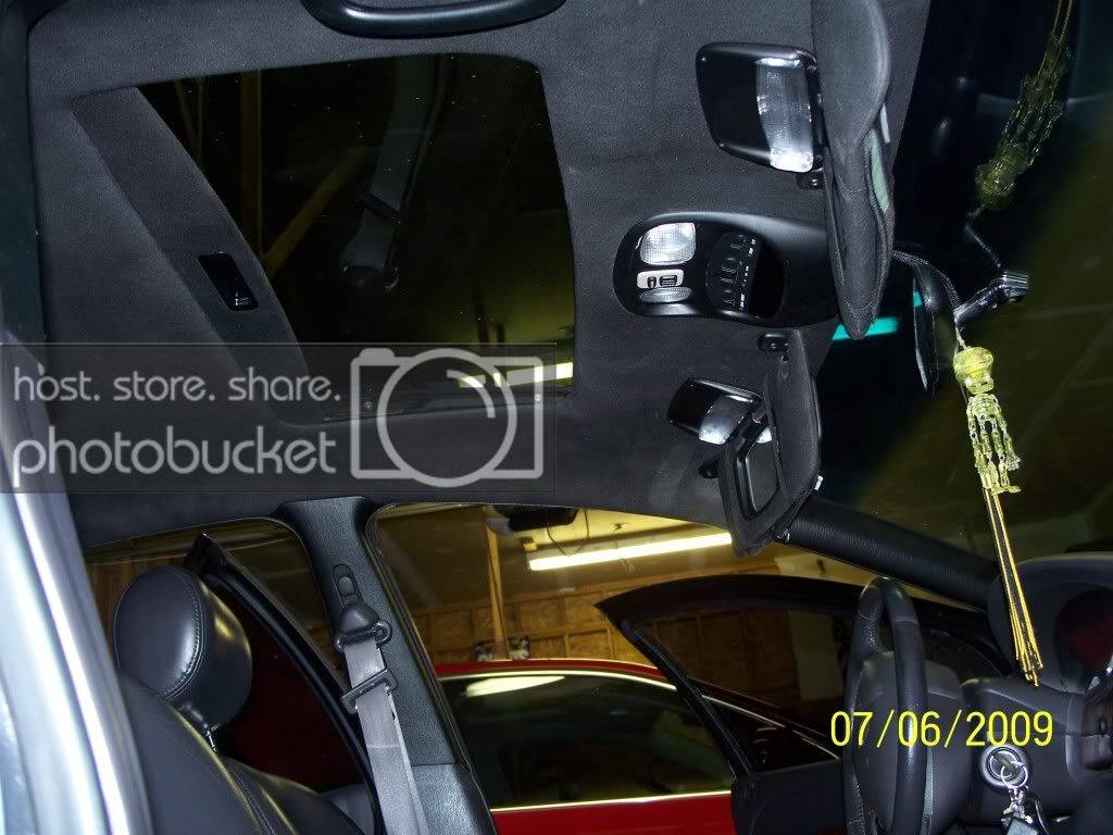

forgot to mention that my headliner is blacked out along with the upper pillars, making my interior black on charcoal.
