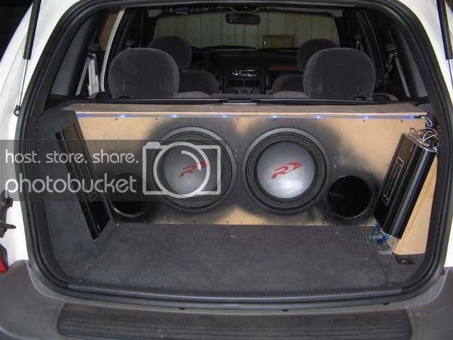

It took a few months to finish. Had to work a lot and didnt have the motivation needed to finish up the job. But I finally got it done.

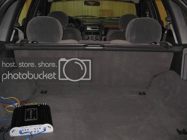

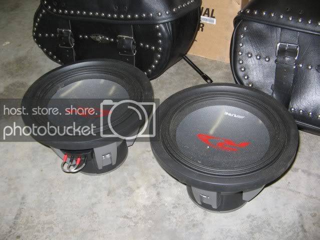

what i did have
blank slate

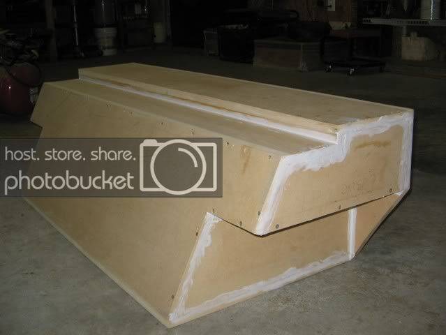

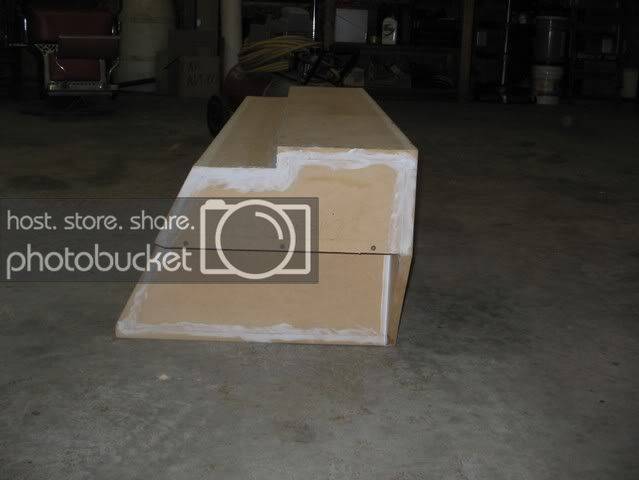

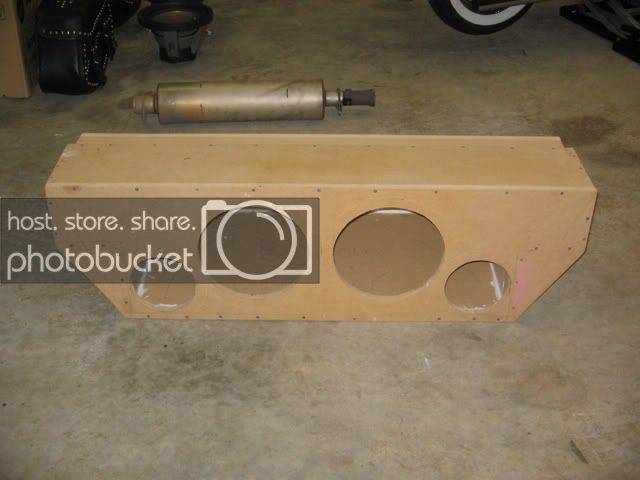

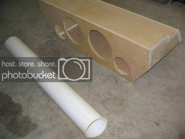

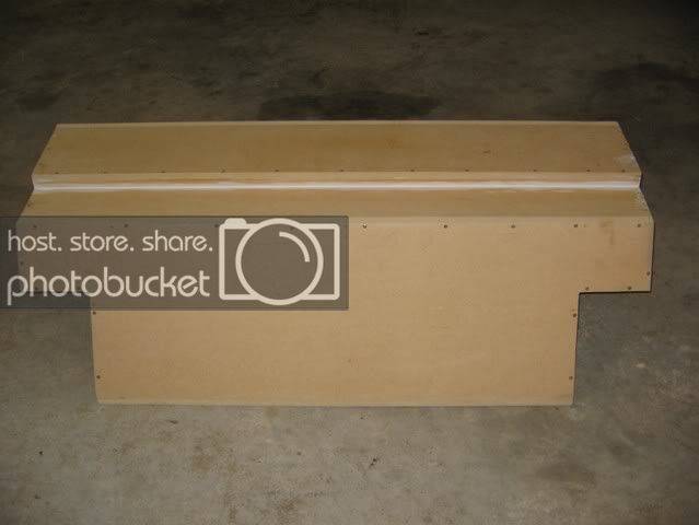

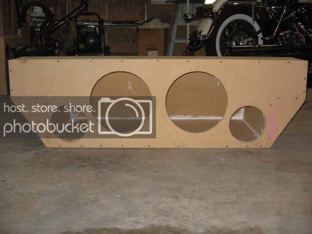

The new box. 4.5 cuft tuned to 32 hz. Very fun to make.

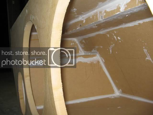

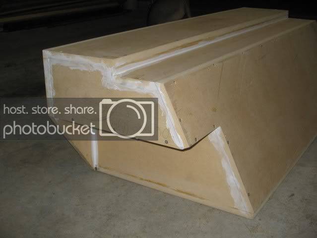

I like silicone

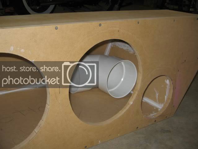

Notice the 4" pvc waiting to be used
The box was very time consuming to make. I wanted to save as much cargo area as possible to I used every bit of space possible to readhewd my desired 4.5 cuft. The 'wings of the box extend over the wheel wells and it fits snuggly against the rear seat.
Ummm...

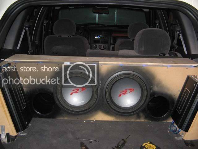

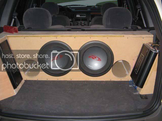

General layout

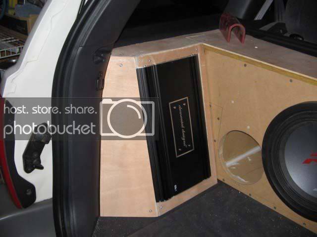

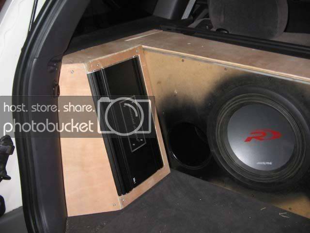

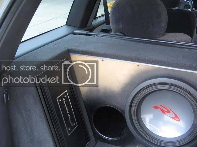

Sub amp beauty plate almost complete.

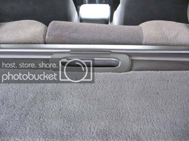

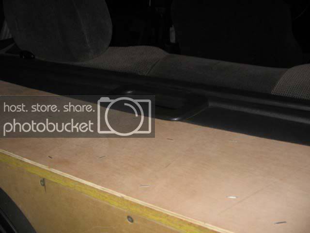

I inset the cargo cover to give it that fluch look

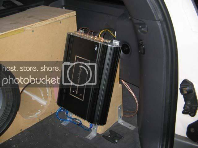

A little ghetto way to install an amp, but couldnt think of anything else.
Ports in

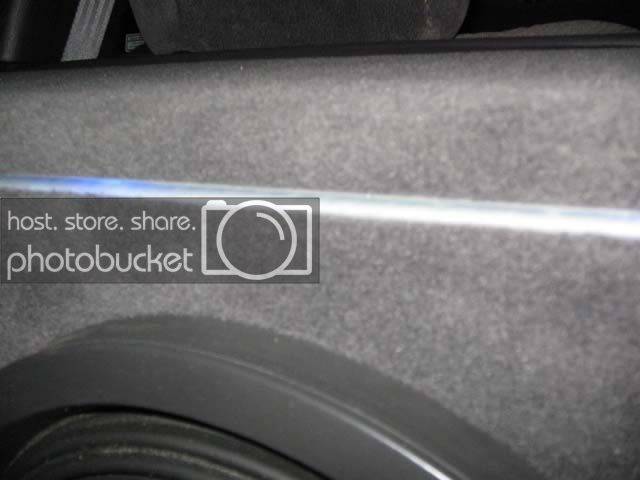

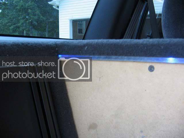

LED's mounted behind a piece of plexi, frosted. Looks better in person.
Sub amp beauty plate covered
woah u went nutz with the caulk there bud lol... but ya nice work that looks like a pain in the *** to design and build a box with that shape... why i just stick to rectangular prisms //content.invisioncic.com/y282845/emoticons/biggrin.gif.d71a5d36fcbab170f2364c9f2e3946cb.gif
Close up of the LED/plexi bar

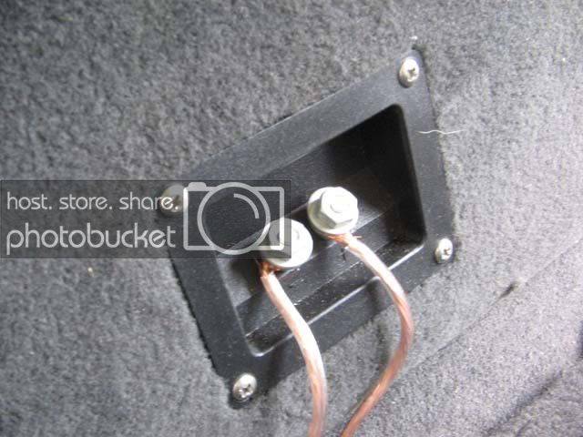

Bought a speaker terminel, but I broke the red and black nuts off, so I stripped it down and made my own with a couple bolts.

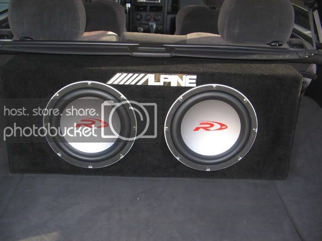

Front beauty plate complete
Flush cargo cover

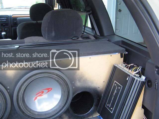

I did a lot between pics, but this is how it turned out.
The whole thing was designed to keep the cargo cover functional. Stealth.
Here's the back. The hinges are there to secure my box down, as well as to allow me to tilt my box back and access the spare tire in the floor.
box lifted
box lifted and spare showing. worked really well.
Alpine PXA-H510 processor mounted under the rear seats, along with the madness of wires.
And my favorite part of my car, 90watt strobe lights mounted on each corner of the car. (this is the control box for them mounted under the rear seats as well).
