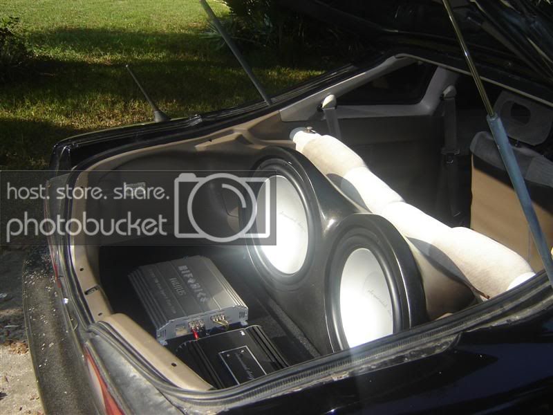

thanks. Um i used foam board as a basic cutout(guestimated the curves) , then went over it with poster board to get closer to the edges.
http://photobucket.com/albums/v609/theender/Construction/?action=view&current=8093Medium.jpg
Since it wouldnt fit directly(whole cutout) i had to cut the floor in half. I made a frame under the floor to hold it up.

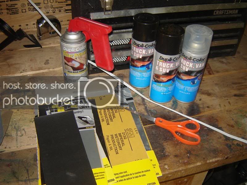

(looking at the barcodes)Paint T90, clear is T125, and then just high build primer.

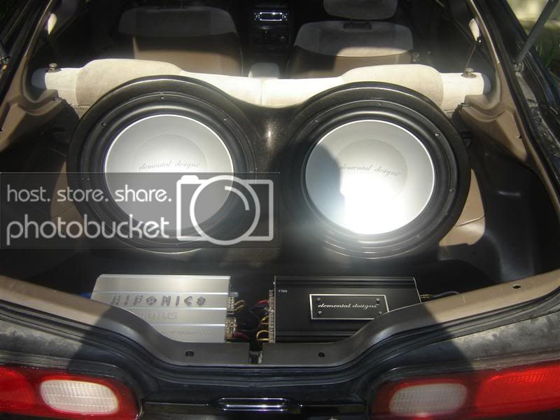

Those subs look like they are suffocating..
They are seing 1.7ish ft^3 each. I measured with packing peanuts(in the pics).
