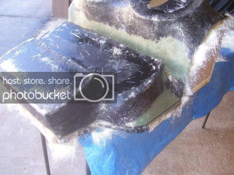

here is the first box i ever made and it was done with just the stippling method. all the white spots you see were air bubbles trapped under the cloth i was using. this is after 2 or 3 layers. if you get bubbles you have to sand them down and fill in the low spots again. bubbles are not your friend when it comes to fg.

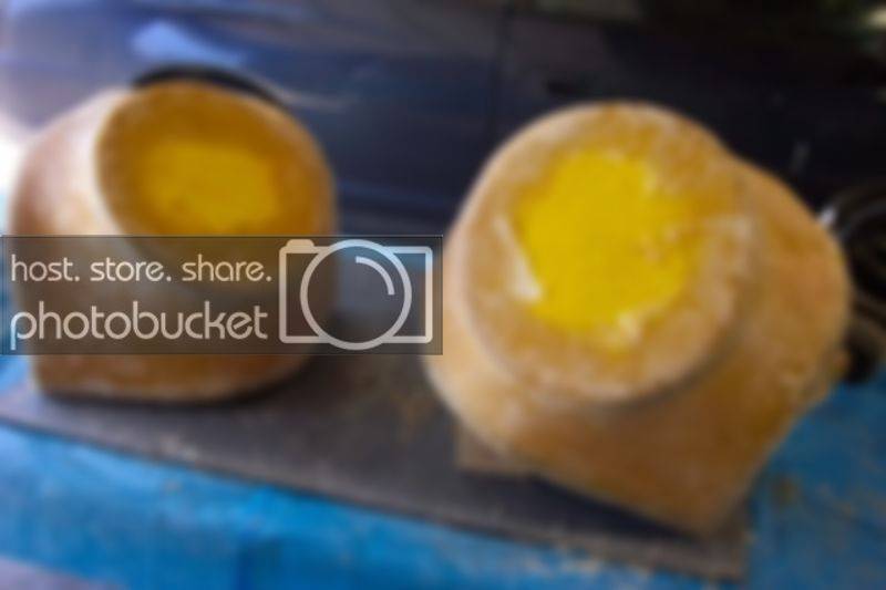

this is another box i made after 5 layers using the roller. you can see that there are no bubbles at all.
