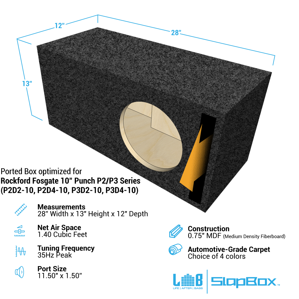

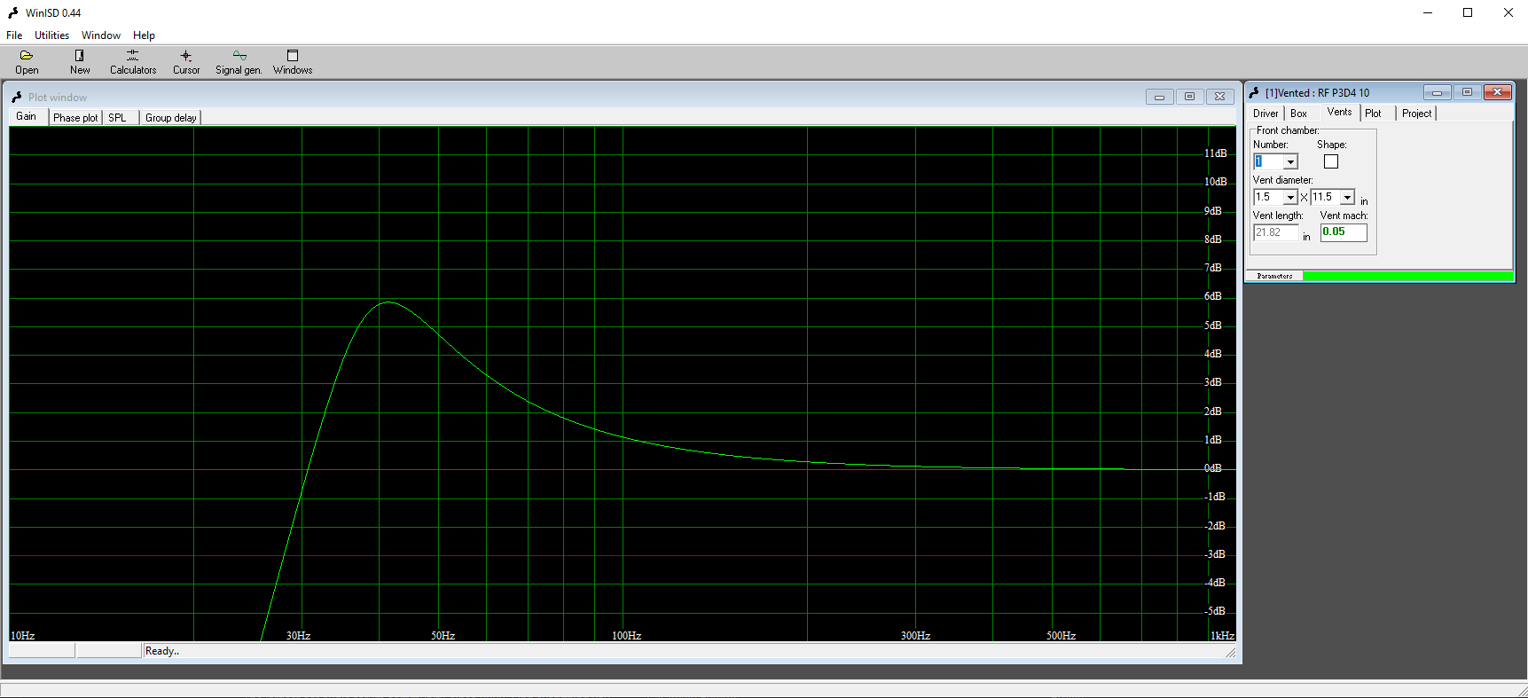

Looking for shredder2!!! Hey man I opened up Winisd for my current sub because I found this enclosure on eBay. It says it is built for my sub via its T/S parameters. 1.4 cubic feet and ported. When I put in the parameters of this box with my sub, this is what Winisd shows. I still have no room to build my own enclosure and the only decent shop here wants over $225 to build the box. Your thoughts, will this work. Is it a good enough match?

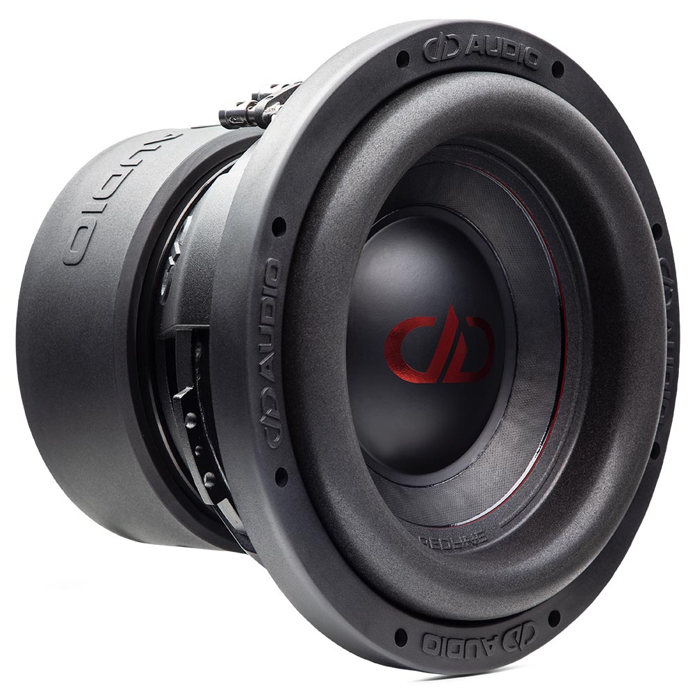

Did a listening to a DD Audio sub. The 710 - D2. I listened to it with >1000w going to it and it was damn impressive. It hit harder, louder and lower than my P3D4 10". Talked with the owner and we may be working out a deal on one of these impressive subs.......
P3 is very peaky that falls on its face below 40hz with that design- almost like a prefab box (lol reread and yep).
DD 710 is a nice upgrade, ditch the P3 you will be happy. 2 510s would put a smile on your face too, one of the most well rounded subs out there for the money.
