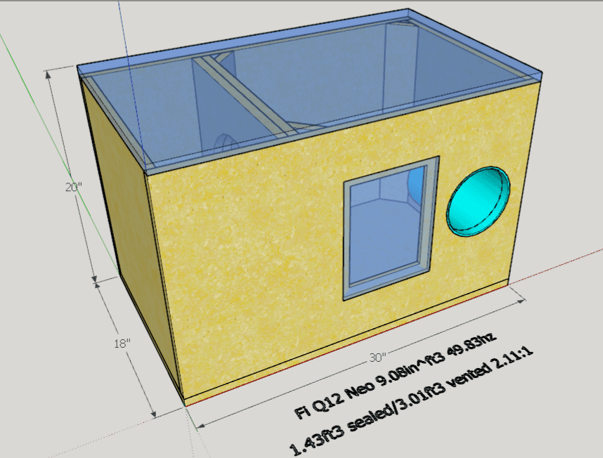

This?.. any thoughts?
wow. very cool. I would be interested to see where the center of that port is. with the dimensions i can check to see if its firing right between the two seats, which would be great.
also if the height was reduced to 18in, what is the increase in width?
and is it a characteristic of 4th BP boxes to be tuned higher that straight up ported boxes? i often hear ppl saying box tuned to 33 or 38, rarely do i hear 50...
hope to hear back
38hz, 33hz... thats a ported tune... for a 4th I'd recommend a mid-hi 40's tune. the ratio lends itself to good low end without being too peaky. Should be pretty musical. I can lengthen the port slightly and lower the tune. It'll change sealed volume slightly hence ratio... but not too much so it'll be musical still. the Q has a 11.5" depth so the port has to be offset. My first attempt had a 44hz tune but after some consultation it needed to be raised a touch as over 55hz it fell flat on it's face.
hope to hear back
yes because in ported box the port controls the sub.. bp box is a sealed box with a ported box on the back of sub lol

I understand about the tune.
what if the height was reduced to 18in, what is the increase in width?
if you would have given accurate dimensions in the 1st post re-sizing wouldn't be necessary... as far as new measurements and what would be what... I really don't know offhand and I'd just look for a 2:1 ratio for good musicality... peakiness or loss of output can be something you might get either tuning too low or too high of a ratio or a combination of factors. That box above is for your power (DD m1d @ 1 ohm) and looks good to me for the music taste you listed. A 46-48hz tune might be something to look at but this is what I came up with after a 44hz tune was deemed too low after some consultation.
It's actually fairly good sized on the sealed side and should go low pretty well.
But hey... I'm learning new things daily. This enclosure is what I finally settled on... I'm sure it can be improved
