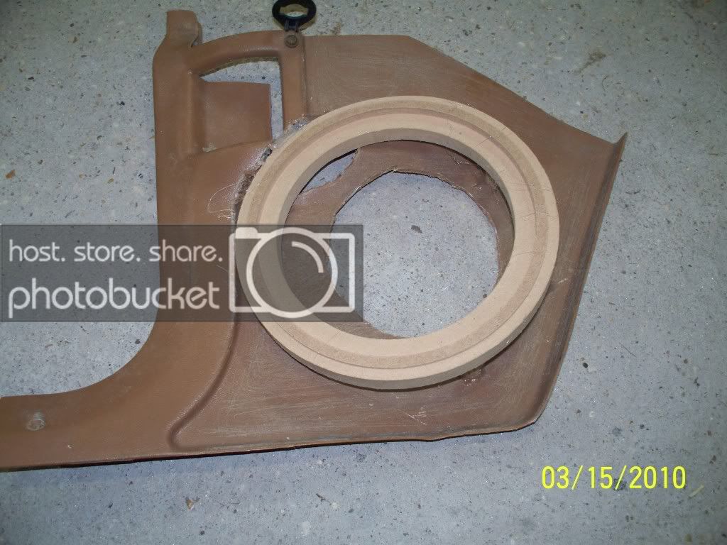

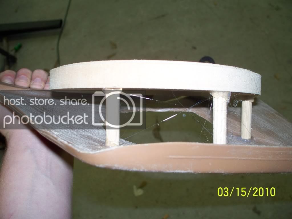

FATBOY'S first ever kickpanel build.

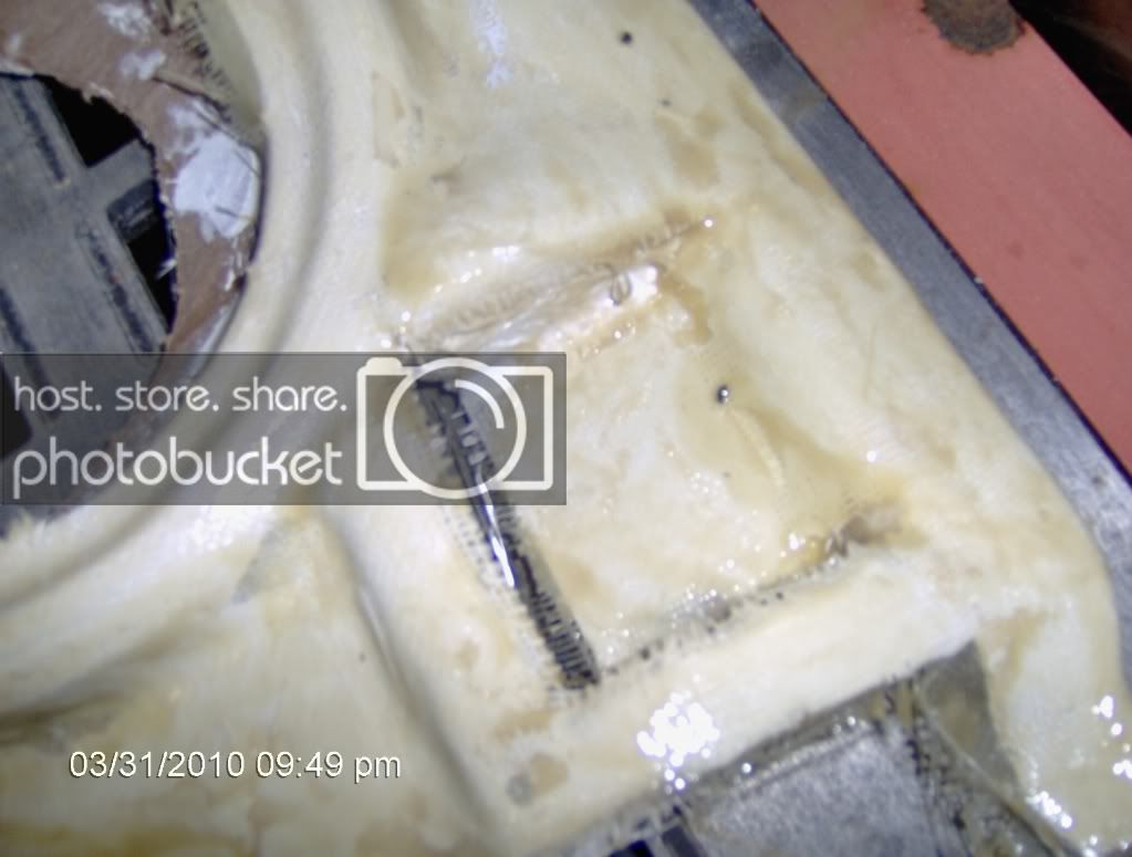

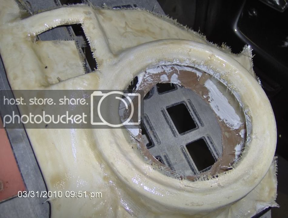

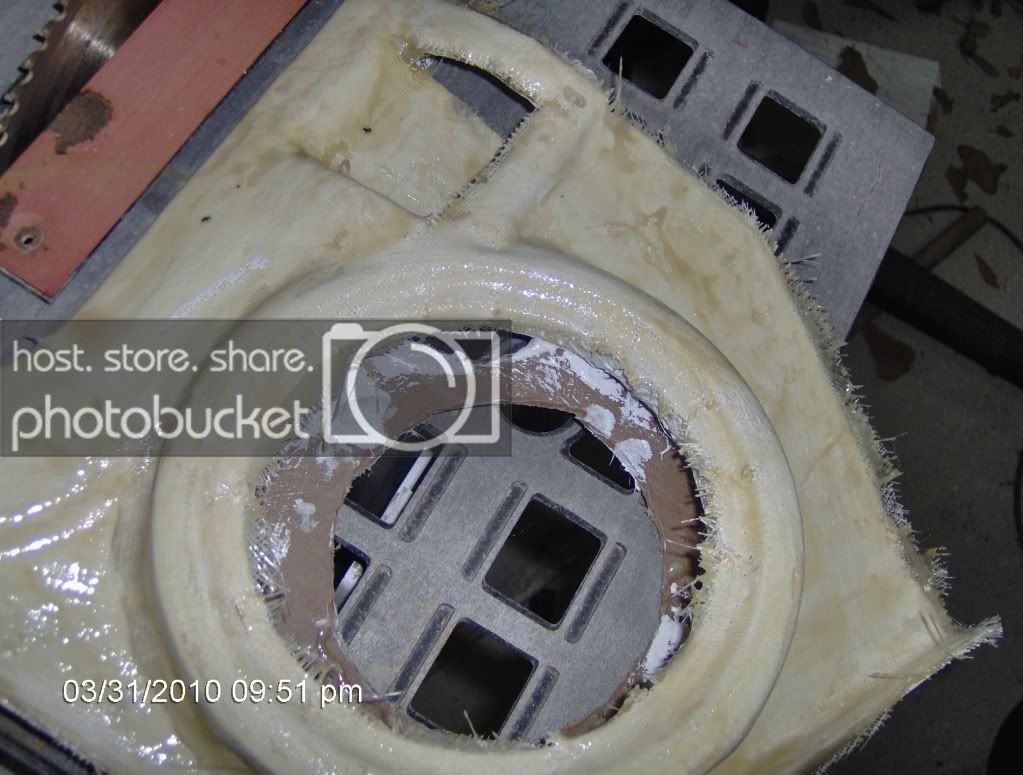

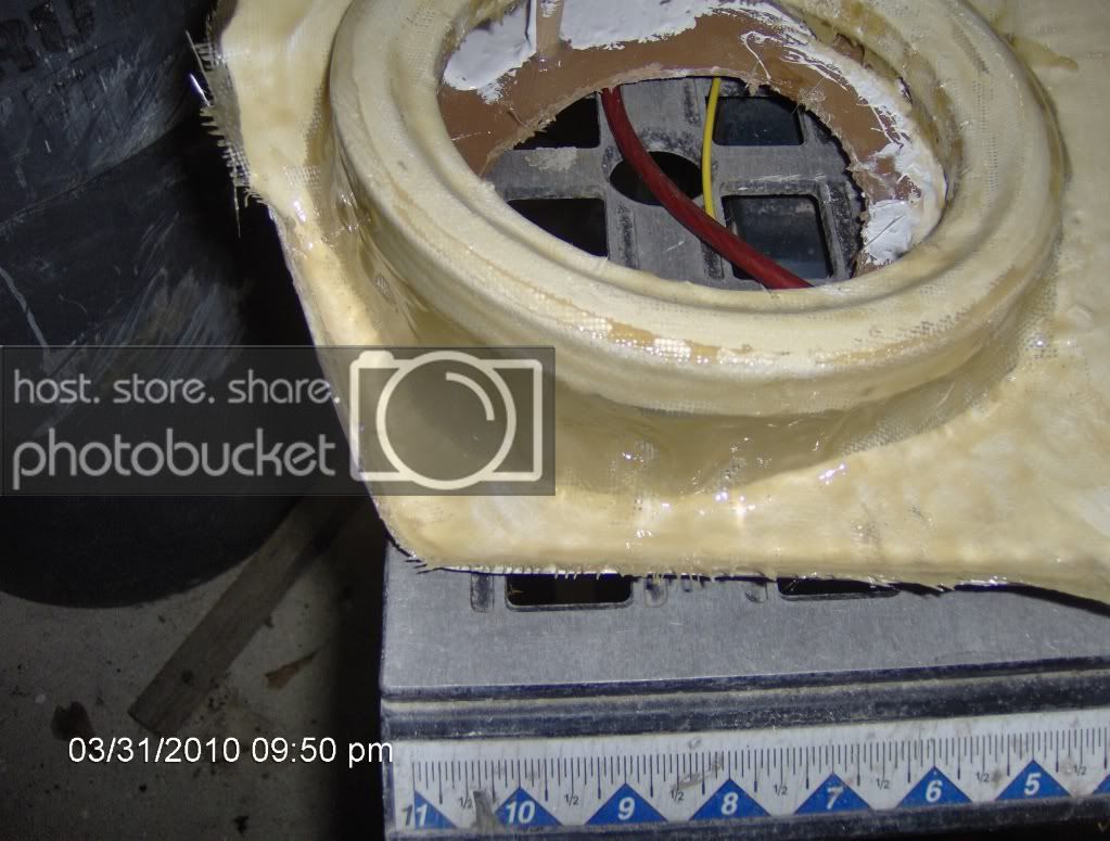

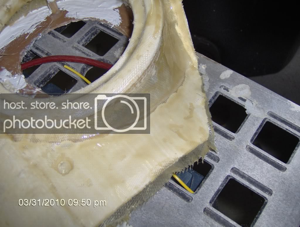

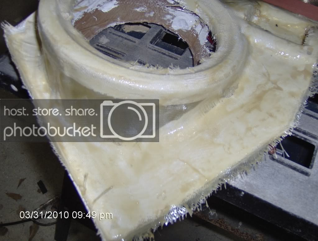

Looks pretty good my man. I see you scuffed the plastic. Next drill some small holes in the plastic panel to give the glass some teeth into the plastic. Plastic and poly resin don't like to stick together very well. //content.invisioncic.com/y282845/emoticons/smile.gif.1ebc41e1811405b213edfc4622c41e27.gif
Well i tried something new, and so far it's working fine. I did a layer of 3M 5200 (marine adhesive) between the glass and the plastic, because i know they don't like to stick.
