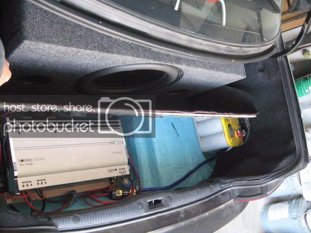

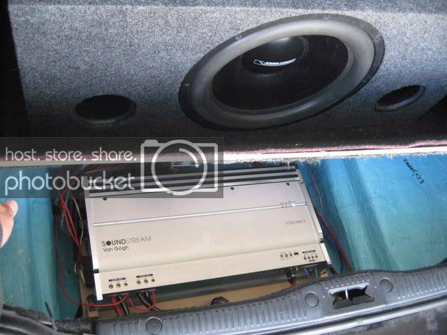

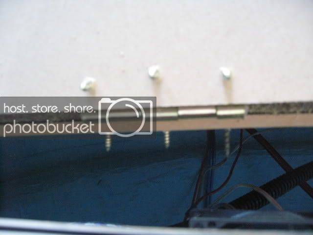

I just made a very simple one i can show you, but it's plain as can be.
i just used the stock carpet as a template, and used two pieces of 1/4" hardboard, 1 for under the sub box, 1 for the obvious 'access lid' or whatever you call it.

Also if this is your first floor install a mistake i made was not having wires run properly and not enough wire. Test fit everything before you finalize anything. Just a friendly heads up
