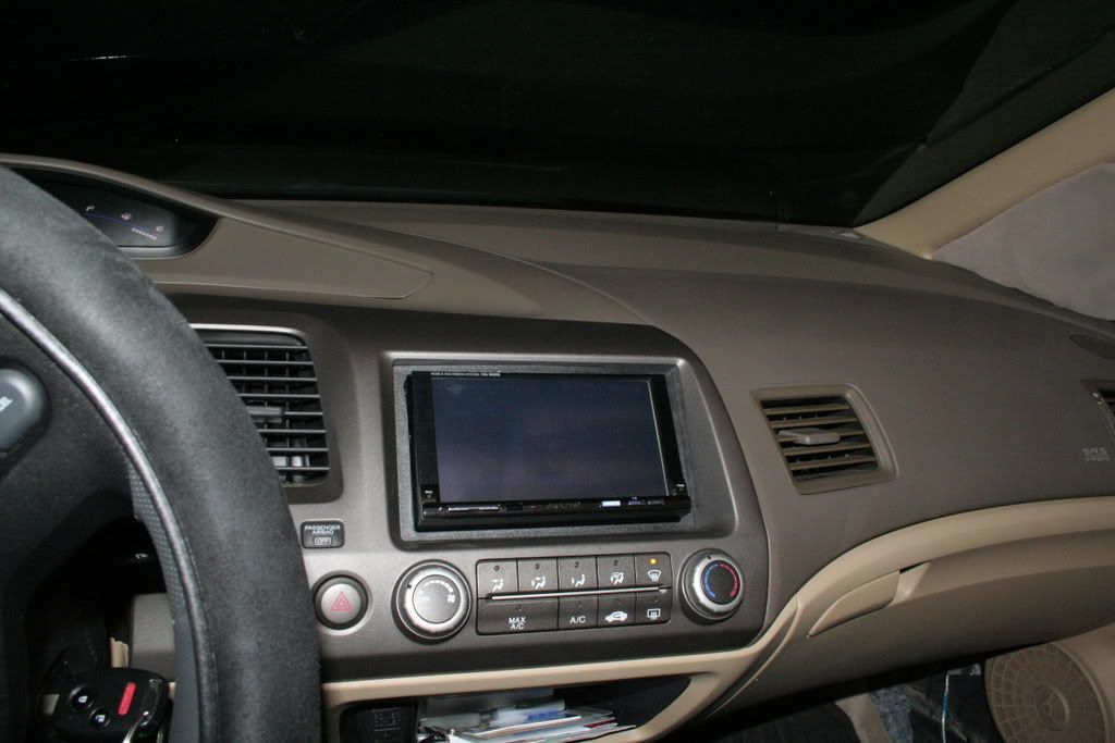

I started yesterday. I did get my w205 headunit in, after realizing the harness was missing one of the brake bypass wires. I replaced it with the power antenna wire and got it up and running.
However, my negligance cost me a trim ring. It was causing the w205 to not fold down all the way so I put the dremel to it. Wasn't paying attention and forced it into the ring to start grinding and it ate WAY too much of it, lol. So, I'm gonna have to replace that; but nothing that can't be done in 5 minutes and I won't have to remove my h/u to do so.

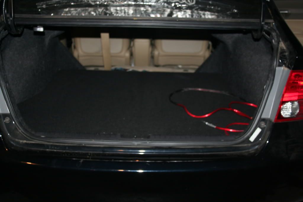

The rest of my time today was spent cutting out the top and bottom of my new false floor. My dad took 2 hours out of his day to help me with this. Actually he pretty much did it all himself while I was trying to get the headunit wired up and in. Instead of using 1/2" MDF like last time I listened to some guys here and went with 1/4" Birch Ply. Got the two layers cut but had to cut the top layer down the center so that it can fit properly. The wings on the side made it too wide to drop right in (for those of you who are wondering how the bottom piece fit fine...I don't have the "wings" on the bottom since they won't serve any purpose there. Dodged the bullet with at least one layer. Going to carpet each piece on the top layer seperately with black auto cloth.

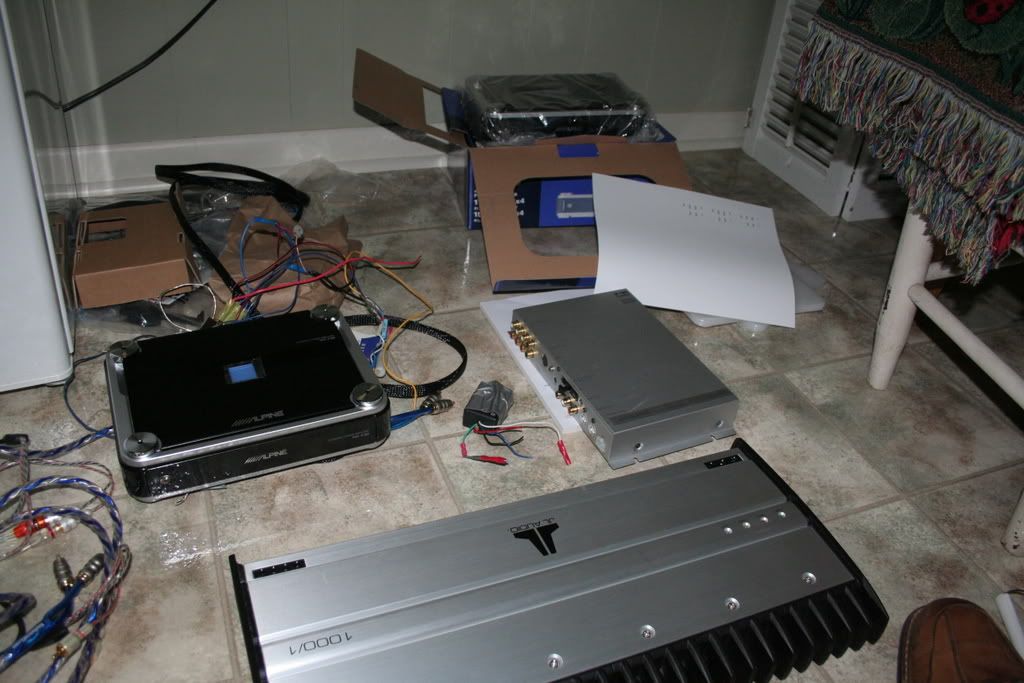

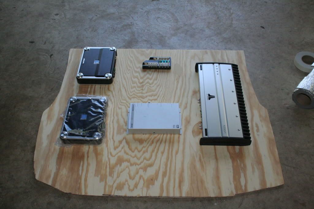

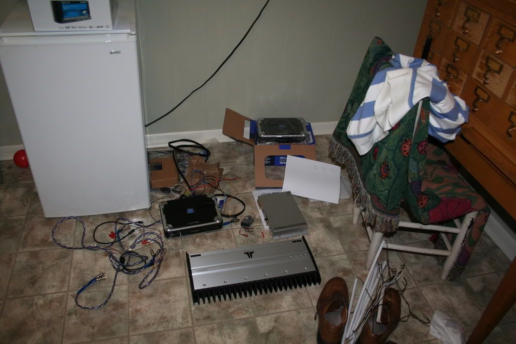

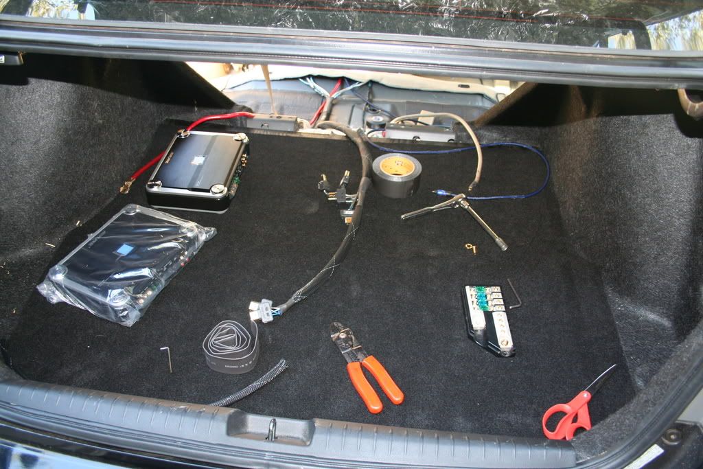

So...here's what my layout looks like. REalize that my RCA's are 3.3' at the shortest. I'm going to have ALOT of extra wire. Ideas on what to do there? I don't really want to run the wires under my floor cause I'm worried they'll get squished. I'd appreciate some input. I bought alot of "tech flex" to cover all my wires.

Headunit installed. Note the top corners are rounded WAY too much. That's what I was talking about in my first post. I'll fix it. Just gotta get a new trim ring and find a smaller diameter dremel tool to round out those corners.

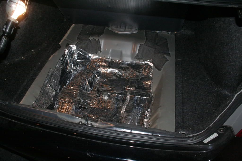

Used left-over Raammat and put it on the bottom of my trunk. Surprisingly, everywhere that isn't deadened seem pretty solid. I did the "rap" test and knocked on every portion in the spare tire well. The only spots that resonated are what you see covered below.

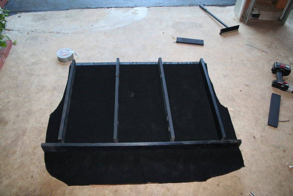

I also managed to carpet the bottom layer of the false floor.
I gotta pretty much finalize the floor; get braces in there. Then I gotta run the wires. Then screw the amps down in place. Next comes putting main wires to distro block. Then connect it all, set gains, tune, repeat.

So, I started slow. Took my time plotting my layout. Got a friend over, and he and my dad helped me out. We got wires ran, and tech-flexed. Then we marked off the supports for the bottom layer and screwed them in from the underside. Sturdy!

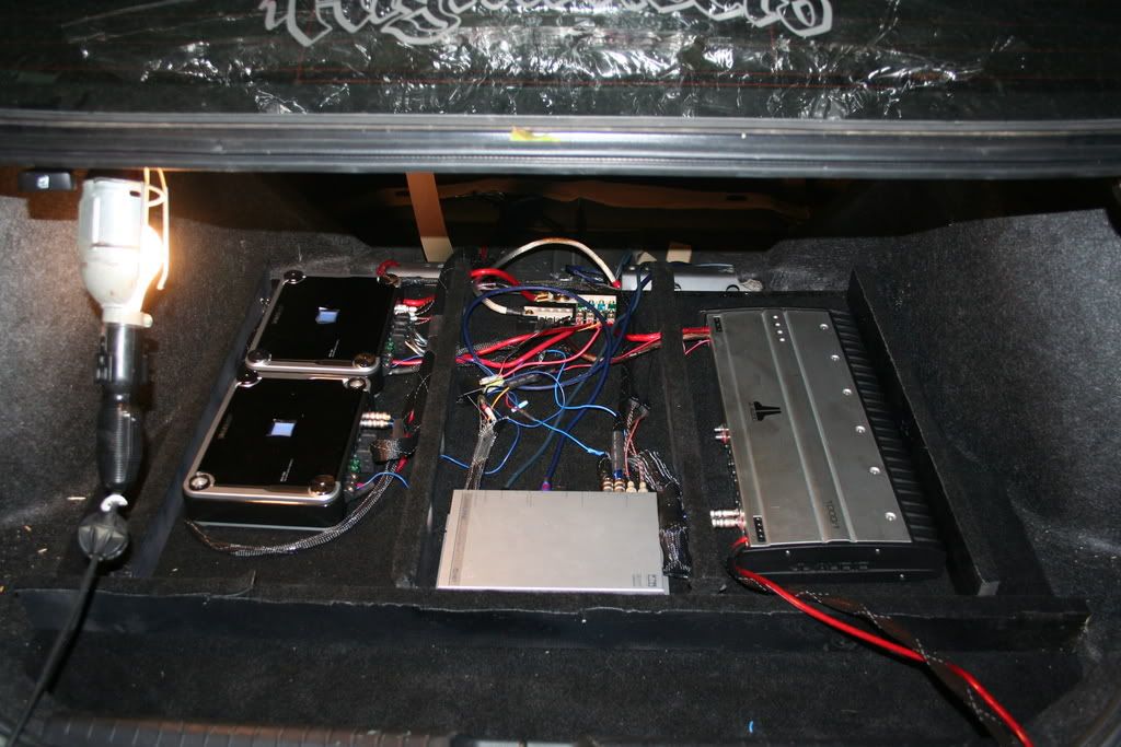

Around 4 I got to the wiring. I decided since I had plenty help, to go ahead and wire as much as I could out of the car, then put it in as one piece and connect the speaker wires & main power/ground.

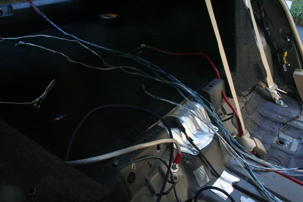

Covered everything good with flex, then heatshrink. My only real issue is/was with my extremely long RCA's. I just ran them around the entire floor and then back up behind the amps and around to the terminals. Nice.

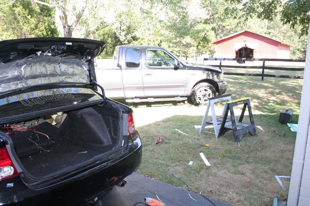

Got it in, turned the car on and no sound. //content.invisioncic.com/y282845/emoticons/mad.gif.c18f003ab0ef8a0d9c27ca78d77a6392.gif Thought I used the wrong remote wire on my h701 but didn't. Then I realized that I had to use a relay. Weeeell, crap. That screwed my "fancy" wiring up because by now it's 8:00 and my dad's ready for me to call it a night since he needs to help me take the dog's fence back home (pictured below). Just wired it up to see if it would work; it did. Cool. Set gains on my new PDX 4.150. Sound isn't good. "Alright...I can deal with the lack of SQ for now. I'll just go ahead and put the top layer on and tackle the rest of the wire fanciness and tuning next weekend". Well, here's the //content.invisioncic.com/y282845/emoticons/mad.gif.c18f003ab0ef8a0d9c27ca78d77a6392.gif part. When I put the top layer in (which is 2 seperate peices joined by 1 layer of carpet thanks to Rabbit's or Winslow's idea (can't remember who suggested I do that). It worked, but was a bit of a pain to get it. Guess when I did I knocked the relay power loose because after I got my dogs loaded up and ready to go, there was no sound, but the processor is still recognized (sign that distro block and ai-net are fine).
Oh, well. I guess I'll just have to deal with that next weekend, too. I was just wanting to have tunes this week; didn't really care about cleaning the rest of the wires up until next weekend. Now, I have to do both next weekend. //content.invisioncic.com/y282845/emoticons/frown.gif.a3531fa0534503350665a1e957861287.gif Oh well, at least I didn't have any system noise for the few minutes I listened to it.
So, here's some pictures. Once the bottom layer is tidy'd up more I'll post "final" pictures of it then. Think I'm going to go with some DIY RCA's (or 1 foot ones if anyone has them).
