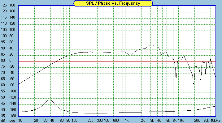

How easy would it be to fix the ~1.2kHz dip in the graph below? I'll be using the 880PRS for processing. I've never messed with an EQ in either home or car systems, so I have to ask. Doesn't seem like it would be difficult, but that's a pretty substantial dip...

Honestly the frequency response in that graph doesn't matter one lick since that response was not measured in your vehicle...where the speaker will be located.
That graph is not representative of the response you'll have with the speaker installed in your vehicle.
The response is going to change drastically from that graph once you install the speaker in your car.
Couldn't you say the same about running this in someone's dorm room, since the graph was likely taken in an anechoic chamber? Yet the home theater guys are all about throwing in notch filters and ridiculously low crossover points to try and obscure the dip, despite the fact that the rest of the frequency range will no longer be flat in a real room and will require minor EQing as well. Obviously a car is a much worse environment, but wouldn't this at least indicate that a big trouble point will be around the 1.2kHz area?
The effects of room acoustics will be much less severe than in a vehicle. So it's not quite the same comparison.
Your vehicles acoustics and installation are going to completely swamp almost all of the driver's own inherent frequency response characteristics.

I'll probably put a lpf on the woofer somewhere around 1.6kHz, so the upper peaks won't be too much concern. My tweeters should be able to be crossed around 2kHz without an issue.
