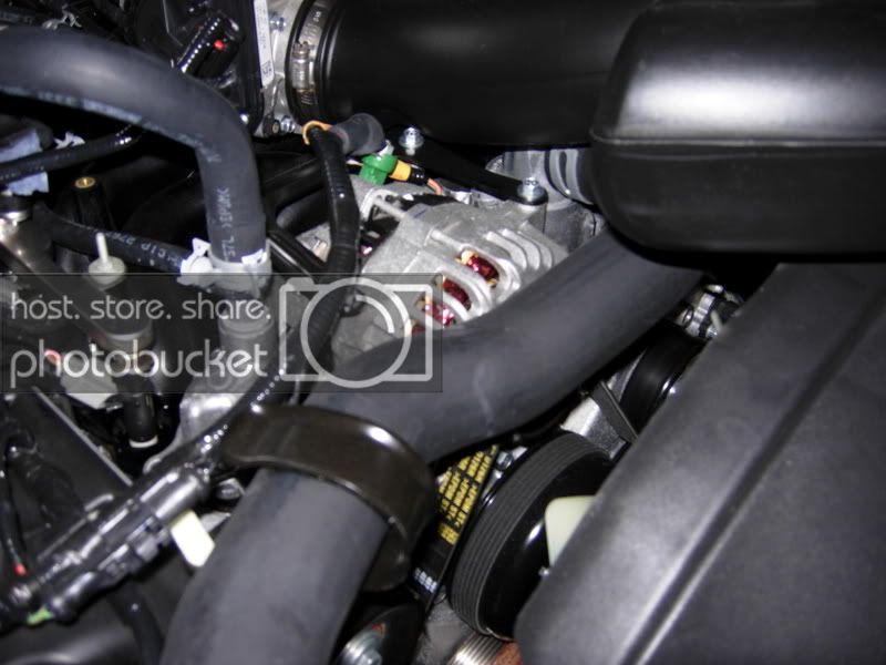

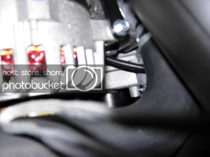

those are pics of my alt, and my question is will that black bracket do anything as long as i have it and the bolt down to shiny bare metal? or does it need to go between the body of the alt and the bracket?
