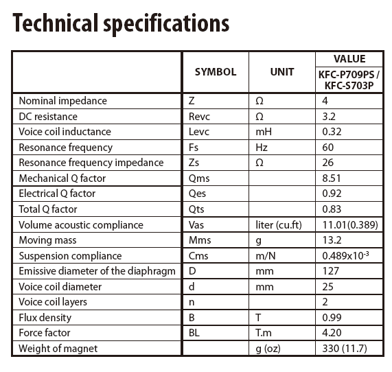

The components in question are Kenwood Kfc-P709PS and the tech specs are as follows:
(it's an image, if you can't view it let me know exactly what numbers you need)
Any advice or assistance you could give me would be greatly appreciated.
