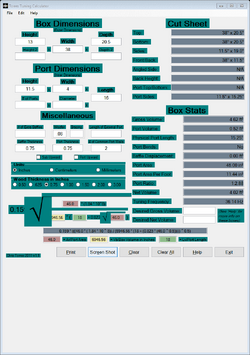

Here's what  I came up with after playing around with it for several days.  Tried aeroports but they require too much surface on the baffle and I don't want to fire the subs opposite of the port.
4 cubes at 36Hz gave what I felt looked like the best graph.
Rear port air velocity is under 16 m/s
https://3dwarehouse.sketchup.com/model/752376f8-6513-48bb-a0f9-408b049d1d41/Four-8-subwoofers-box-in-4-cubes-tuned-to-36-Hz
