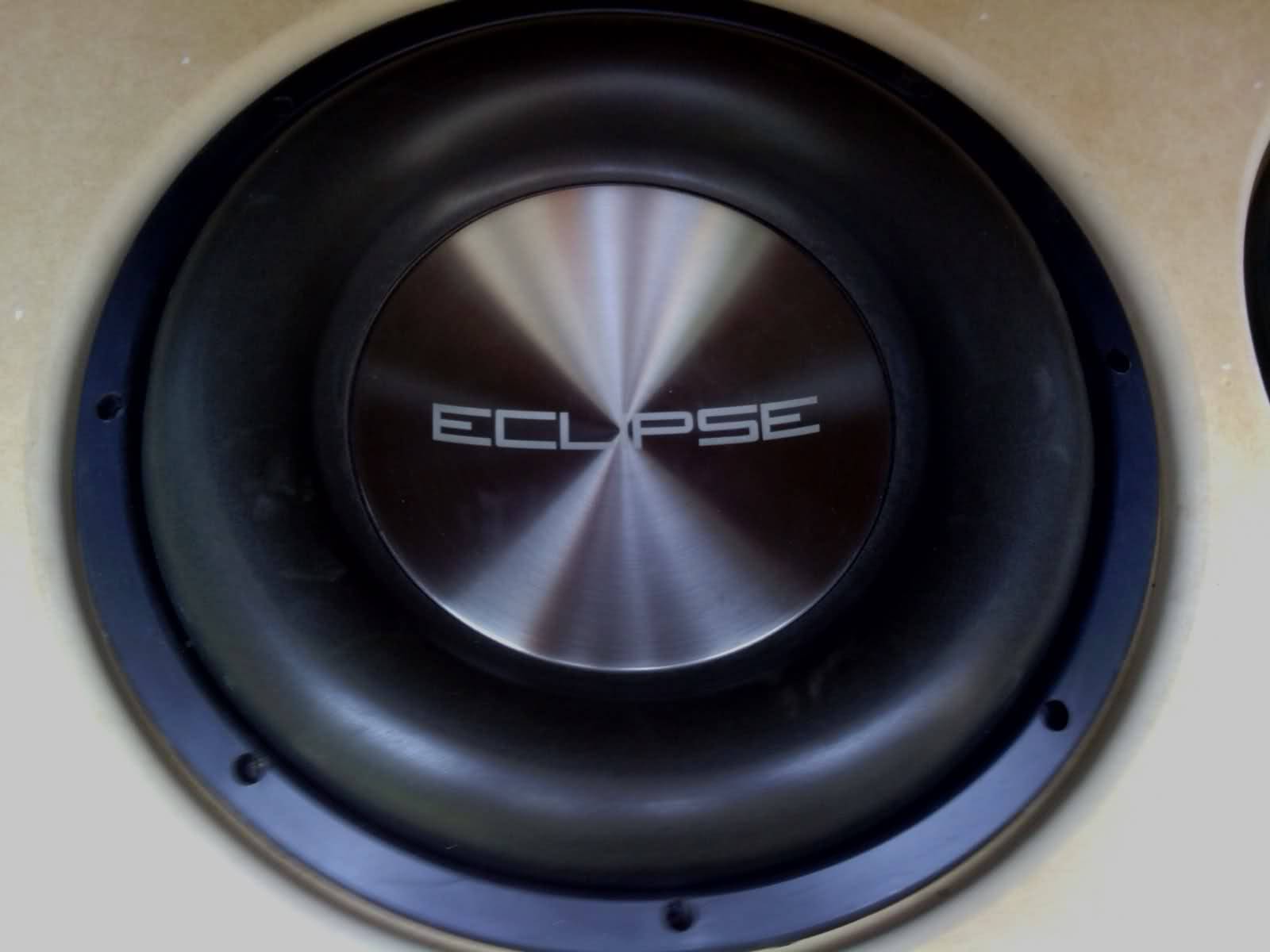

For the past few days, I've been noticing a popping sound coming from one of my subs. Still bangs hard, and you hardly hear it in the drivers seat.
Did some more investigating today, and I noticed when the bass hits I would get air coming from the cone.

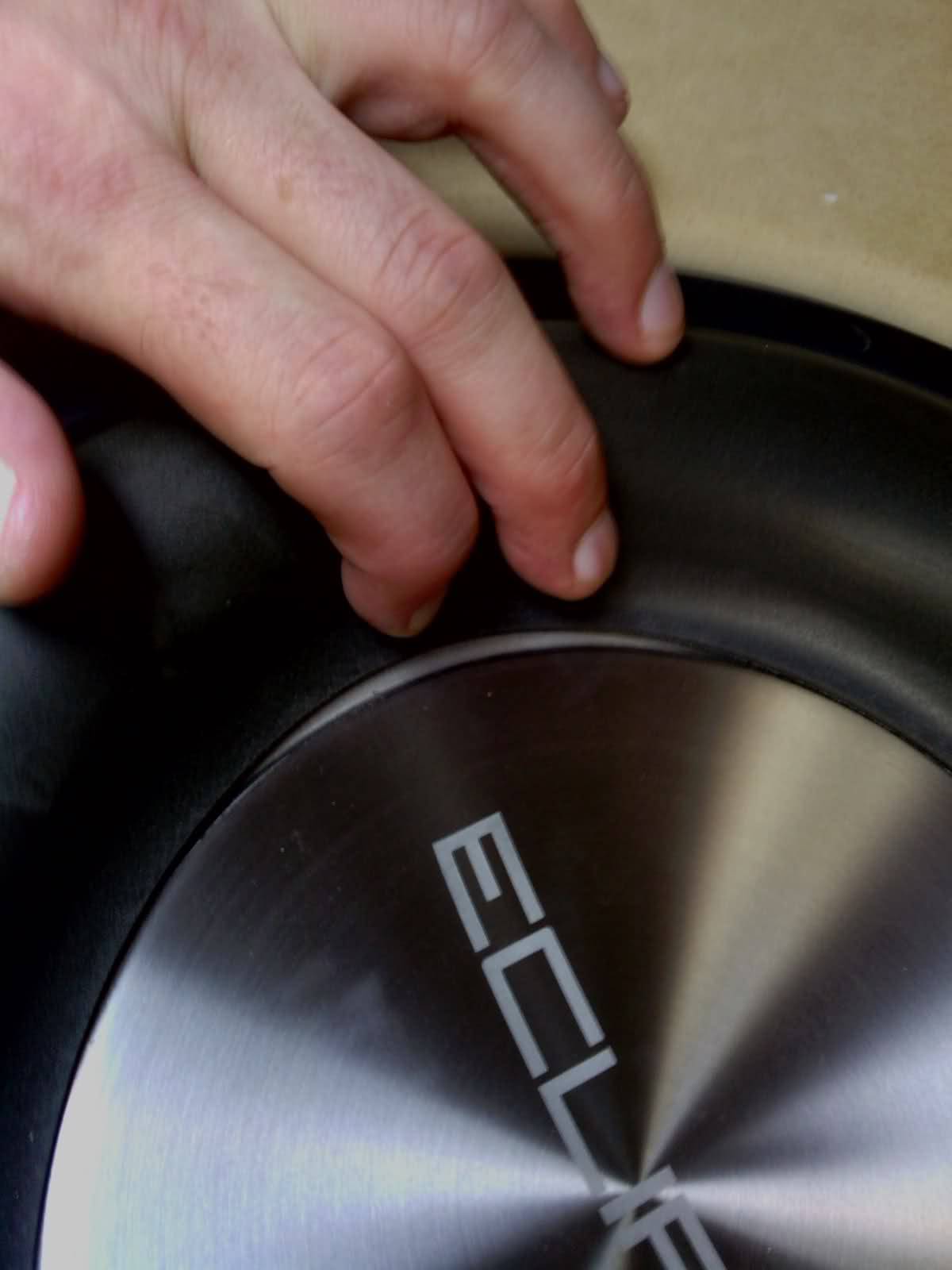

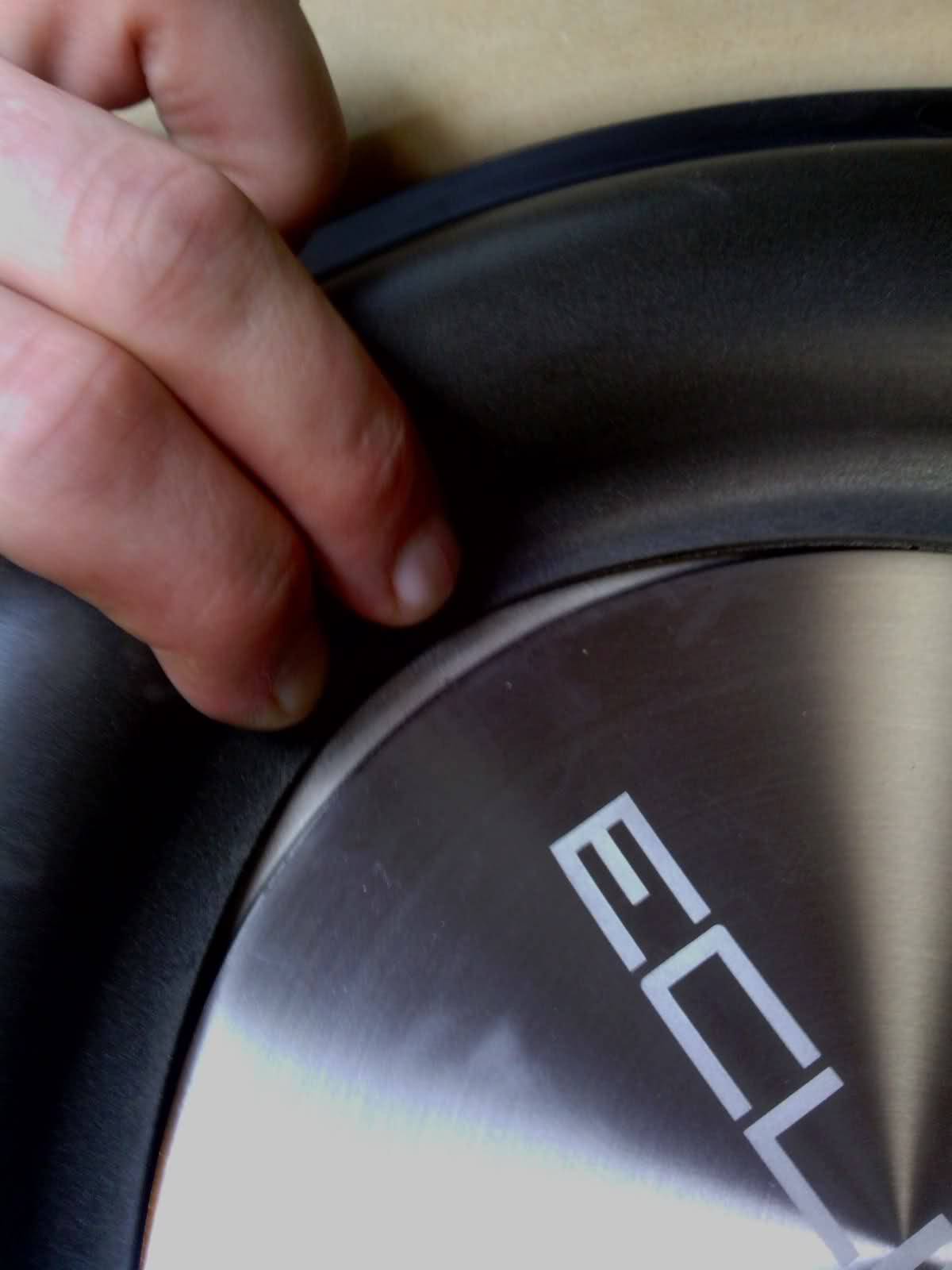

Pressed on the cone, and I can see the surround coming off the cone:crap:
Its come apart from about 12 o'clock to 6 o'clock.

I would use a medium thick ca in VERY SMALL amounts, also I would glue whats come loose before I pulled anymore loose that way you maintain you VC in the center of the gap since you can't shim it.
