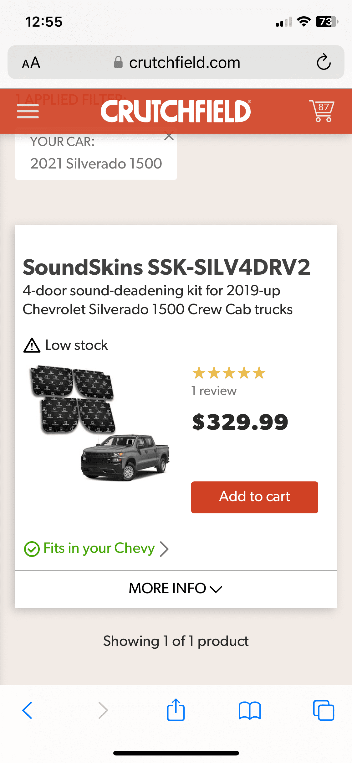

I have that other thread on a system for my truck. I know the answer to the above question is yes but curious what your thoughts were. Crutchfield has a vehicle specific kit for my truck it’s basically a sheet for each door. It’s a few hundred bucks.
Reason I ask is it’s a lifted truck so I get a good amount of road noise and vibration from the AT tire. I’m not willing to treat the entire cab so wondering if just treating the doors will make a significant enough difference to justify the cost and aggravation. Thanks!

Correction was not dynamat it’s sound skins. I like the idea it’s vehicle specific and willing to pay a little more for ease of installation and fitment….

330 dollars is insane for just enough sound deadener to do 4 doors. All you need is a couple roller tools, some scissors and some patience. NO way would I pay 330 dollars for 23 square feet of something when I could get Resonix or Second Skin in 40 square feet packages for less then that.
