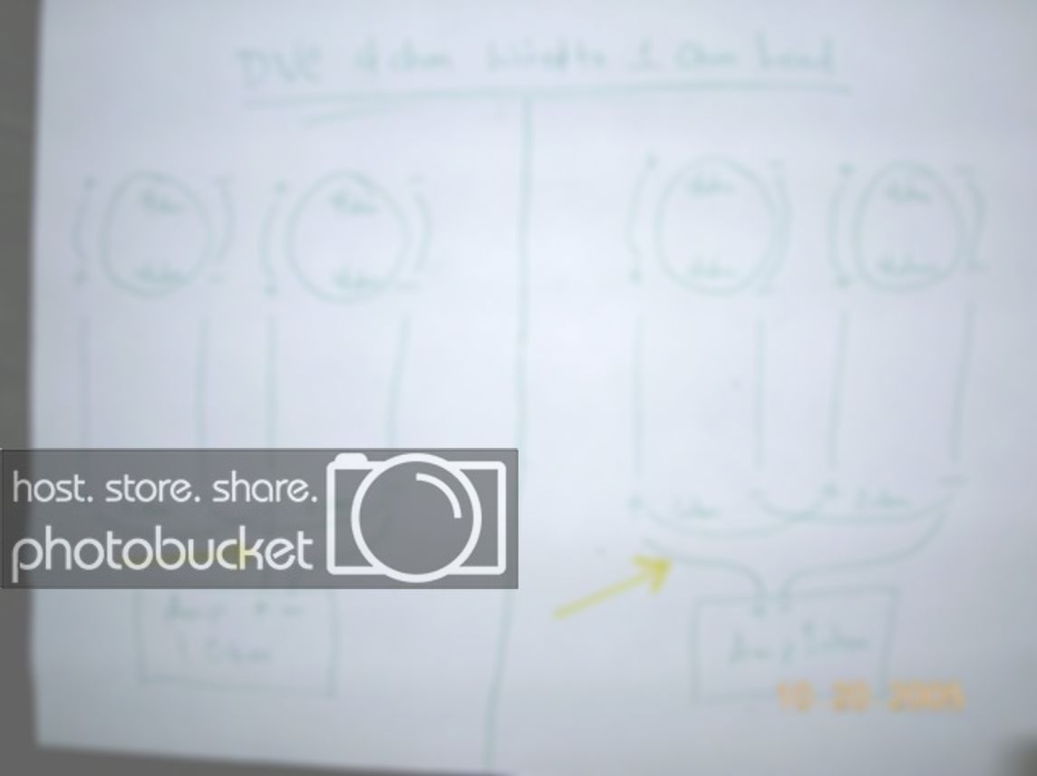

the sketch on the left side is how i was told to wire my subs. i notice the way it is wired the the right sub will get power before the left sub.
the yellow arrow on the left pos terminal can i move that wire to where the yellow wire on the right sketch is so that they get eqaul power, and hit eqaully?
in this image the left sub is going to get power before the right sub. does it have to hit one sub first? why can't it hit both eqaully? can i have that ground connection going the opposite way from the positive so that the ground on the right sub hits first and the positive on the left sub hits first?
in this image the left sub is going to get power before the right sub. does it have to hit one sub first? why can't it hit both eqaully? can i have that ground connection going the opposite way from the positive so that the ground on the left sub hits first and the positive on the left sub hits first?
Stop thinking so much.
Just wire it like it is in the pic. Everything will be fine.
It is basic electronics. Just do it.
makes no difference brother man. Think of it like a sprinkler system. You have one source of water ( Power from the amp in your case) two output sprinklers ( two subs sharing the power ) while one sprinkler is going to be closer to the source, it recieves no more water than the sprinkler farther away from the source. ( You have two speakers that share the power equally, no matter which one is connected first in your diagram) //content.invisioncic.com/y282845/emoticons/smile.gif.1ebc41e1811405b213edfc4622c41e27.gif
