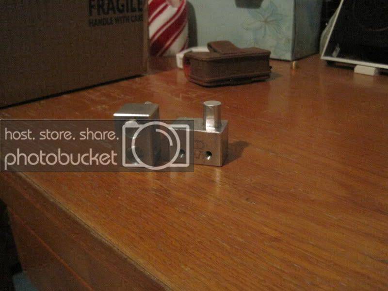

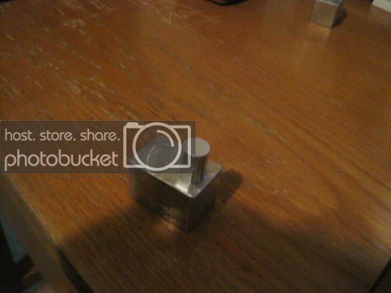

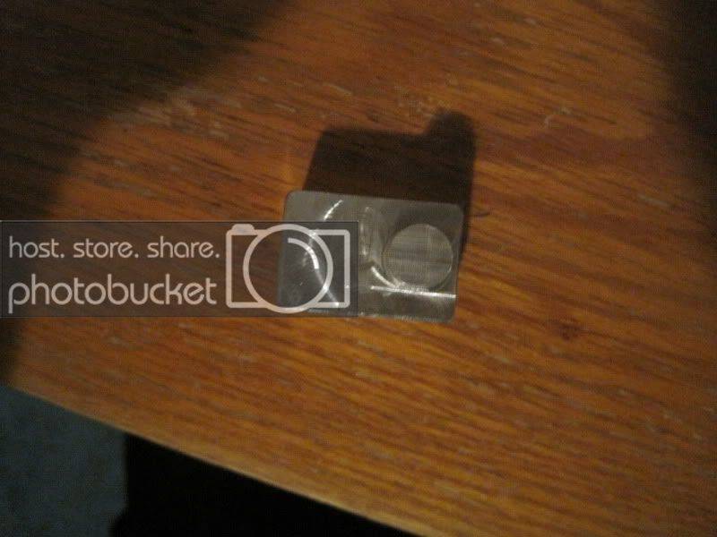

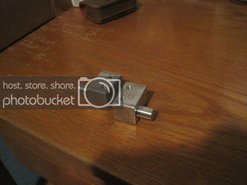

So I got boarded at work, while I was on night shift so I decided to design and make some duel inputs for an amp and i thought i would show you guys some pics! Also I will be giving 2 sets of these to Jacob for spl testing and what not! take a look let me know what you like and most importantly dislike and how i can improve the design.
please note the flat also! i will be making a left and right hand version those are the left hand in the pic and also note the wire clamps in with 1/4 set screws!

They look very nice! //content.invisioncic.com/y282845/emoticons/thumbsupwink.gif.129404938effda6ad9cca39e7f4b58a3.gif
Making them from one piece means a lot of machining. Drill/ream a hole, and press the appropriate sized dowel in instead. Would be much faster, and less material wasted.
A more compact version would simply have a bolt/stud mounted to it that multiple wires could be fastened to using terminals.
If you want to get really fancy, buy a can of that plasti-kote dip that's meant to rubberize tool handles. This would make them less prone to shorting out due to accidental contact with something they shouldn't touch.
thanks man i will keep this in mind for the next set i make up!
the only issue i may have with the dowel is machining the flat on it
and thanks again and i love the idea of rubbing them!!
