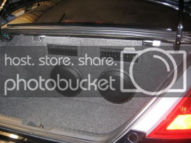

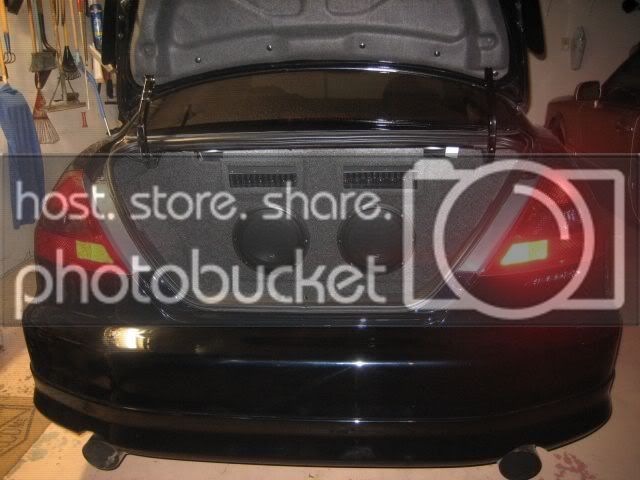

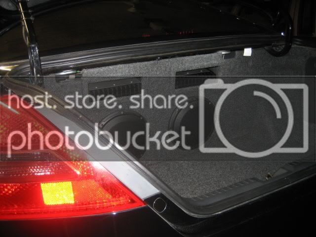

Dual JL W3v3's 10'' Box Build Up Tons of Pics

I had the same problem with my LOC and never got it fixed even tho they had gains on the LOC itself. Props on the install btw I've seen u on 7thgen also. I've got the 4dr lx. Just waiting on the money for a new alt our cars dim like crazy.

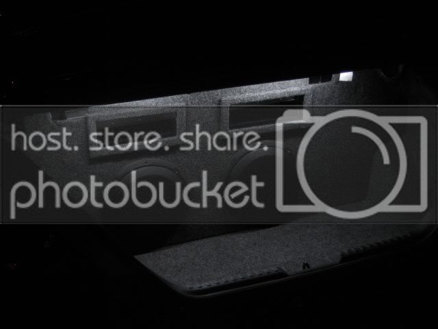

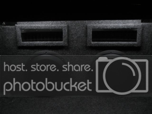

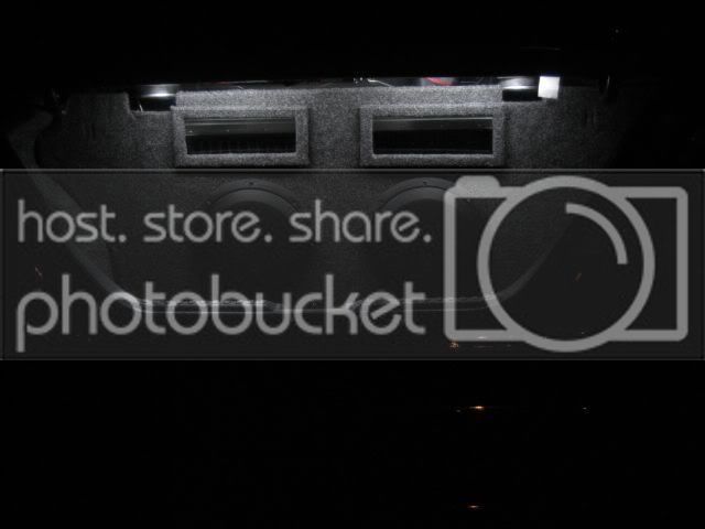

ok all done with the amps plexi and bezels!!, now what color to shine through the inside where the amps are located?
