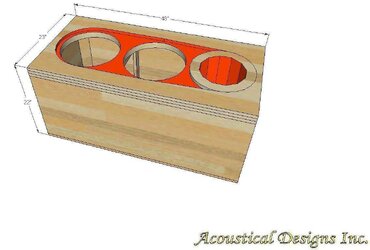

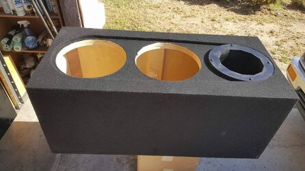

@shredder2 Here is the design and the box when I picked it up.

So to lower hz, the port must be thinner?
I wonder if I can unscrew the port and pop in a new one that's thinner.
If you go to an 8"... know how much power you got and watch the length... it might be tuned hella-low and or have port compression (possibly) unless you pay attention to that.
Looks ok to me as is man ... I'd expect around 8.5ft3 tuned to 32hz or so if it's straight across 10'... btw that's quick and dirty
I'd just drop em' in and it looks to me like a bigger amp would be fine (still got the FSD 3800?).

Builder did reach out to me and said he can make a new Drop-in port. I think I'll do this.
If you extended the port out away from the box you can lower the tuning.
If you cut the flange and slid the flsnge down the port it would increase internal volume while lowering tuning frequency.
Without doing the math you might could flip the port around to be totally external but I believe that would tune it way low into the 20s but I'm not doing the math
