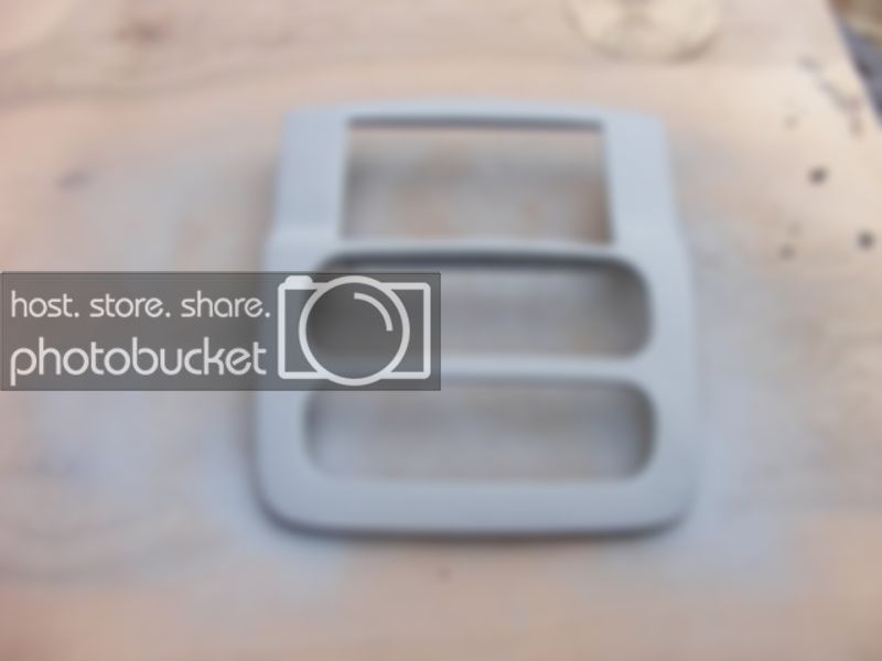

Ok, so i had alota time today to work on stuff, so i got 2 obs done i needed to go for some local guys. This one first, Double din dash conversion in a dodge ram.
Started out with the factory bezel, cut to make a double din kit fit and inserts of the side and glued them in
Masked off the lip of the kit and applied some filler, i chose to do the whole panel because it is all being painted a new color.
3 hours of sanding later and its ready for paint, i touched up a few spots after this pic
primed
I got it finished today, pics are not working for some reason ill post them up of it installed when i figure out why.
