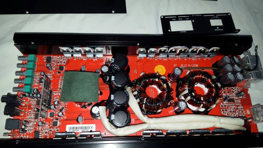

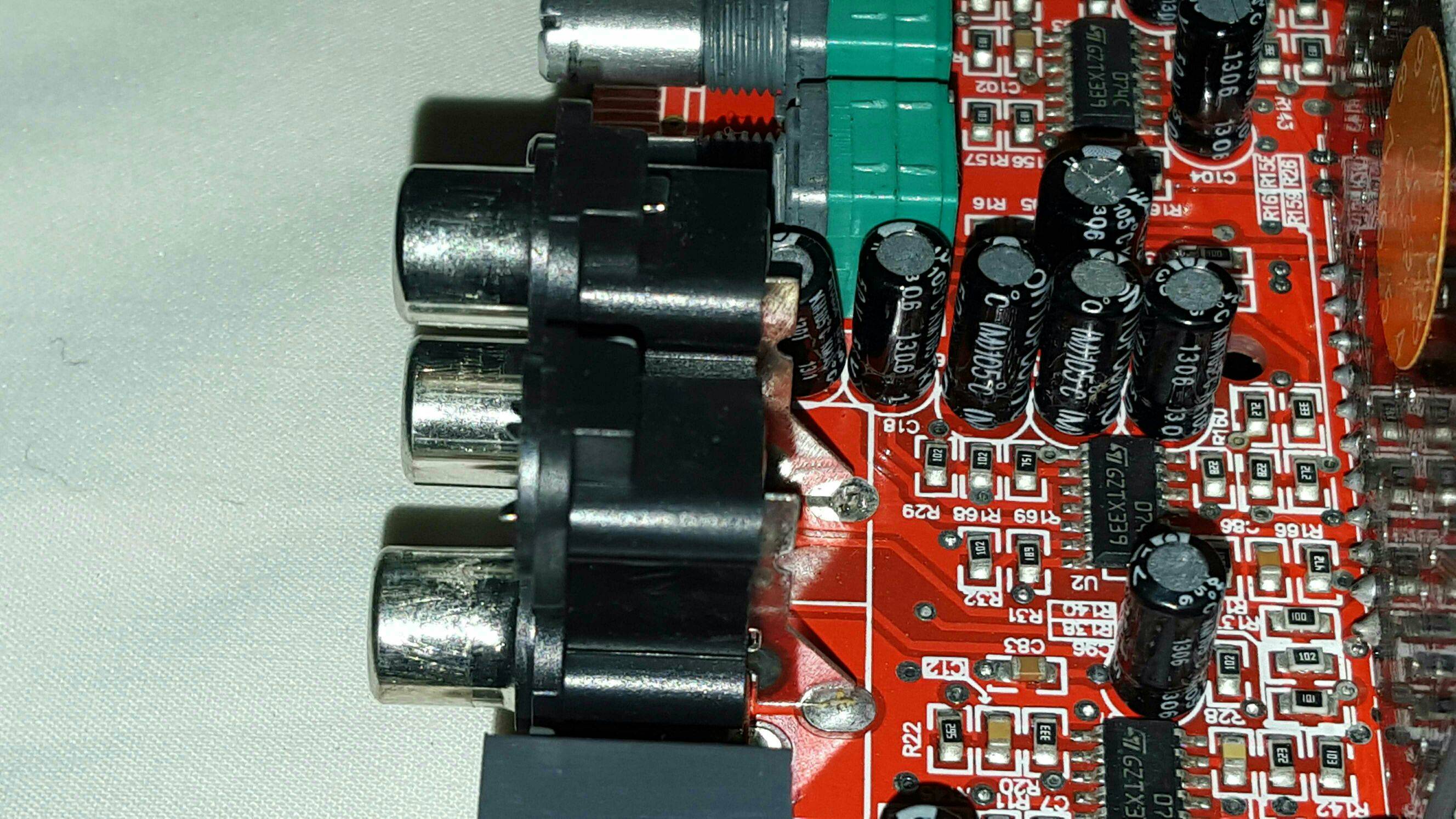

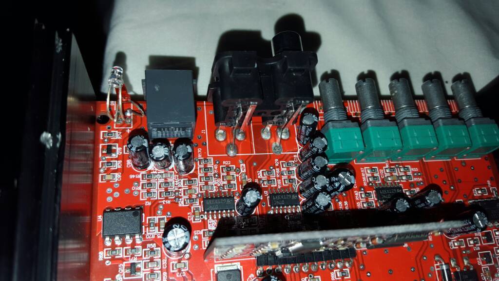

It's a relatively simple solder job. Open it up and find an acceptable replacement on parts express, digikey, or jameco. Then bring it to any half decent electronic or appliance repair shop. It shouldn't take more than ten minutes
that doesnt look too bad at all, you just need to make sure you have two hot solder points for the signal and the reference. looks like the prongs are still there and not broken off with part of the board.
