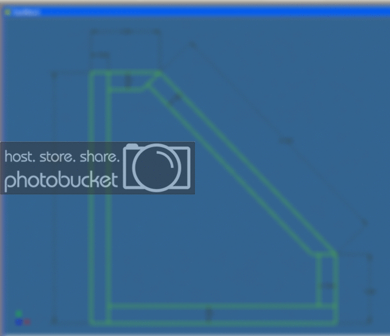

This is the first box I have ever tried to design. The sub is going to be an Rl-i8 which the site says needs 0.6cubes sealed. Does that mean 0.6 without the sub in it or X-(sub driver volume)=0.6?
I'm guessing that I will go with sealed since I want the best SQ and also because tuning a port on a box that small would be hell for me //content.invisioncic.com/y282845/emoticons/crazy.gif.c13912c32de98515d3142759a824dae7.gif
Will this box design work?
Is is going to be a ***** to build?
This picture is the end of the box on both sides. I chose .75in MDF in the drawing, that is what most of you guys use right? The surface area of what will become the airspace once depth is added, is 0.411 cubic feet. Which means it will have to be 1.46 feet long to get the .6 volume I want. What about those overhangs where the 11inch piece and the two 3 inch pieces meet, is that a problem?

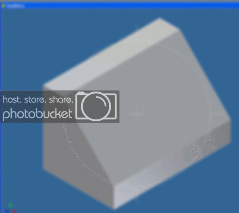

This is what it will look like solid, with the sub in the large face in the front...
What do you guys think?

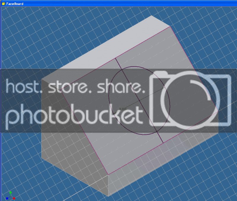

Sure but if you cut the whole according to the drawing you are going to have major problems . Im guessing you did not mean to make the cirlce so big.
At first I was worried about the magnet hitting the back of the box but I took some measurements and I checked the clearance for the magnet and it will fit just fine.
Acoustically is the design poor in any way?
I really need everyones help here...
Ive heard sqaure gives the best sq. My opinion......in a sealed box a normal person would not be able to hear the difference in the shape.
