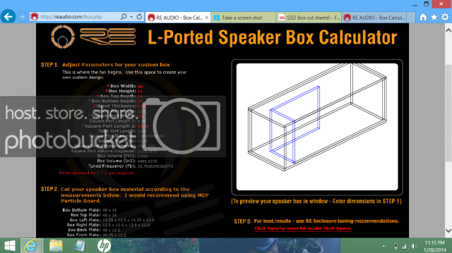

does this design look good? or start over??
deez283
Trying to get my box plans so I can build in the morning, after coming up with this box I read the re calculator is no good...
Could somebody please tell me if this looks like a good design?
Subs to be used are two JL 10w3v2-D6 powered by BK1300.1d and vehicle is 1 02 envoy.
Any help would be great
Thanks
do not use the re calculater. everything is off about that design program, the cubic feet, port area, tuning and almost everything else. downkoad torres box calculator and google sketchup. design the box using torres to get your general specs and then make a mock up design on google sketchup and check all the math manually.
