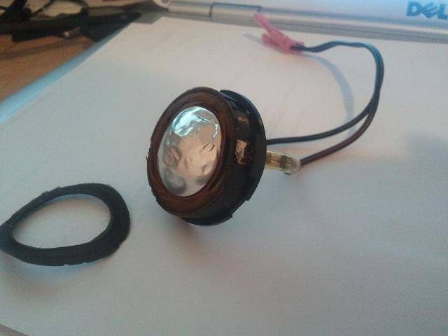

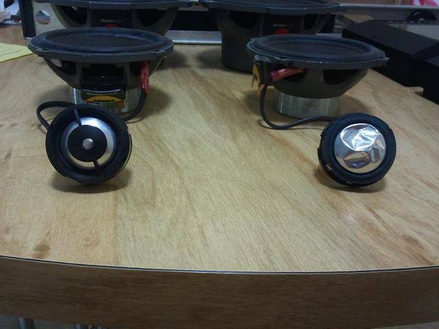

I have a set of Boston Acoustic Pro Series 6.5(3) components that were given to me by a friend. I love the speakers, and would like to incorporate them into my Syclone build. However, one of the tweeters is pretty messed up:
Contacted BA and they said I'm out of luck on a stock replacement. They suggested an alternative set, but I would like to see if anyone does tweeter repair. I know subs can get repaired, so why not tweeters, right? //content.invisioncic.com/y282845/emoticons/smile.gif.1ebc41e1811405b213edfc4622c41e27.gif

You can fix them yourself with a tiny fish hook and some super glue. Bend the hook straight and stick it in the middle of each bump, pull it up then out, ofcourse itll leave a hole there but you fill it in with a tiny dab of super glue. I worked at best buy and had to fix the display tweeters like this all the time.
If youd like to buy new, check out Parts-Express.com sells Speakers, Replacement Speakers, Speaker Building Parts plus HDMI Cables, Home Audio and Video, Pro Audio and Commercial Sound. We offer services for Speaker Reconing, Speaker Refoaming, Speaker Repair. Great selection of Elect they have good quality replacements.
Huh... interesting. Is it going to sound ok when I'm done?
since the tweeter cone isnt experiencing much movement. you should be okay. just be very careful with the glue. you dont want excess dropping into the insides.

So I think I may have killed it... not sure.
There was a small opening on the side of the fabric surround. I removed the fabric, and as gently as I could tapped the cone back out. However, there is a membrane sort of piece that is about 50% torn now (yellowish orange piece in the pic).
I'm going to try to glue the piece back together, but I see a replacement in my future, since this is going to drive me nuts... //content.invisioncic.com/y282845/emoticons/frown.gif.a3531fa0534503350665a1e957861287.gif
