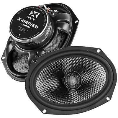

Skip the dash and get these NVX speakers front and rear as they will sound better, much better in my experience, than any of the speakers you have selected. They use Similar polypropylene cones larger magnet motor structures and the tweeter section is handled by a much better silk dome. The NVX line has a good, better, best. The X series is their top of the line, let's go with the mid priced line, in budget and better than all the speakers you have put together;
For the 6x9's and right now available directly from NVX:

And for almost the same, (only $40 more, than the v series and usually $80 more) go with the x series with carbon fiber cones and German silk dome tweeters!
6x9's are $40 off
6.5's
Going with the X-series blows your original selections out of the water and is still less than what you would have needed to spend for your original selection. One of the benefits of using my 40+ years in audio in forums like this is I am not a seller and my motivation is to give you information that provides you with better options that don't cost you more and will perform MUCH better.
