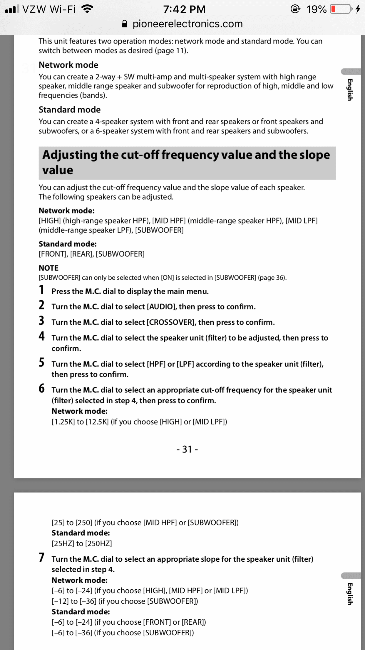

Do I need amp with specifiacally bandpass on the crossover for active 2 way front and sub channel
  • Thread starter BCotrell
  • Replies 0
  • Views 710
BCotrell
5978
This is my head unit filtering options will an amp with just variable hpf/lpf/full for ch 1/2 and 3/4 work (not both at the same time).
