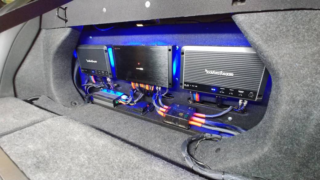

My build. I did all the work but I took it to a local shop to get the gains set properly. The Kenwood amp is amazing.
