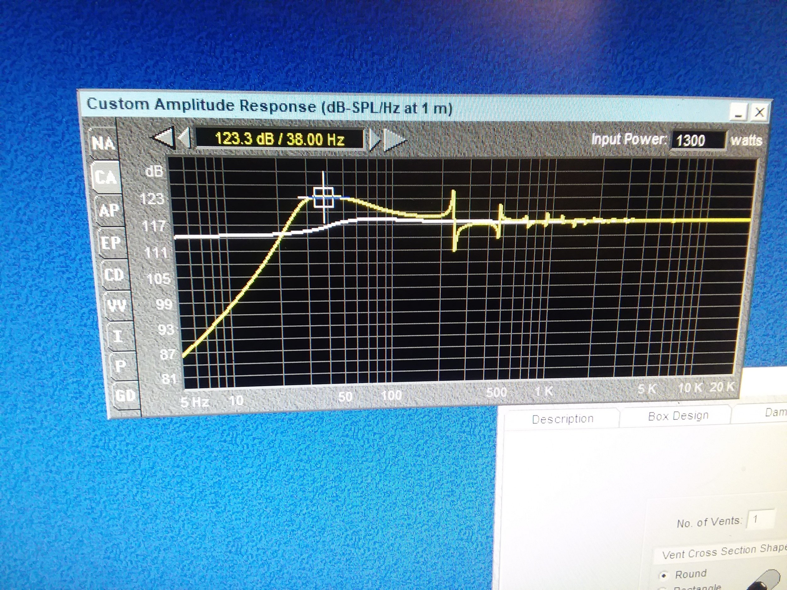

It's typically a smaller ported box than most go for since most go for spl ported but you'll still get more output then sealed.You can run a small ported enclosure tuned for rock music and get that hard hitting sound you're looking for. You can see from the graph that kick drum is going to hit a lot harder in the ported box. 2 demon 10s both in 1.8 cubes one box is sealed the other is ported (yellow). Cabin gain was added. The ported box is tuned at 38hz
