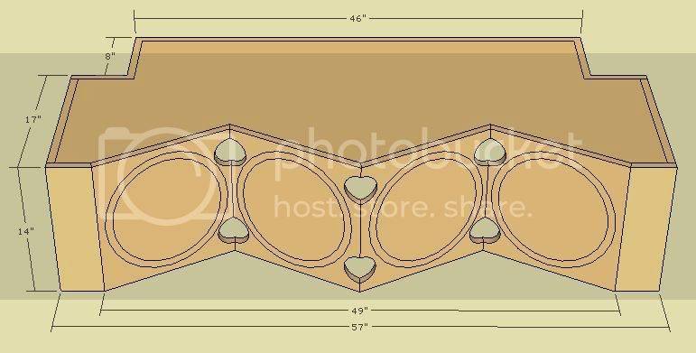

I'm just going to show what talking about purely from a concept perspective:
Looking at the front baffle area given for the width working with, the subs would have to angled as such to fit them all and for the minimal angle to be used not to eat up volume and still fit the subs.
Porting wise, best that can be done here is use 6 - 4" dia ports which is 75 sq.in. of port area. For the tuning Kicker spec's given the volume of the enclosure cal's out to 44 hz port tuning.
Those 6 - 4" dia ports would be 10" long.
The only thing unknown is the power, but, if each sub got 750 watts with those ports, there is no port noise.
THAT would be Perfect. I love the way that looks. That's ideally what I was considering, but with the 2 center subs straight, but that would cause the face to be further back, and the 2 angled subs to be more steep, so then the depth would be GREATLY reduced.
Yes, correct. The outside subs would have to be at a much greater angle to allow for the two inner subs on the flat panel to be much wider to fit the subs and the ports and deeper back into the enclosure. That would also reduce the volume even more, thus would require the volume difference to be had by increasing the enclosure size some where else in the design.
With the above design, all that needs to be done is gain another .50 cu.ft. and it's a done deal.

what if we went back another 2"? Think that would compensate?
If the center portion was increased from 8" to 10", that would solve the volume issue. Actually, it would give the design 8.48 cu.ft., more than enough when factored in any bracing displacement added to the enclosure.
