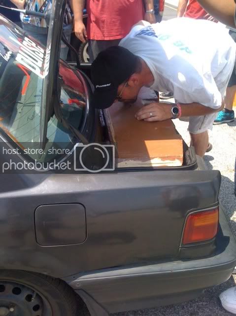

After seeing a 1986 honda civic pount out a 151.x with a couple of twelves and a big port at slamology, I would suggest what he did.
the twelves are off to the sides of the box and in the middle he had a 10" port about 15" long. Oh, and that pic was taken by me about 3 minutes before this won loudest trunk vehicle in the world at Slamology.
Was that title just for the Slamology event? I have seen a vid of a 8th gen civic doing 155s out of the trunk on music. And I thought I heard there was someone doing 157s out of the trunk as well that was the worlds loudest trunk.
