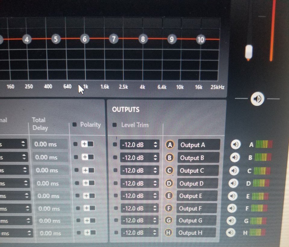

What are the "dB" values at the end of your list here? Again, somewhat of a newbie in setting all this up, I'm learning as I go. Where do you set these values, DSP? I only have this column I can change the dB values. Should this be where I set my sub to 12, midbass to 24, etc...?
29145
Thanks!
EDIT: I just realized, you probably meant as in dB of the crossover slope, correct?
