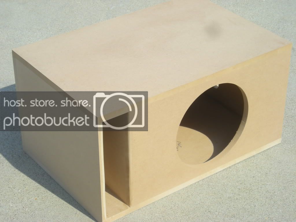

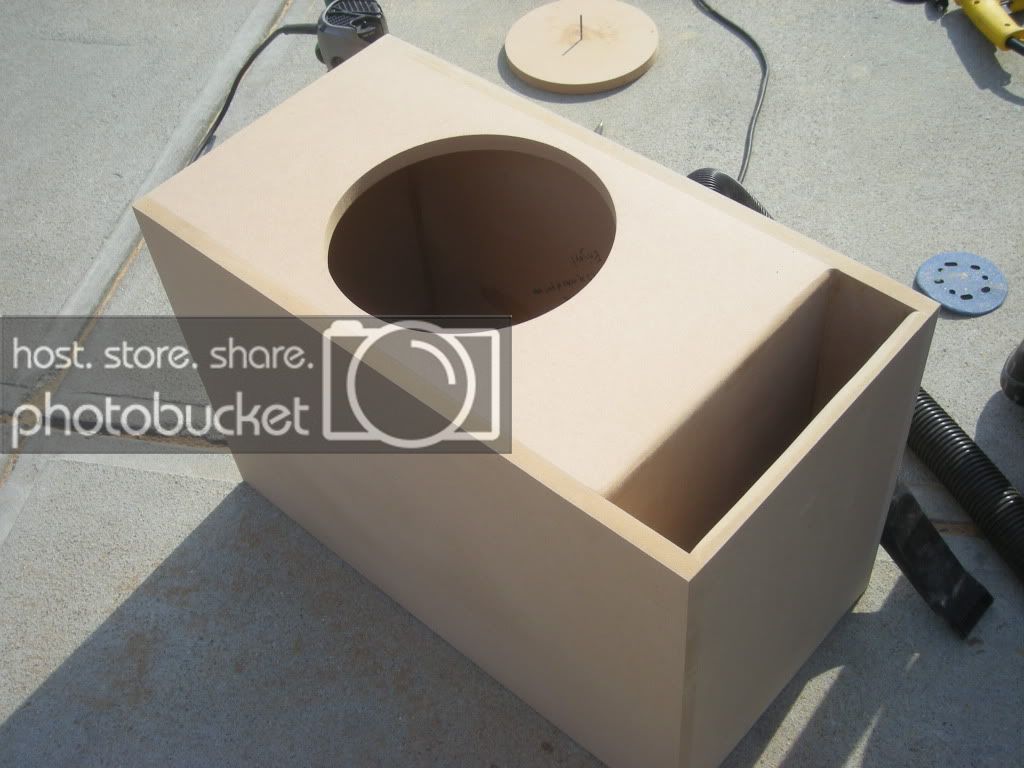

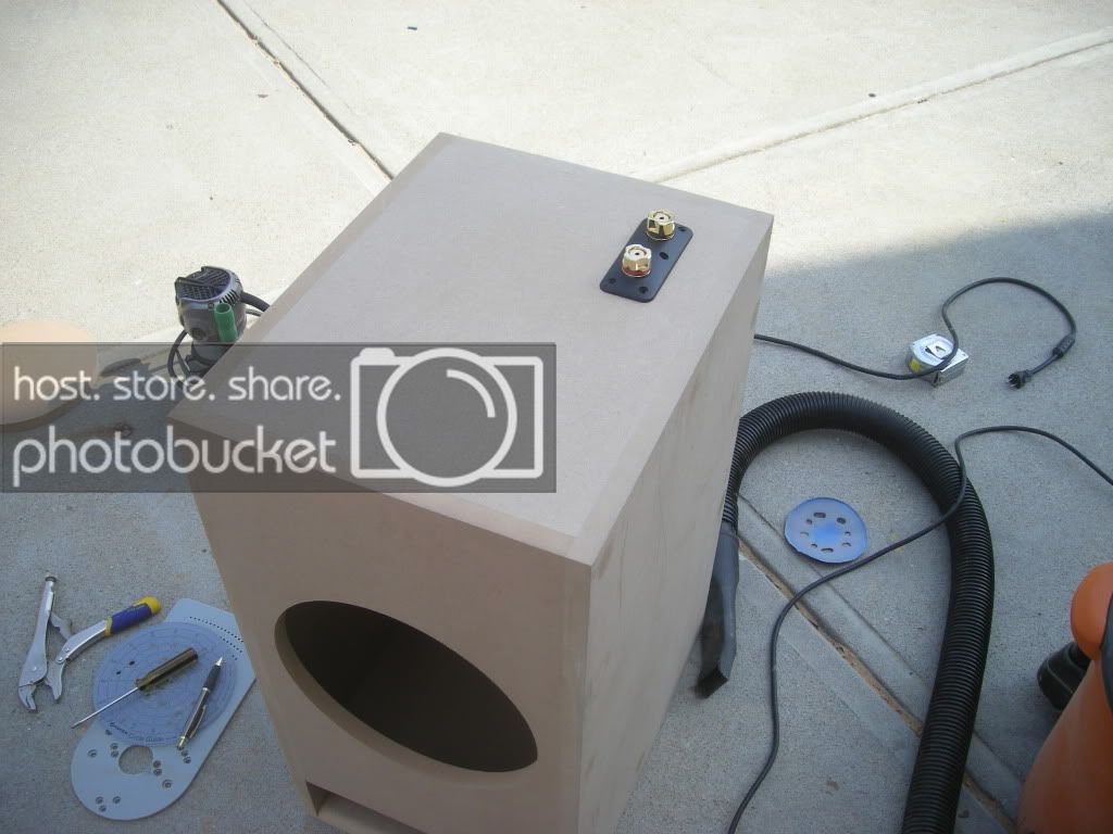

Here is the finishing up...

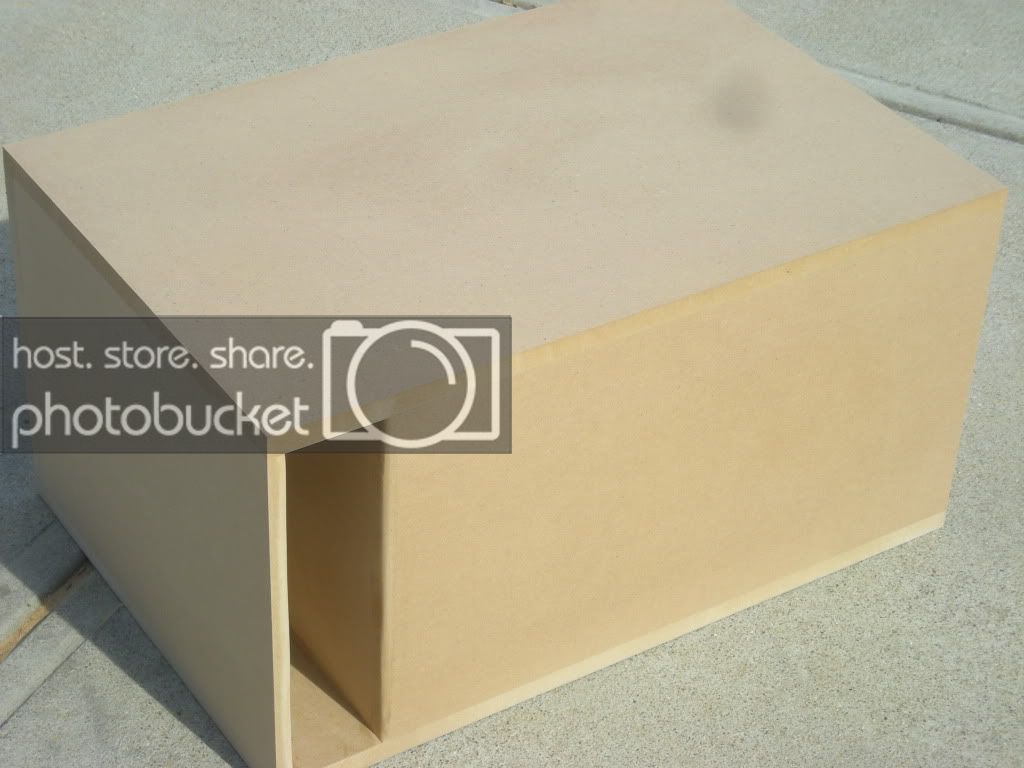

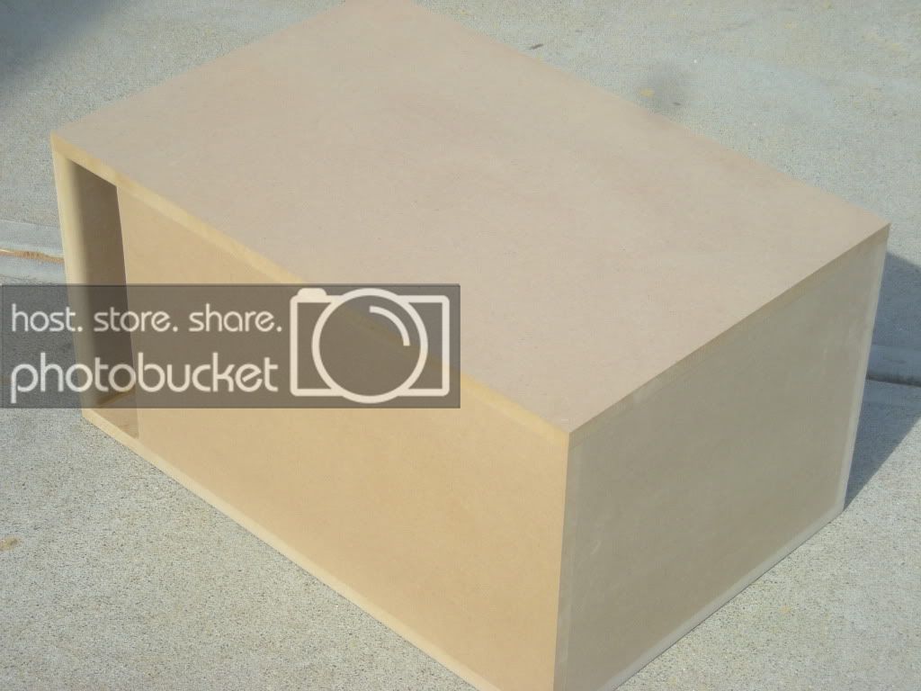

Got the top on...

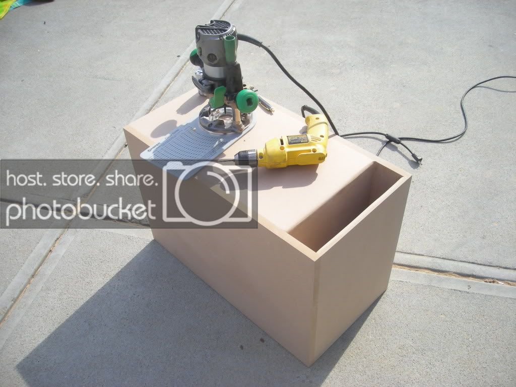

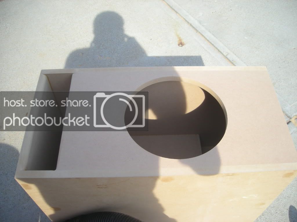

Getting ready to make the cut out..

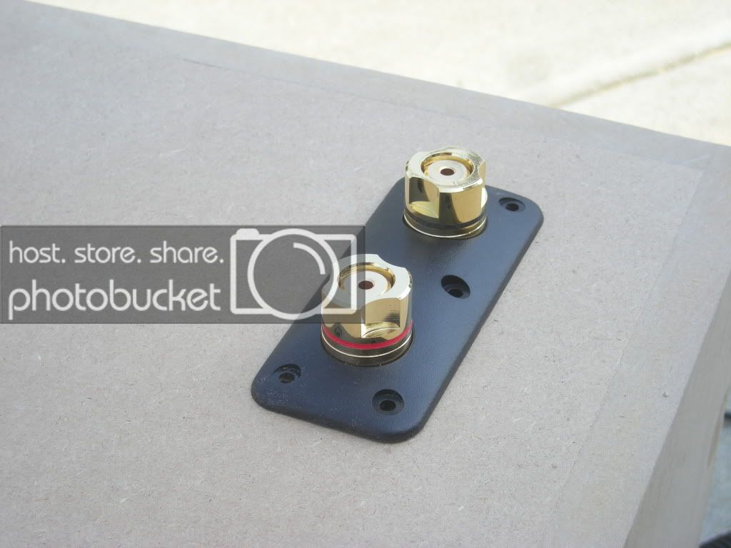

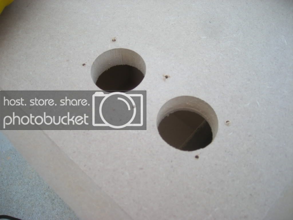

Terminal cut out made..

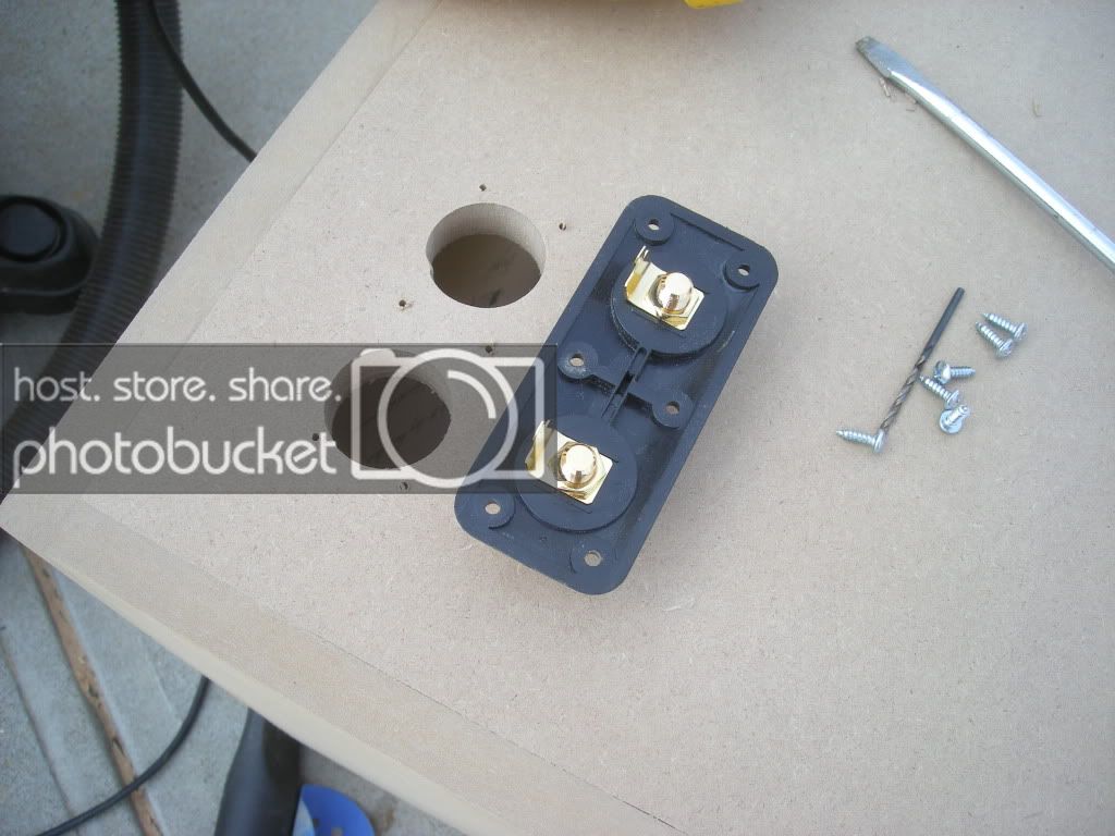

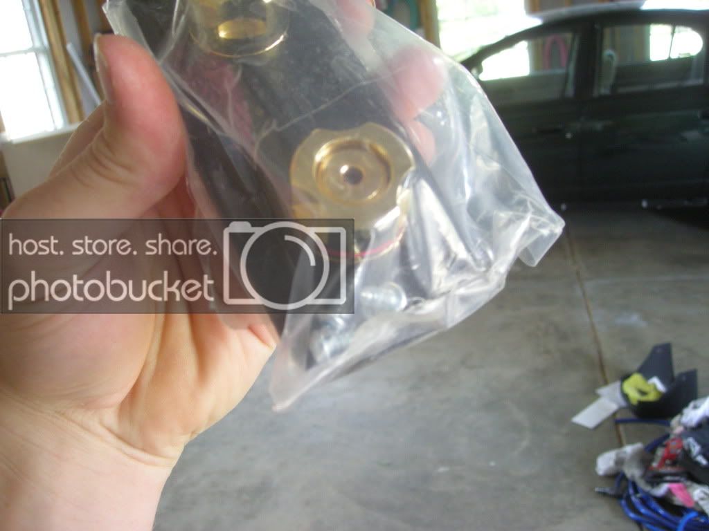

Packaged up the terminal with the 6 screws for mounting because it sticks off the side a bit and I could just see it arriving with the terminal broken/destroyed so I put the terminal and the screws in a bag and taped it securely to the inside of the box...

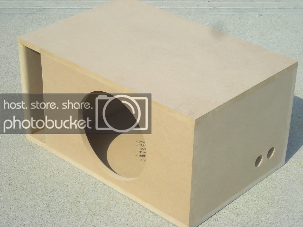

Finished //content.invisioncic.com/y282845/emoticons/smile.gif.1ebc41e1811405b213edfc4622c41e27.gif

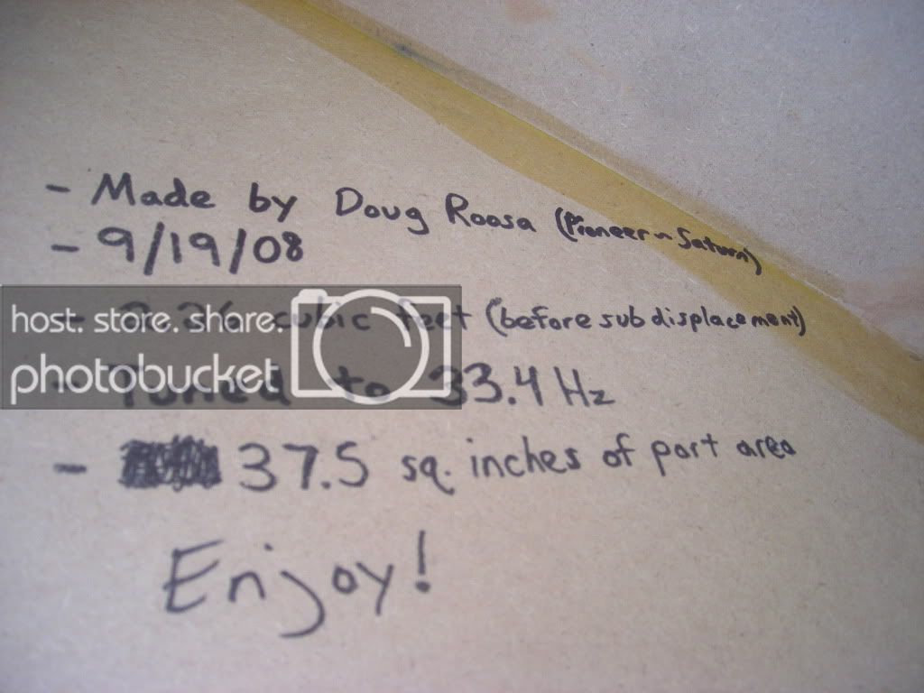

The info inside the enclosure //content.invisioncic.com/y282845/emoticons/smile.gif.1ebc41e1811405b213edfc4622c41e27.gif...
And sue bee...I didn't get ahold of a dvc terminal cup, but this terminal will be able to have pretty much as much on it as you'd like. I would run 8-gauge from your amp to the terminal, then (before securing the terminal to the box) undo the nuts on the back of the terminal and get ring terminals that will fit around those and secure the nut down over them and then mount the terminal.
I had a local audio shop try to charge me $80 + tax for a terminal cup like that. I Lol'ed //content.invisioncic.com/y282845/emoticons/fyi.gif.9f1f679348da7204ce960cfc74bca8e0.gif $12 seems a bit more reasonable.

And you can get those at partsexpress....close to 12 bucks a piece though //content.invisioncic.com/y282845/emoticons/frown.gif.a3531fa0534503350665a1e957861287.gif but theyre very solid
Thanks man, tis pricey but I think its what I need to get the job done and looking good at the same time.

And no, no screws whatsoever in the whole enclosure besides the ones for the terminal.
As for packaging I go through FedEx and it really depends, this enclosure Im just going to have them do the packaging because I have stuff to do and wont be home to make a crate for it like i did NewAgeKing's enclosure...
And yea, I couldn't live without that jasper circle jig (actually I have two, I have the smaller jasper circle jig as well...for holes 1"-7" I think)
