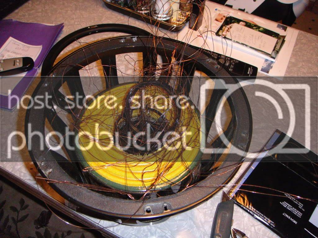

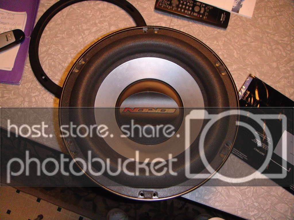

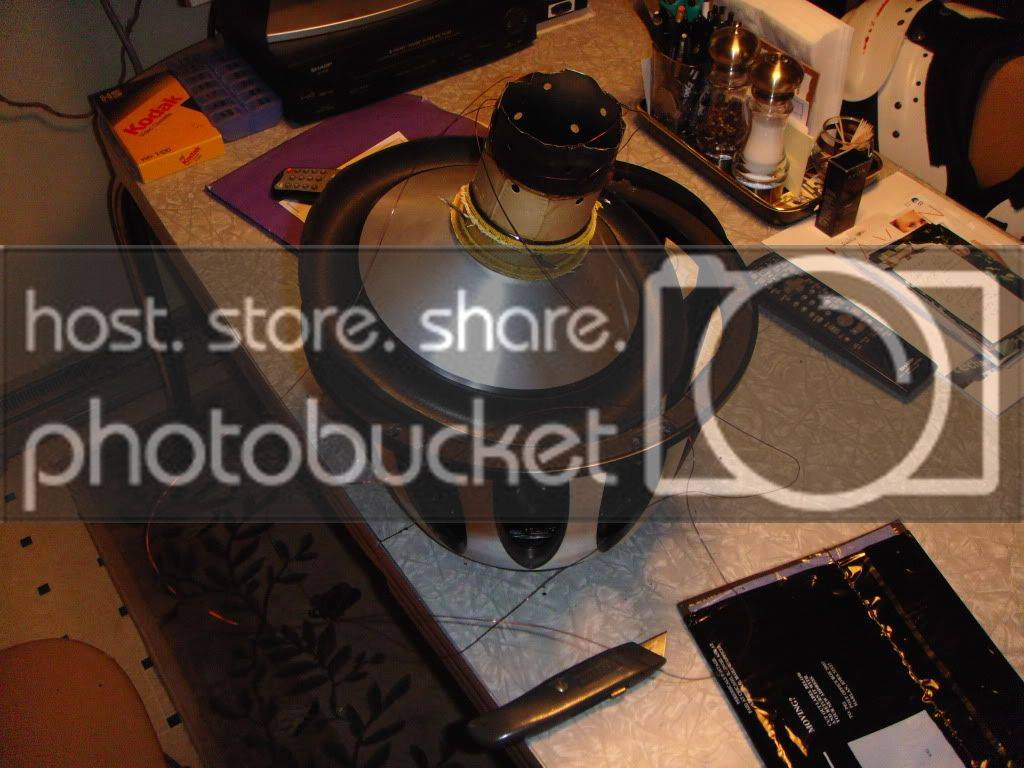

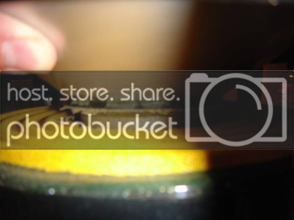

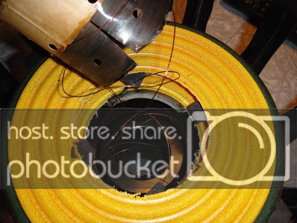

well, i went to a meet not too long ago where i competed in 129 bassrace and took 2nd. on my way home i blew it up, i ran it for about 1 hour straight on roughly 2800 watts give or take. i really didnt care because i bought it just for some daily bump til i get my nightshades back...anyway i decided to swap it out today for a sundwon sa-12. it is like day and night(like kid cudi)off of half the power the sa-12 sounds 10x better and louder overall. so i decided to cut up the orion and have a looks see...here are the results...

it was blown //content.invisioncic.com/y282845/emoticons/fyi.gif.9f1f679348da7204ce960cfc74bca8e0.gif
i put 1500 watts to a sony 12 a year back for about 10 min and it did the exact same thing. I guess the coil gets hot and burns the glue off
