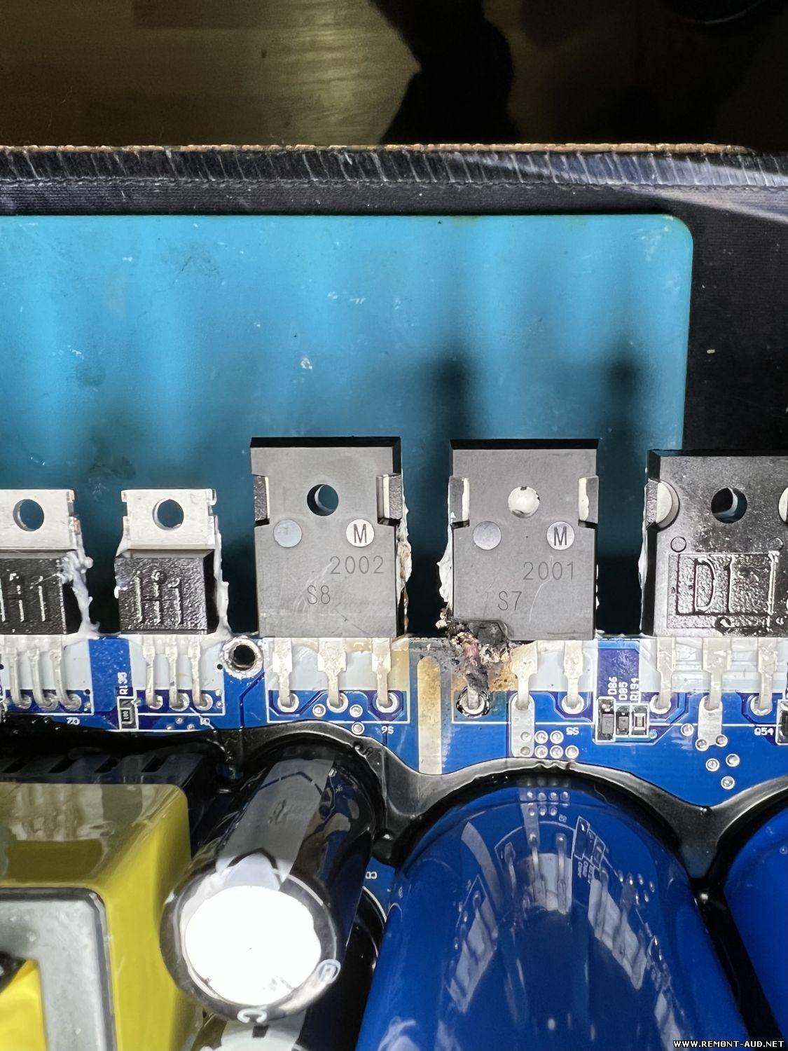

I have an Apocalypse / Deaf bonce AAB-15900.1 basically same sundown audio amplifier
with burned rectifiers
Marking S7 & S8
could you help me to identify these parts?
37288
Thanks!

im ok with servicing that amp, everything else has been fixed already all i miss is a diodes, i know which kind i can use but im not sure which is closest to original
and they selling it long time. no warranty on this one
Thanks for your help man!
the originals are 1640
I can use MUR3040PT & MUR3040PTA / FMG34R & FMG34S or higher voltages
