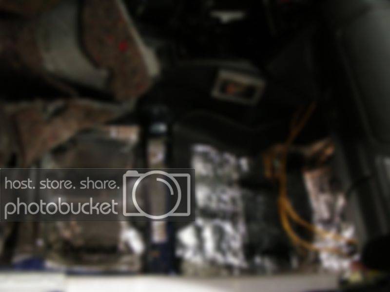

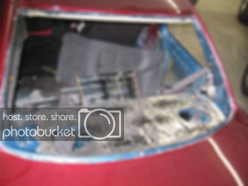

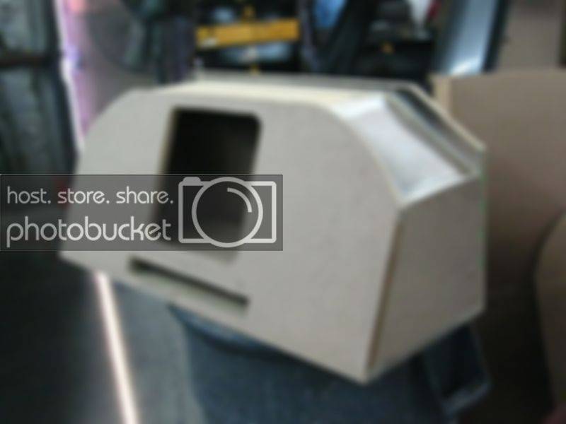

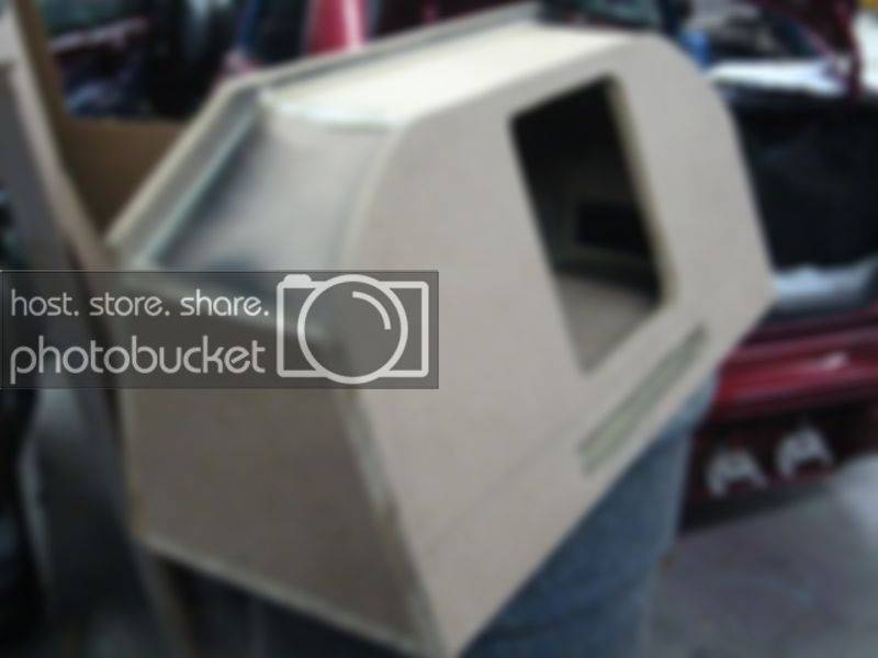

I will get some pics of stuff I tossed together. Glassing can be expensive when it comes to materials. If you could get me some pics of the area you wasnt the enclosure, the max distance from the sides of the car you are willing to go, as well assome measurements, that would be very helpful. Are you wanting to do a total fg enclosure? or a fleece over frame enclosure? Basically build the box for the sub, but frame out the ring for the basket mount then work fleese over it for a nicer look, then fleece over the enclosure to "Blend" it into the car.

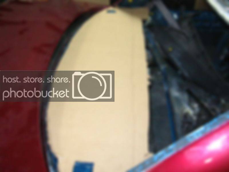

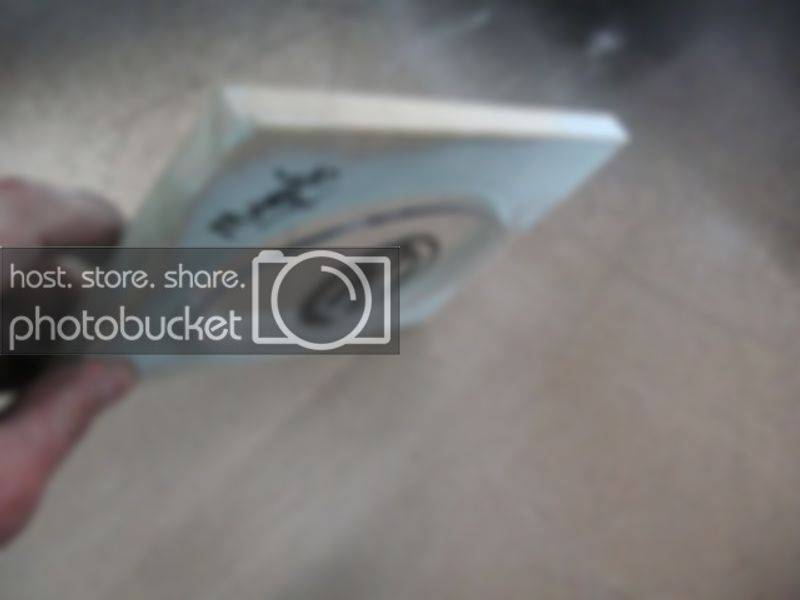

I guess it would be a full fg enclosure. I want to make some test pieces first, I'll look around the garage for a project to get working with fiberglass so I don't ruin my box attempt. I was thinking I will tape off the area in the trunk and lay mdf for the floor piece and then fiberglass to box area in the trunk and use the fleece over the floating ring to make the front. I have visions of covering the front in carbon fiber after I make the fg box to get a cool carbon look to go with some other pieces in the car. I will probably just do carpet though and maybe revisit it later with the carbon. this is pretty much what I want to do : This is the same car and space I want to use.
Wicked C.A.S. :: Magic Boxes :: Mitsubishi :: Mitsubishi Evo 1x10" Driver Enclosure

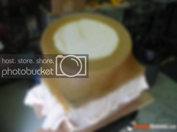

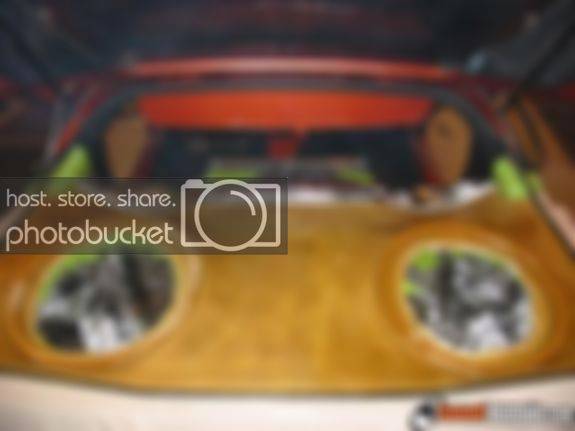

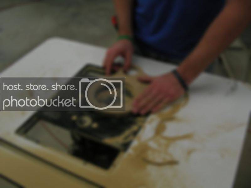

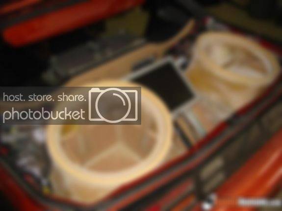

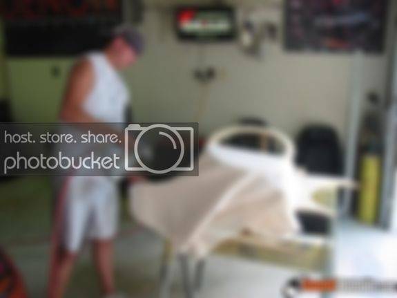

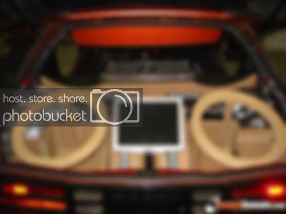

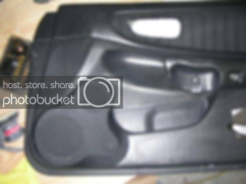

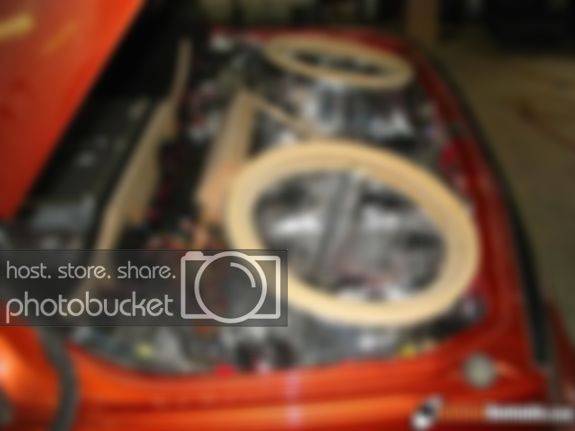

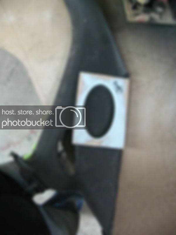

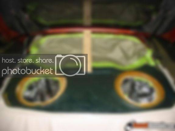

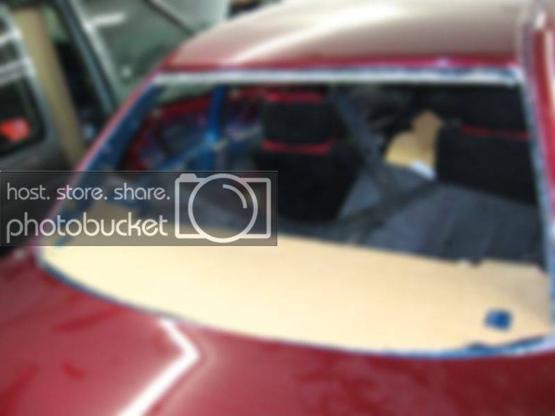

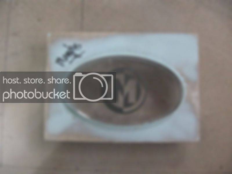

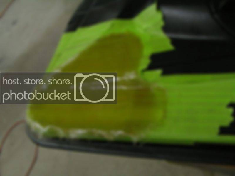

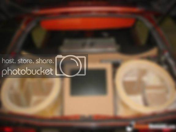

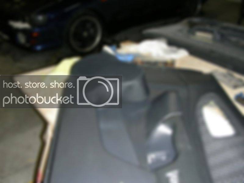

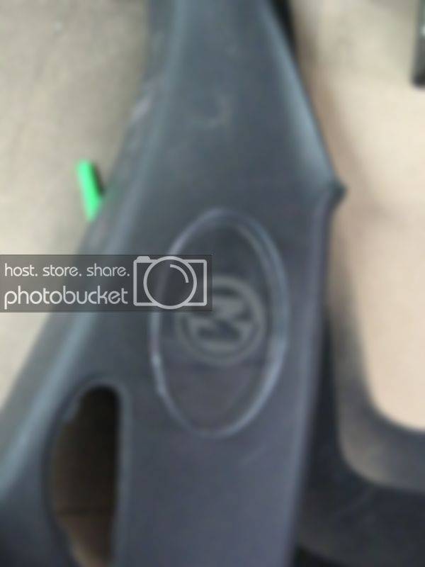

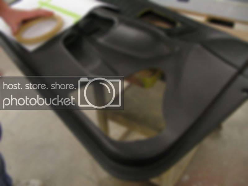

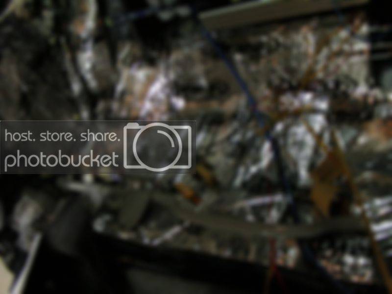

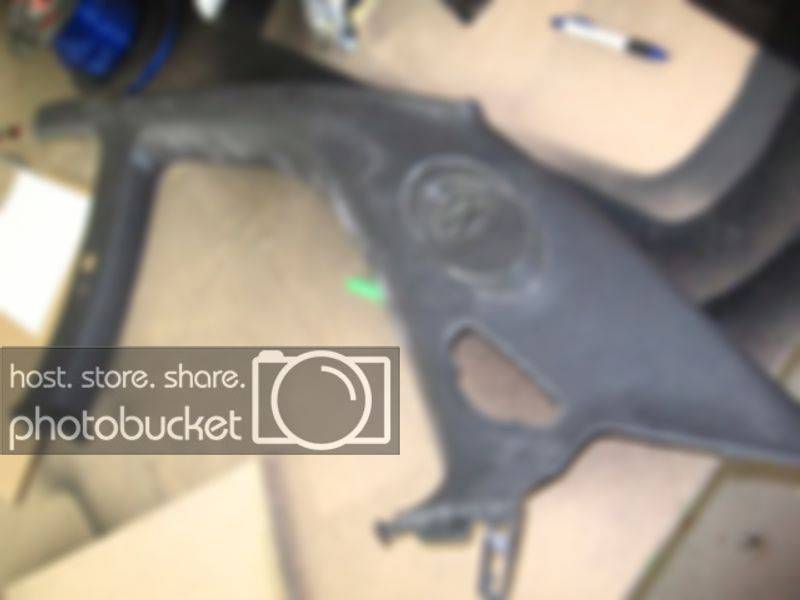

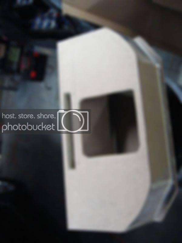

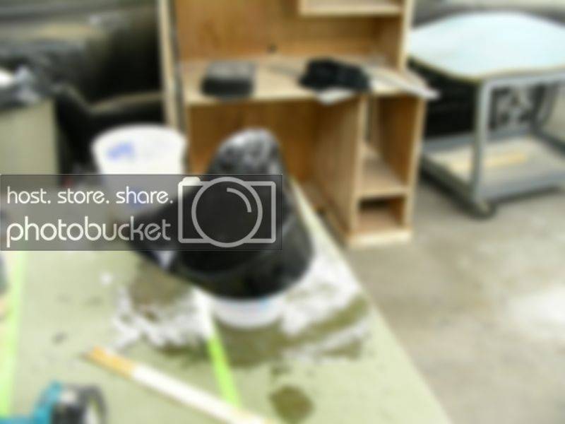

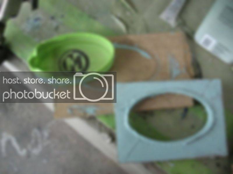

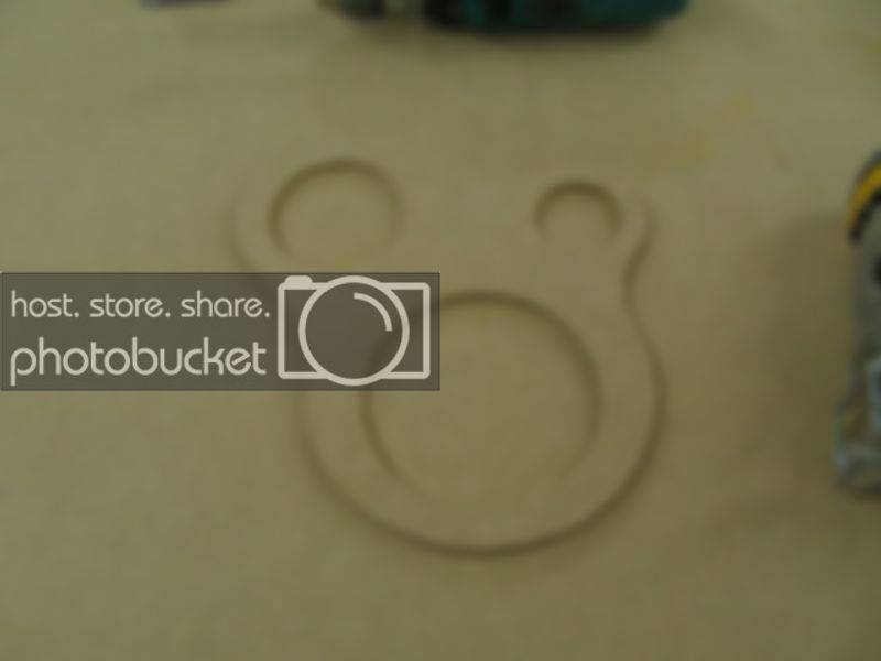

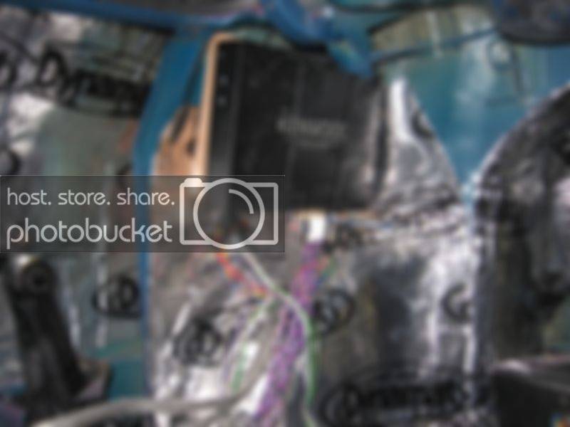

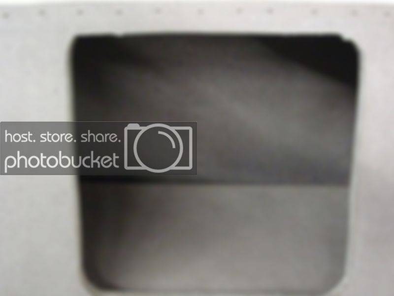

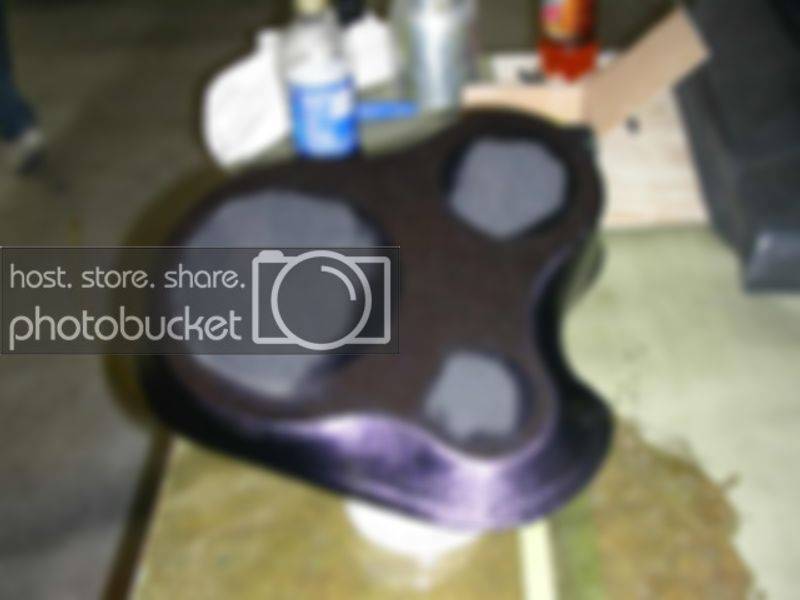

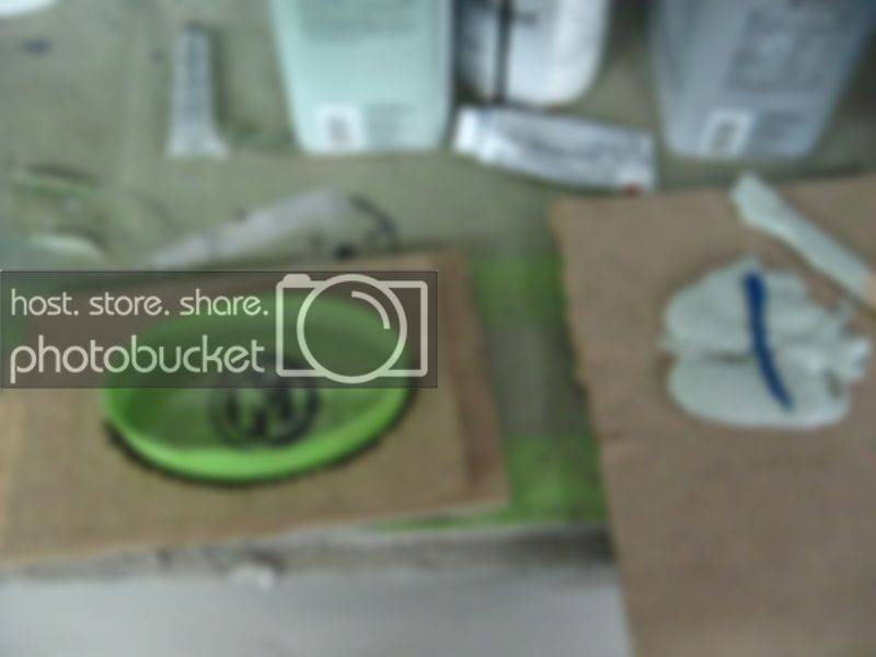

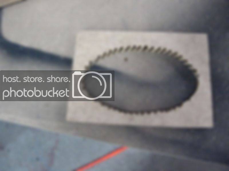

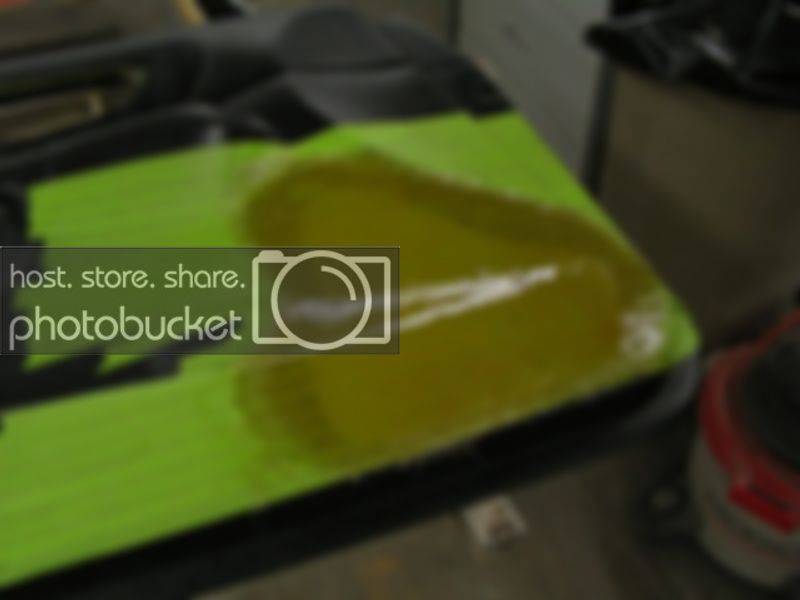

Last enclosure I built that was actually INSIDE of the vehicle. It was made, and glasses to fit perfectly. I included some pics of things to "play" with when carpeting
