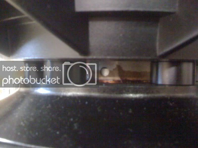

supercharged option is the basket spacer and a neo shorting ring. fyi the white thing inside the pole vent is the neo, i was pressing on the dust cap to show this.

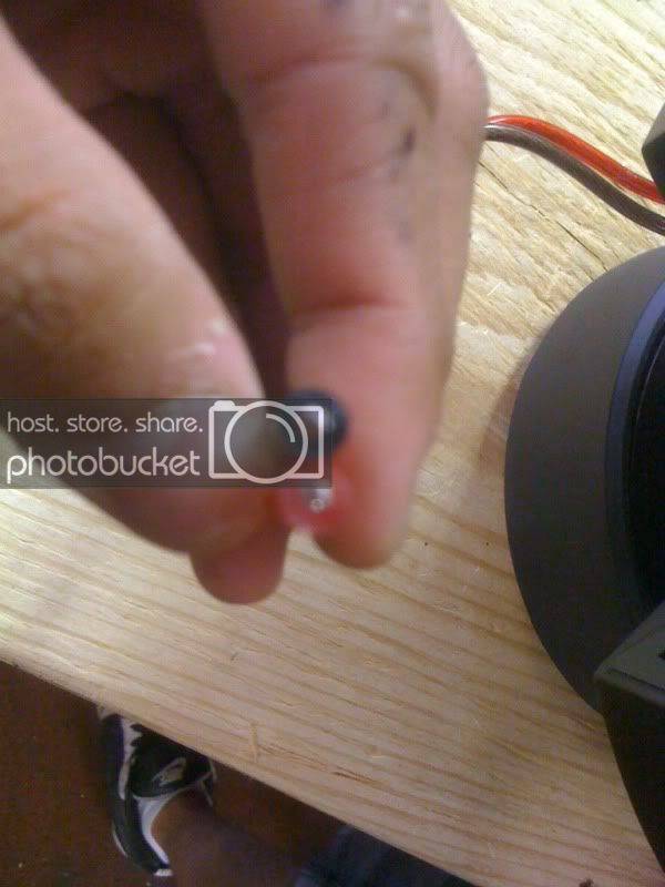

first of is the direct connect wires they used. it looks very cheap and has more jacket than wire

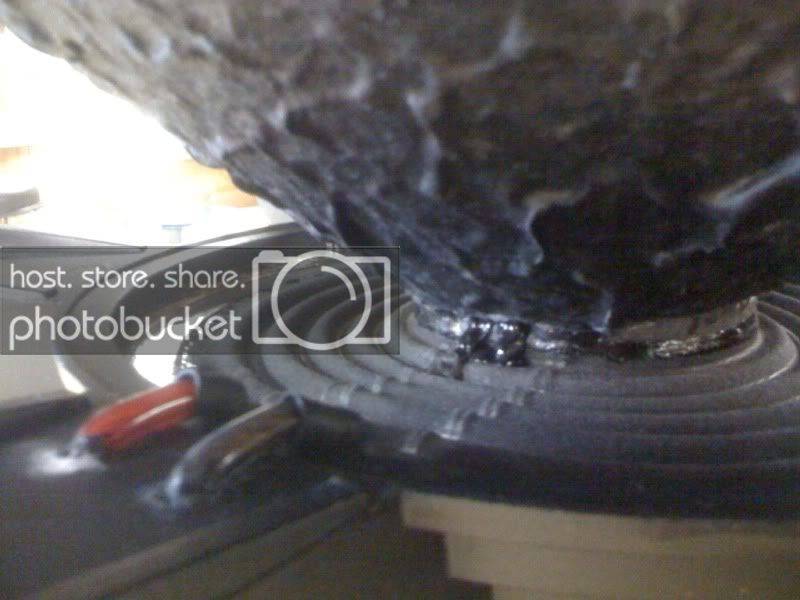

also, look at how the triple joint is glued, that is terrible(IMO)

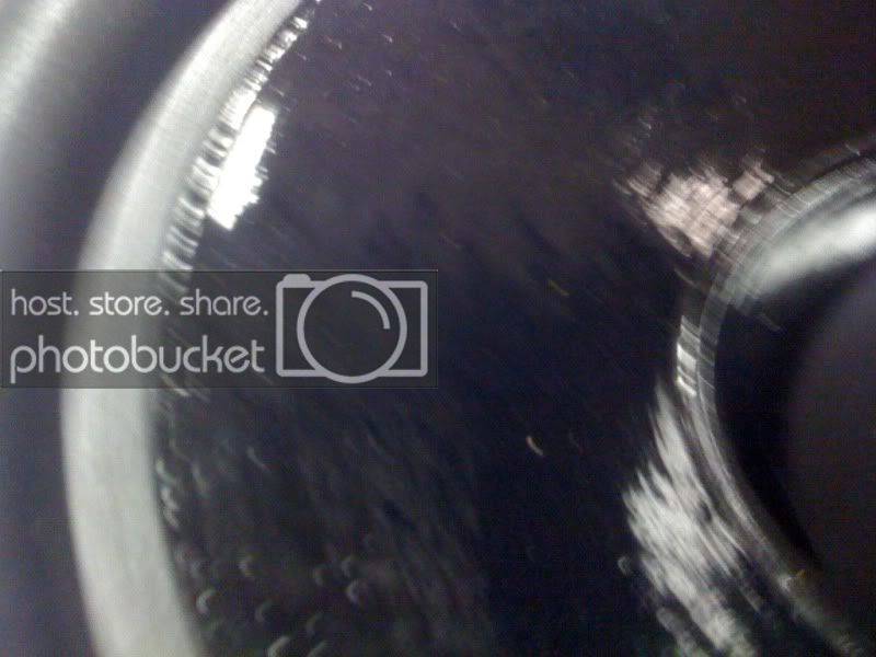

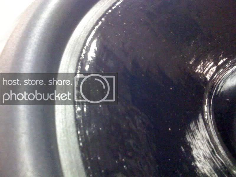

finally, the cone, it is very soft!!!! it really is like wet noodles! i tried to take a picture of me lightly pushing up on the cone
pressed
not pressed
its kind of hard to see because i used a crappy camera.
edit..the SC option is a neo mag on top of the pole and a shorting ring
6 legs on that basket...no? if so, it's an 18". if no, then it would be an old basket that someone paid to have assembled custom on a newer motor. (hope the OP just mistyped that the neo ring was the faraday ring). there is no shorting effect with the location of the shorting ring being above the neo bucking magnet.
