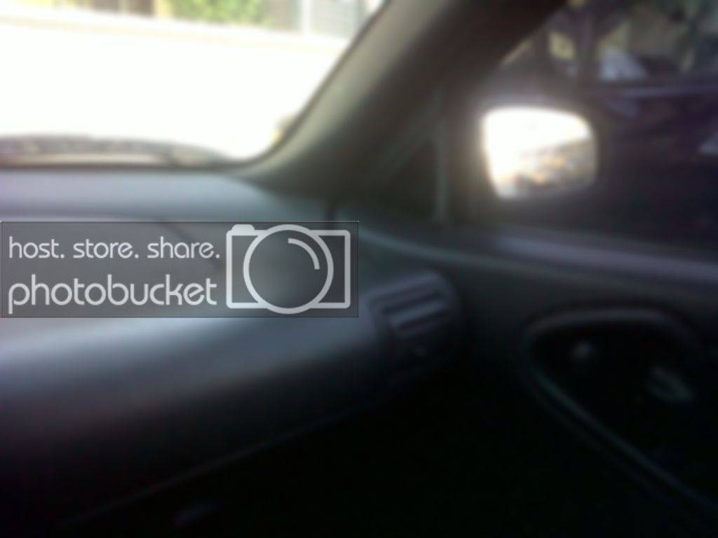

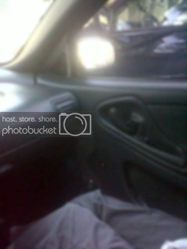

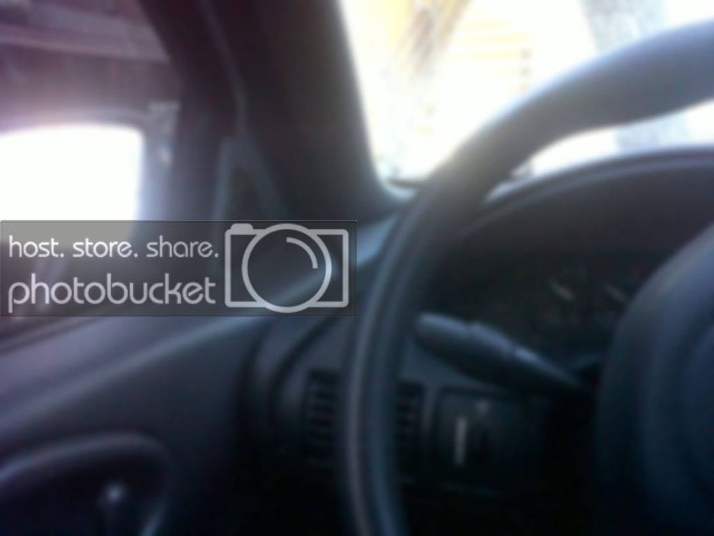

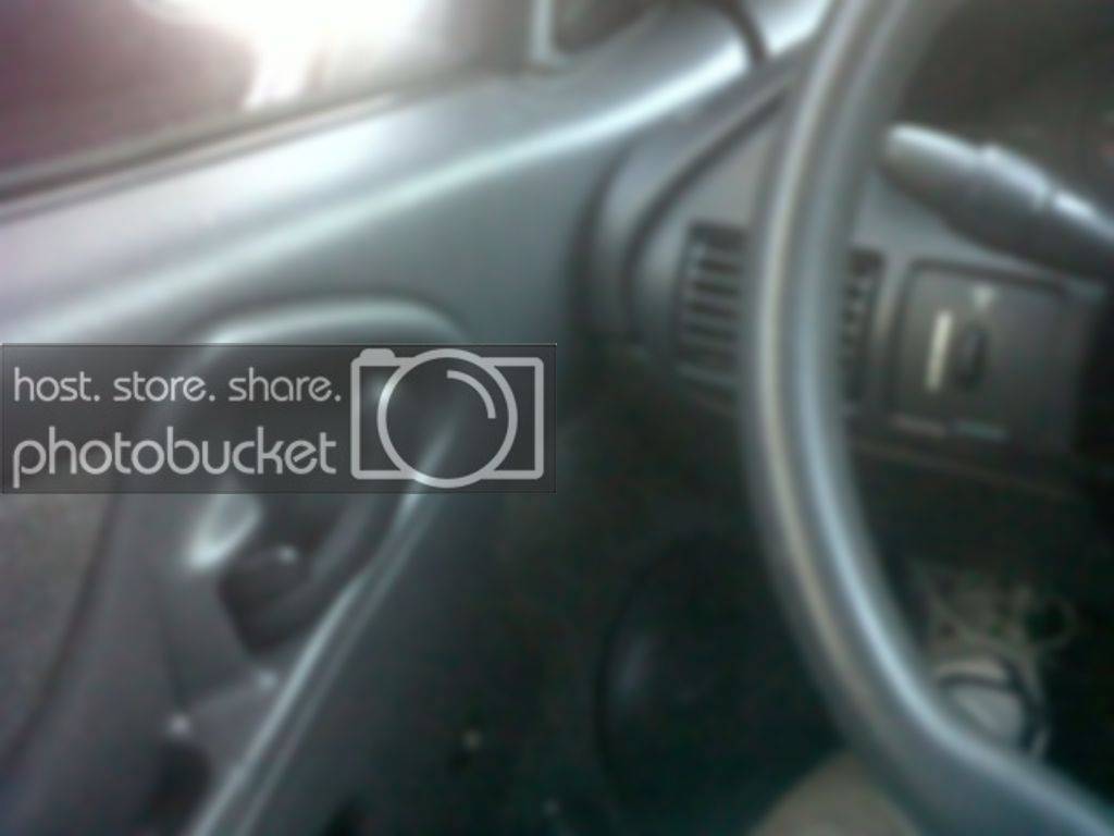

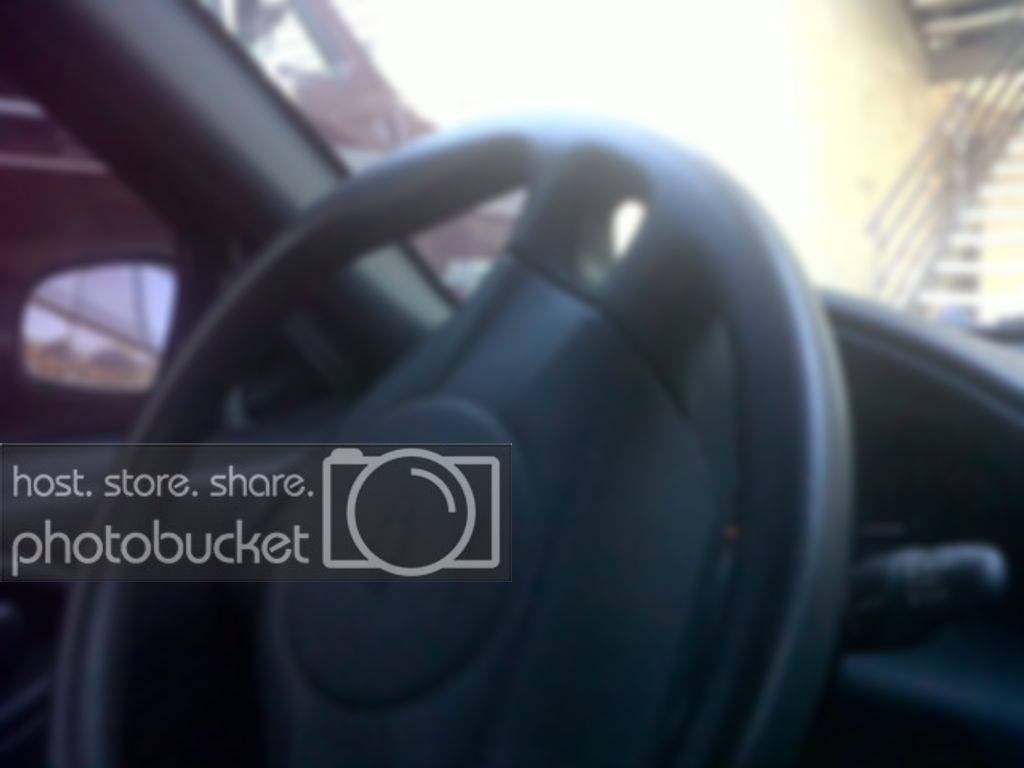

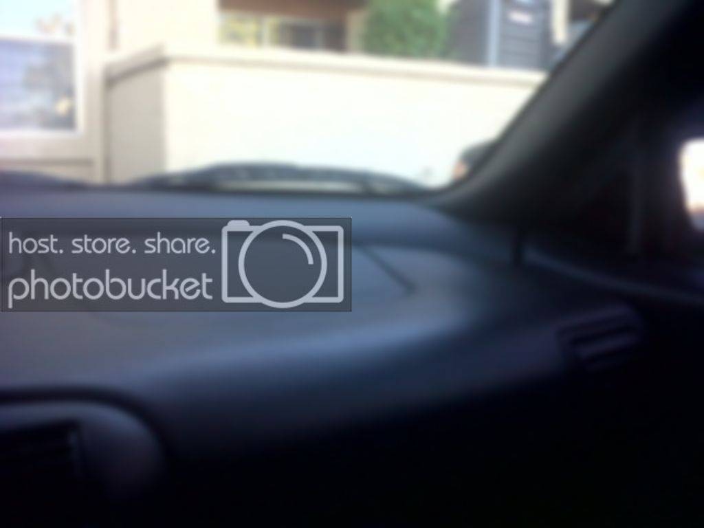

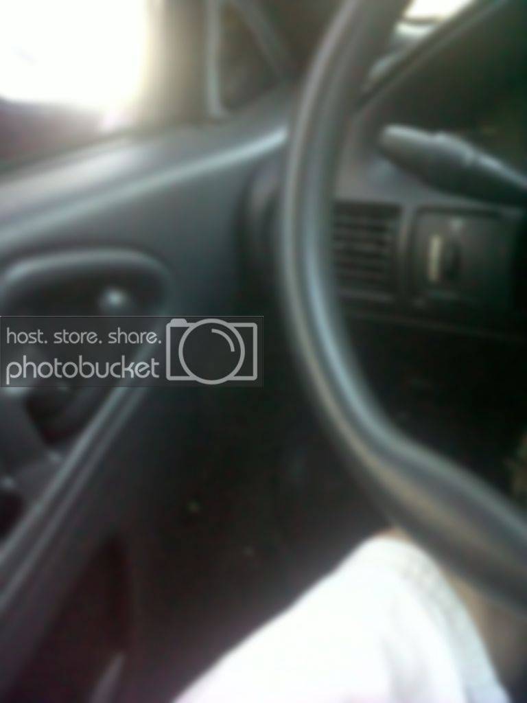

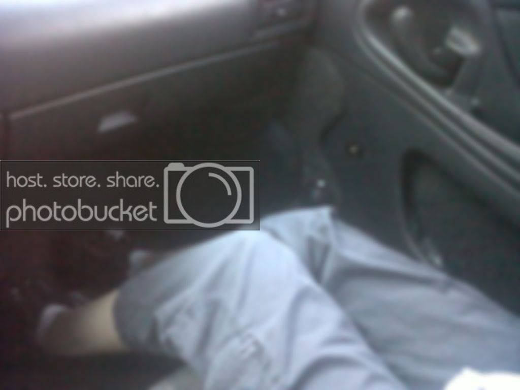

Here are some more pictures so you can see why I hesitated with putting them in the sails. All ideas welcome..
Before you put them in sails are you going to try the pillars?take some velcro & try many different spots before you start to fab anything
That's the first thing I do , break out the velcro for the tweets and the dish towels more the mids. //content.invisioncic.com/y282845/emoticons/smile.gif.1ebc41e1811405b213edfc4622c41e27.gif
I would stick them up on the sails with some velcro and give it a listen. I bet the steering wheel and dash doesn't block that much. //content.invisioncic.com/y282845/emoticons/smile.gif.1ebc41e1811405b213edfc4622c41e27.gif
maybe if I have like a 45 degree angle. I will mess with it soon enough. the overall system sound is pretty good. harmony, nice depth,
I still think the 2"mids might be neccesary to lift the image.
you don't want to separate the tweeter and dome mid. if you get a dome mid, place the tweeter right next to it, as close as possible.
simply raising your tweeters will raise your sound stage. i haven't been impressed with door tweeters. few sail panel installs have impressed me - mostly depends on the doors and how far away the tweeters are.
the dash may block the driver tweeter to the passenger, but what do you think your entire body is doing now?
maybe in the sail panel but aimed at the windshield, so everyone gets a reflection? granted, a concave reflector is usually poor. dash corners? that's the beauty of velcro - you can test any location, angle, aiming, etc. what makes the apillar off limits to you? if it's all about sound, and you put tweeters in the location that sounds the best - no exceptions.
