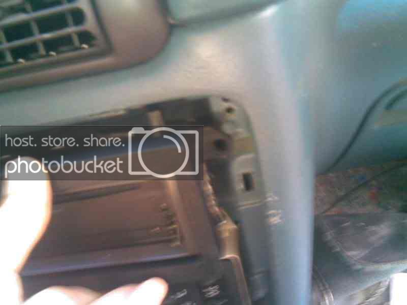

yo... im using the metra dash kit.. and its like not going in all the way like it sticks out.. theres ywo little black peices in the box it came in.. and my hu came with alot of little screws and 2 like "keys" i think they are called to get the metal casing off does this have anything to do with why its not going in? pllllzz help i cant find anything on the internet about this..

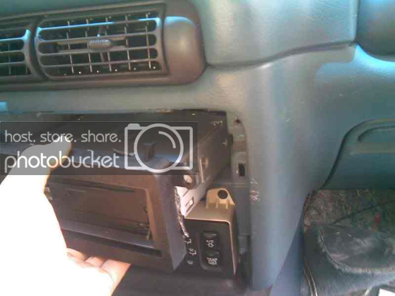

alright i took pics.. i dun understand wat u mean by backwards... but idk.. i mean i got all the wires tucked back there.
your HU might bee to deep for it to fit. certain vehicles can only accomadate (xxx") of HU length. so your HU could be to long, take a tape measure and mesaure from when the begginning of the opening is back to the farthest the HU can go. but measure it in the middle. then measure the length of your HU and see how the lengths match up.
